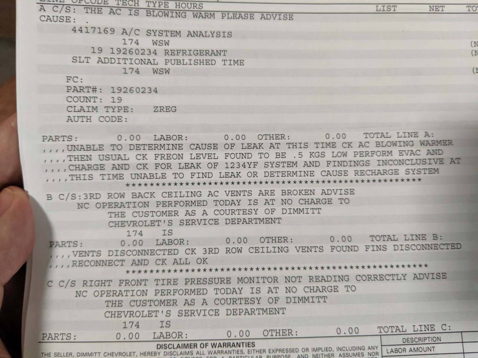

FOUND IT! So Dimmitt serviced it TWICE, before I went to GMC. Service ticket from 6/8/18 reads " UNABLE TO DETERMINE CAUSE OF LEAK AT THIS TIME, CK AC BLOWING WARMER THAN USUAL CK FREON LEVEL TO BE .5 KGS LOW PERFORM EVACAND CHARGE AND CK FOR LEAKOF 1234YF SYSTEM AND FINDINGS INCONCLUSIVE AT CHARGE AT THIS TIME UNABLE TO FIND LEAK CAUSE RECHARGE SYSTEM"
Then on 9/6/18, I went back to get washers fixed, still no parts, so I left and took it to GMC for washers. On 11/8/18, GMC fixed washers, AC was not noticeably warm, as Florida isn't that hot in November.
On 3/21/19, AC was warm so I took it to GMC dealer, who told me DIMMITT had "no record of servicing the AC". So either Dimmitt lied to GMC, or GMC never checked, anyway I look at it, someone is owing me my $1675.
Should I play nice with Dimmitt then crank it up a notch if needed? Or is GMC my first call, for failing to warranty Dimmitt's work?
GMC dealer seems to have their act together, so I'm thinking Dimmitt either lied or is just incompetant and didn't look into my service records when GMC dealer called them.
(sorry for the confusion on dates, at least now I have a clear picture of how it all went down)
Pic attached of Dimmitt AC service on 6/18/18

Let us know if you figure it out. I don't think there are 2 separate condensers but it wouldn't be the first time I was wrong.
You are correct, it was rear evaporator, not condenser. I just found all my service records and updated on 4th page of this thread.
Pic attached of Dimmitt AC service on 6/18/18View attachment 223353
I would go straight to GM Customer Service / Corporate No middle man and get this thing fixed... Good Luck

If the GMC dealer is responsive, ..go to them. ANY GM dealer can cover warranty & correct past screw ups. They may even give you a contact at corporate.
Heck... warranty is fully paid by GM, if the dealer does the work.
You can also go to a certified mechanic if the closest dealer is unable to do the work correctly, & GM pays them! ( just ask around)
( You have Dimmwit by the balls.... They put in writing they filled Freon, knowing there was a leak)
