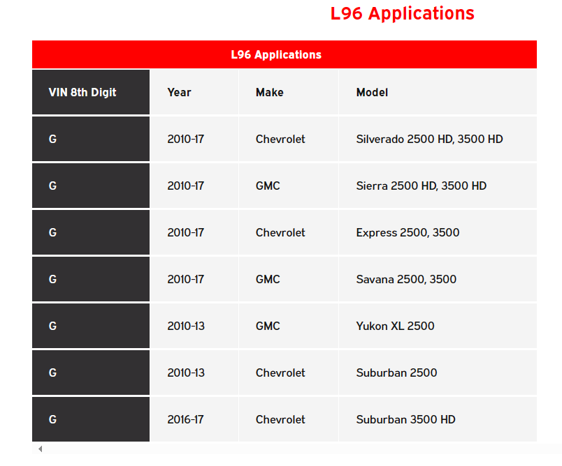

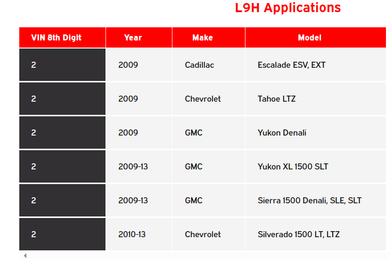

L96 6.0L Non-AFM, Iron block Alum head 360hp / 380tq 9.6-1 motor.
L94 is the 6.2L AFM 403hp motor.
L92 is the 07 & 08 6.2L Non-AFM 380hp motor. Trucks & Esky had 403hp approx 07-14.
L9H is the one year only 09 ... nevermind, I'll just paste the app chart below
