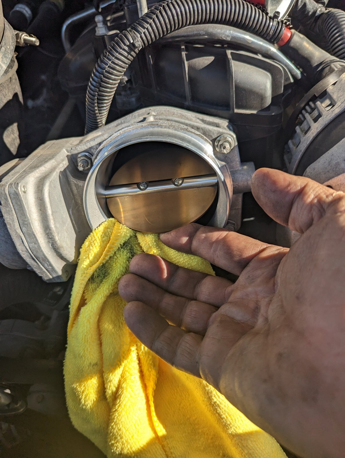

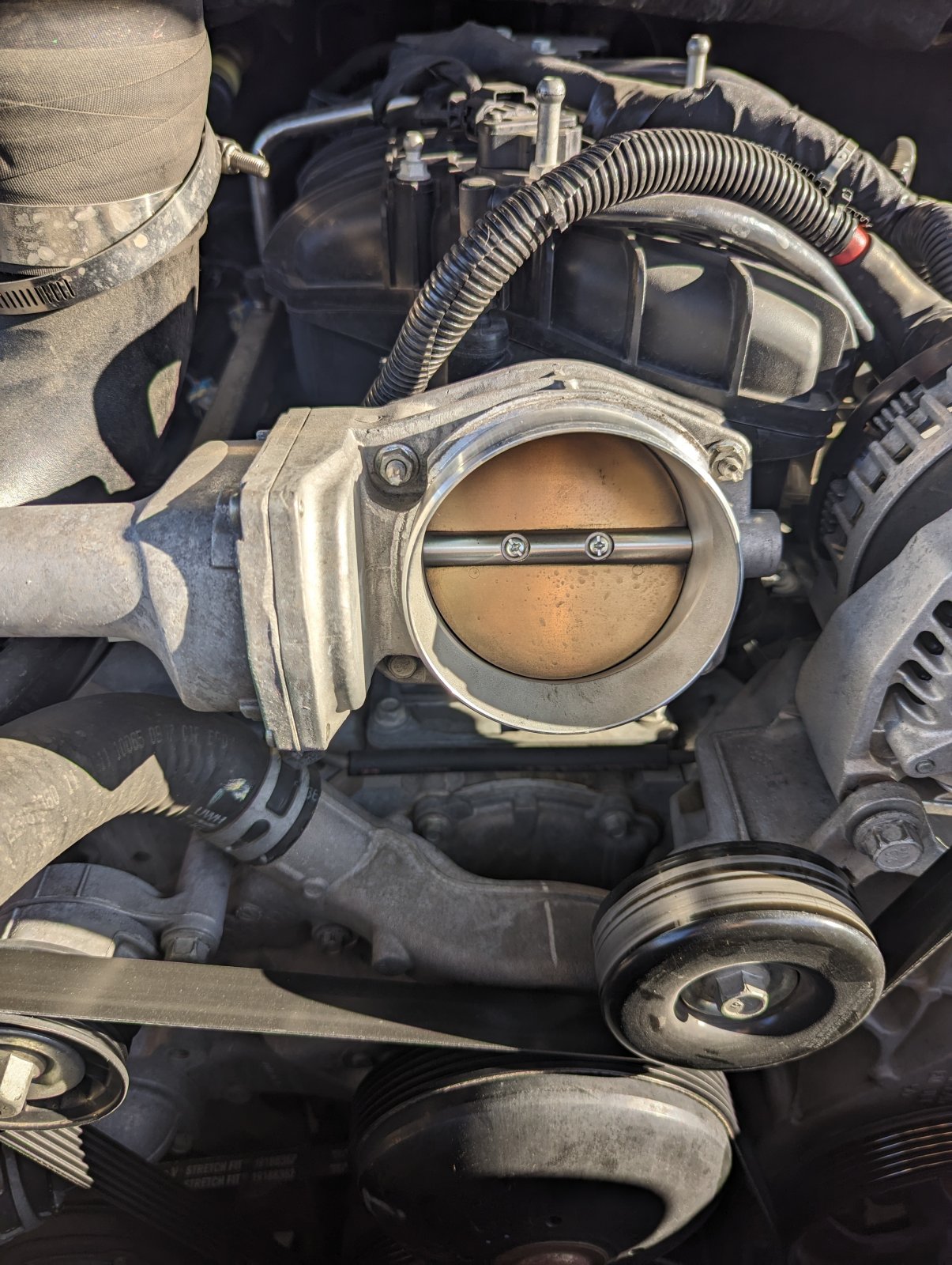

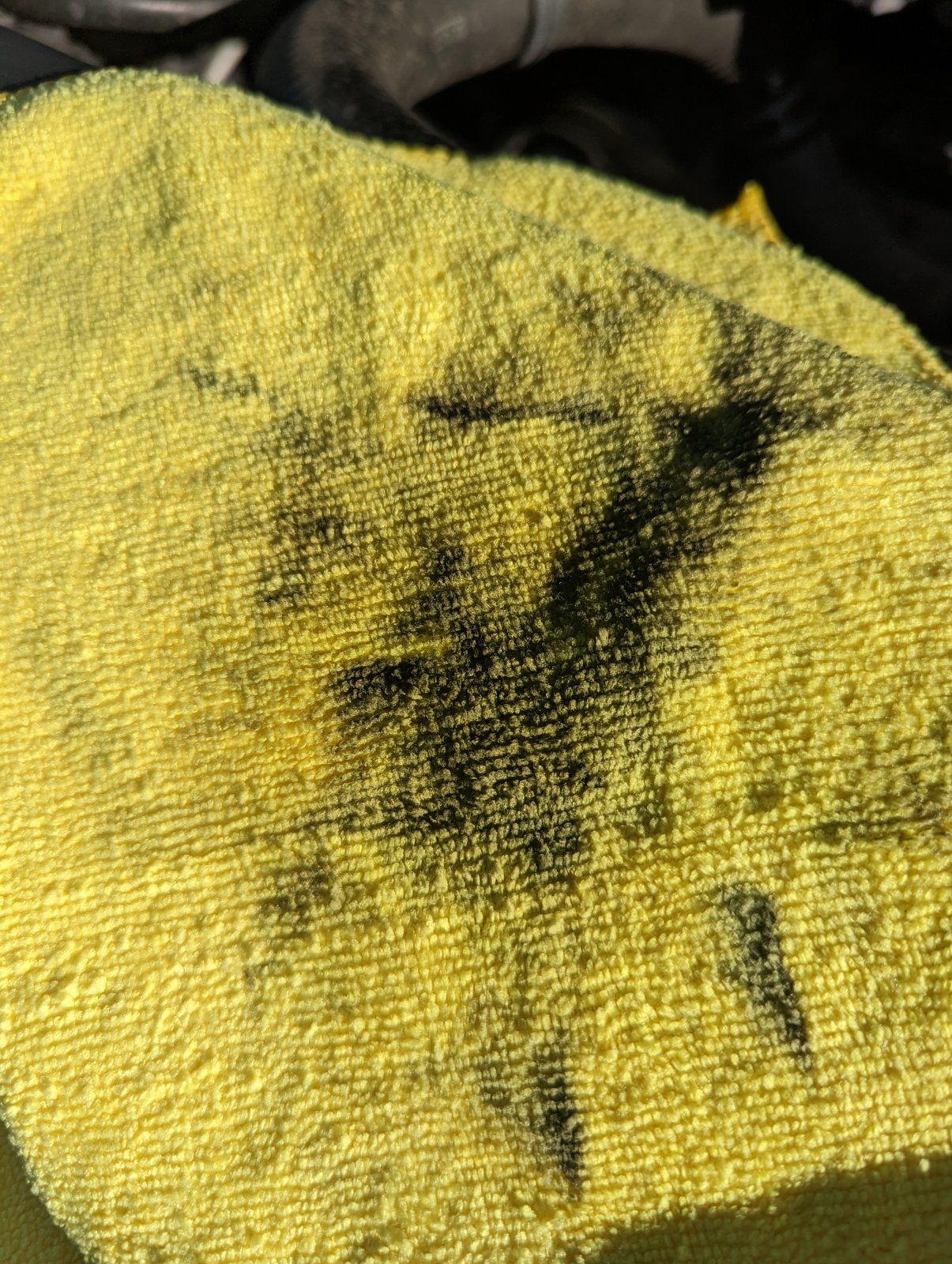

Cleaned mine today it's not even dirty a few smudges, I keep it clean though
