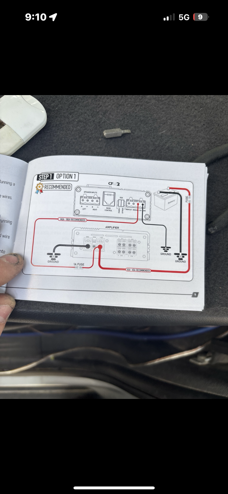

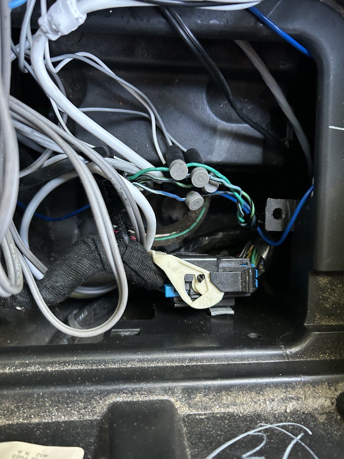

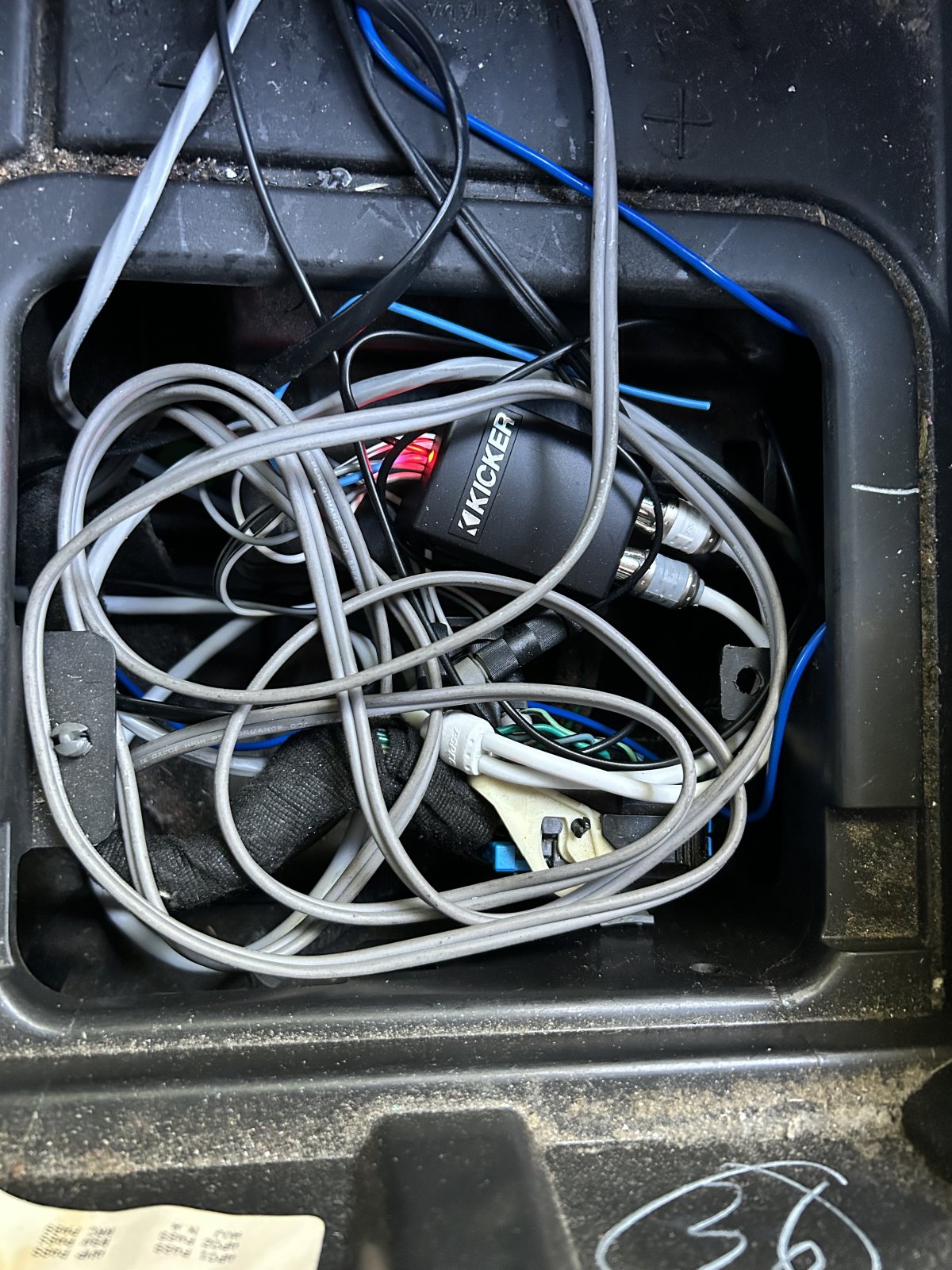

Last time I tapped the factory sub harness (the 16-pin one under the center console cup holders) straight high-level into the amp and it had that same choked/weak/rolled-off bass everyone warned about. This time I’m doing it the right way: tapping the same sub harness wires into the high-level inputs on the CT Sounds LC2i line converter (the CT brand bass restore version Doubeleive mentioned), then running clean RCAs from the LC2i into the new amp. Hoping the bass restoration finally cleans it up.
I’m in the middle of the install right now and have a couple quick questions for you guys who’ve done these 07-14 Tahoes:

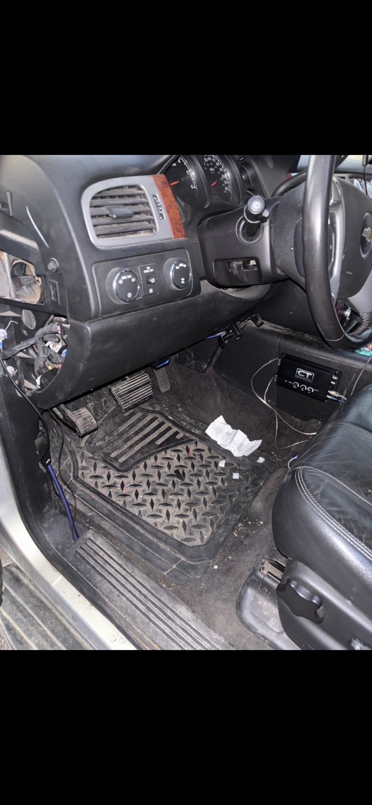

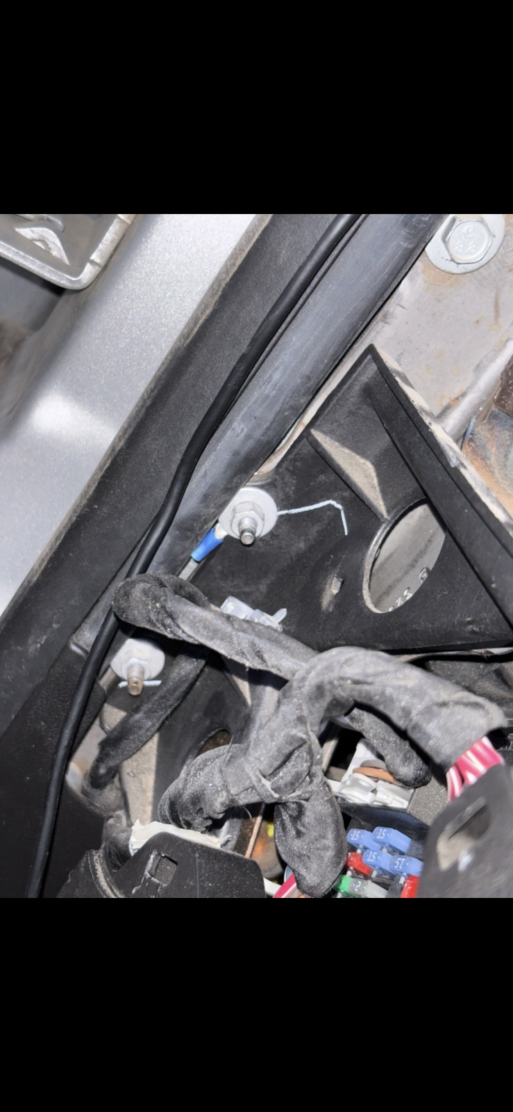

1. Ground — I’m using the factory chassis ground stud in the driver-side kick panel/fuse box area (silver bolt with the blue wire and white ring terminal). Is this a solid/reliable spot for the amp ground, or is there a better one up front that doesn’t involve drilling to the frame? I’m about to clean it up real good.
2. Remote turn-on — Best fuse to tap in the driver-side fuse box so the amp and subs turn off cleanly with the key (no drain)? I keep seeing the SEO/RAP fuse mentioned — still the go-to?

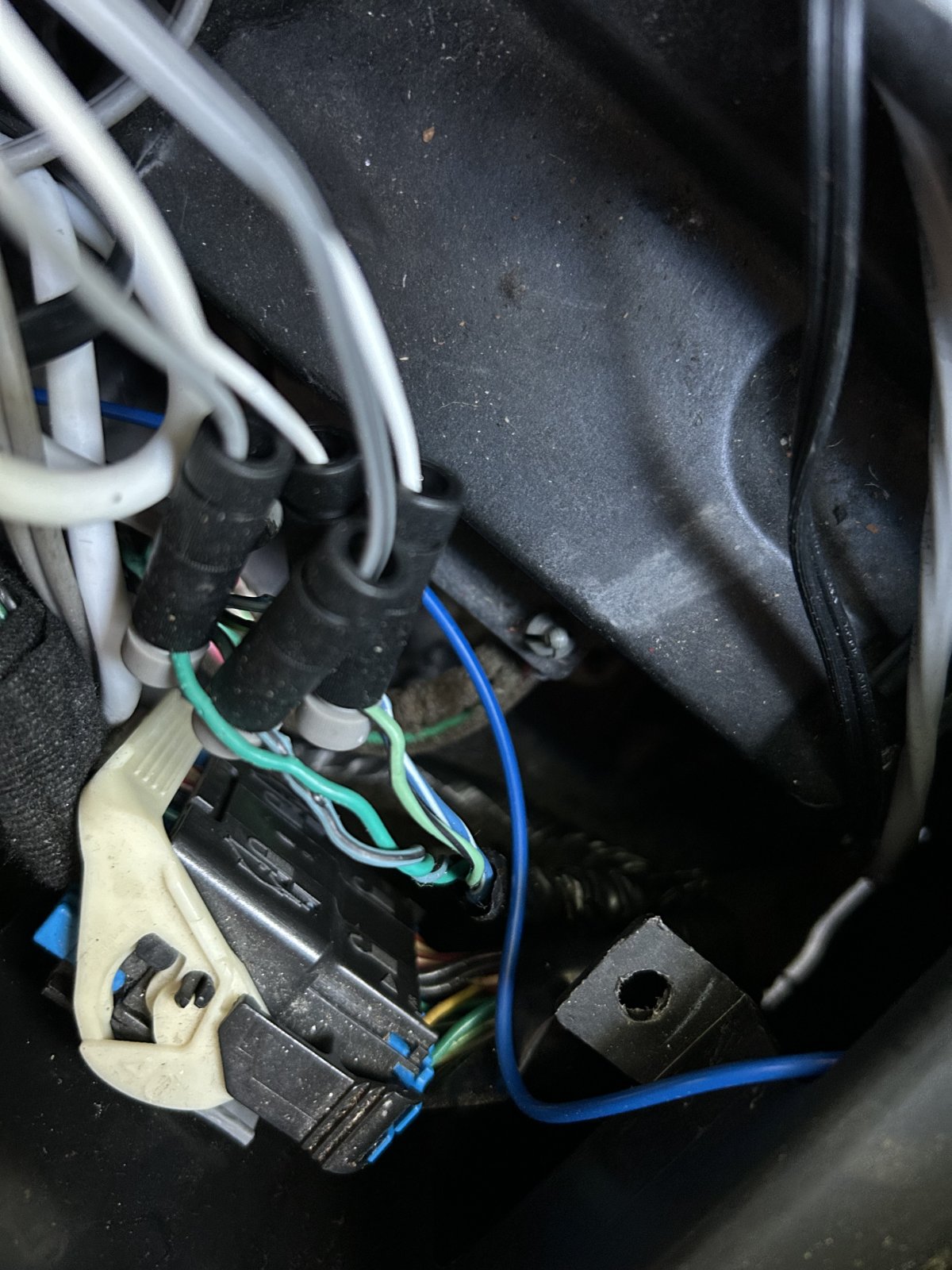

3. Sub harness wire colors — Can anyone confirm the exact + and – on these four wires I’m tapping for the LC2i?
• Dark Green
• Dark Blue with White stripe
• Light Blue with Black stripe
• Light Green with Black stripe
(I know + to + and – to – but want to be 100% before I cut.)
Pics of the ground stud and the sub harness attached if anyone wants to double-check.

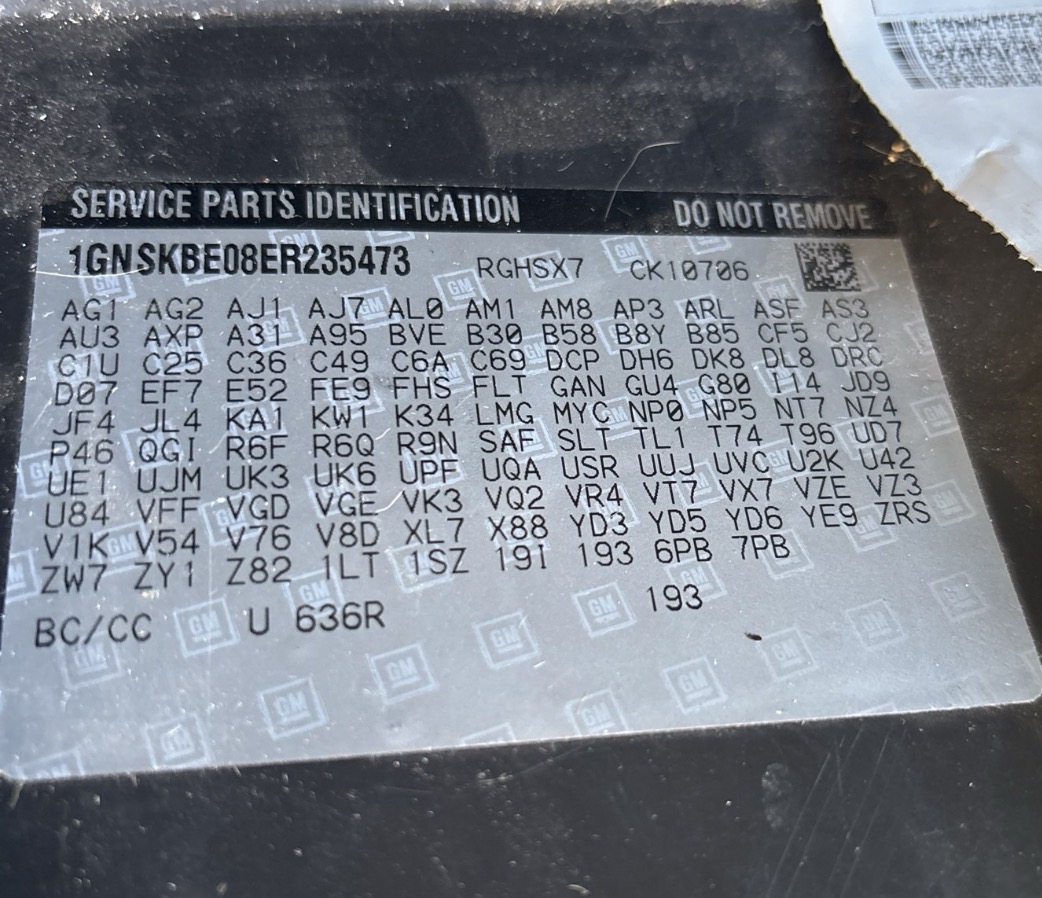

you can check the charm li manual, but you'll probably want to note the amp p/n or bose system number which will be in your rpo codes like UQA, UQS, Y91, UC6, UB0

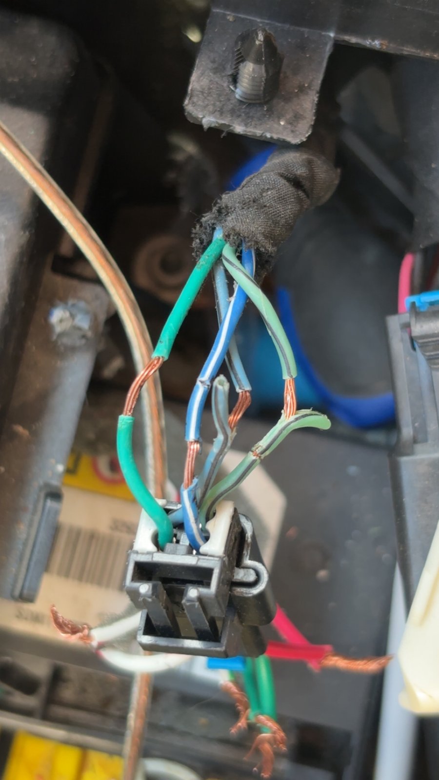

I’m not 100% sure on my exact RPO codes yet (will grab the glove box sticker on my lunch break around noon or sooner), but my truck is a non-touchscreen 2007-2014 Tahoe with the factory Bose system. I have the four wires on the sub harness under the center console:
• Dark Green
I’m tapping these into the high-level inputs on the CT Sounds LC2i (then RCA out to the new monoblock). Last time I went straight high-level to the amp and it was choked/rolled off like everyone described.
Any chance those colors line up with a common UQA/UQS setup on these trucks, or should I definitely pull the RPO codes first before I cut? I’ll post the codes as soon as I check.

Wire ColorSignal DescriptionPin Type
Dark GreenSubwoofer Signal (+)Positive
Dark Blue / WhiteSubwoofer Signal (–)Negative
Light Blue / BlackSubwoofer Signal (+)Positive (Alternate/Second Coil)
Light Green / BlackSubwoofer Signal (–)Negative (Alternate/Second Coil)
Thanks I’ve also been consulting with AI lol. Also here’s those codes?

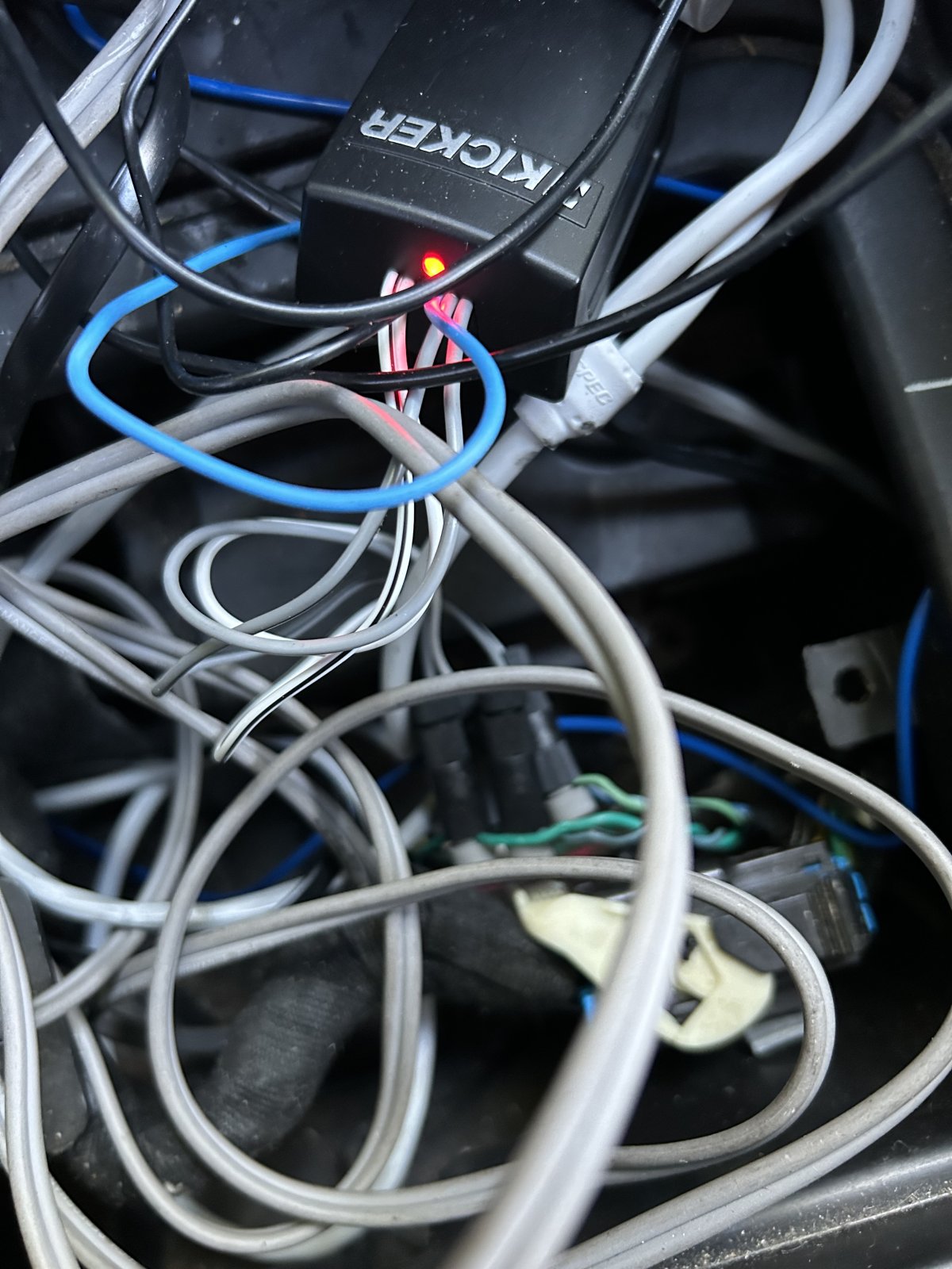

Quick update for everyone — especially Doubeleive, thanks again for the RPO code tip!
Confirmed UQA on the glovebox sticker. Tapped all four factory sub harness wires into the CT Sounds LC2 high-level inputs, ran fresh speaker wire, solid ground on the driver seat bolt, and power/ground is done.
Houston, we have bass.
Fired it up and it’s already slamming way harder and cleaner than my old straight high-level setup ever did. The LC2 BassLift is working great — barely even touched the knobs and it thumps. I haven’t messed with the amp too much yet (still at work), but I turned the LPF up a bit and bumped the gain just a hair. Overall it sounds pretty damn good, but the higher bass notes (kick drums and stuff in the 45-70 Hz range) are still coming through a little weak compared to the really low end. Planning to dial in the subsonic and fine-tune the rest when I get home.
Only thing left is the remote turn-on wire so the amp + LC2 shut off cleanly with the key (right now it’s on constant 12V). Is fuse #8 (SEO / RAP) in the driver-side dash fuse box still the go-to for these 07-14 UQA Tahoes? Any tips on the best add-a-circuit setup?

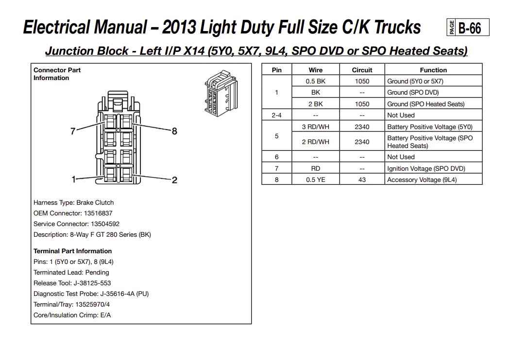

should be a yellow wire on connector x14 (mbec) pin 8 maybe, apparently it can vary based on the vehicle model. the rap is controlled by a relay, the wire is low power for trigger-on use only. be careful because you can mess up the vehicle lan buss if you connect to the wrong wire
I tested the AUX PWR fuses (#2 and #16) and they’re both constant-hot (even with door closed and key out). My dash cam stays on them too.
Would it be safer/easier to just tap the accessory wire at the factory radio harness instead of hunting for the yellow wire on X14 pin 8? Or is X14 still the cleaner way?
I’m trying to keep everything stock-looking and not mess with the LAN bus like you warned. Any quick confirmation on which wire/color at the radio is the switched accessory one on a non-touchscreen UQA setup?

you should be able to tap the wire in the mbec mid buss electrical panel, it's the panel that has a black plastic cover on it to the left of the brake pedal sort of on the firewall

The MBEC has been mentioned several times now in this thread and your others. It has connections for exactly this purpose.

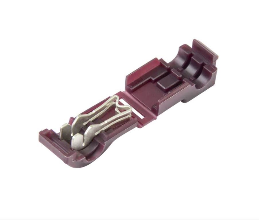

Pin 8 on X14? So I can just take a self adjusting wire stripper and open a section up? Or what’s the best way to tap that? Wire T taps have been unreliable for me in the past. Also don’t wanna sever any wire

I usually use one of these female blade power tap's (depending on the wire thickness), that allows you to insert a male blade connector.
View attachment 485266View attachment 485267
Ok those are safe to use on that harness? Those are the ones I have had troubles with in the past. I think it was cause I was using the wrong size though maybe. What size wire is it do you know by chance from when you did it?
