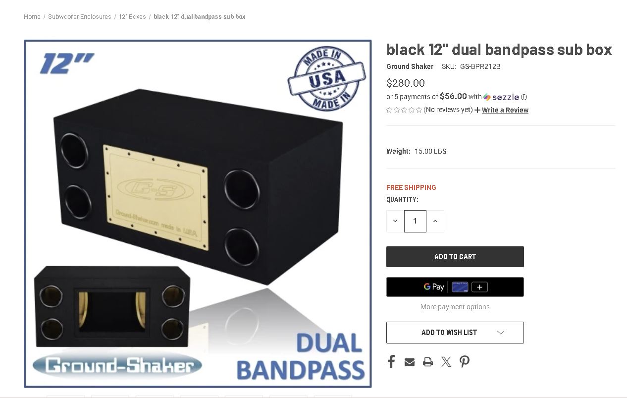

a bandpass design just like this with slightly smaller port holes will sound really good, but they are not popular (at all) and it is hard to find a well made one unless you have a cabinet maker build you one and even then how long it last's is questionable which is probably why they are not popular. you will see a couple super cheap ones out there, don't bite they will just fall apart. this one I don't know it say's it is mdf, it might last a few years. it's $300 all over (without speakers).

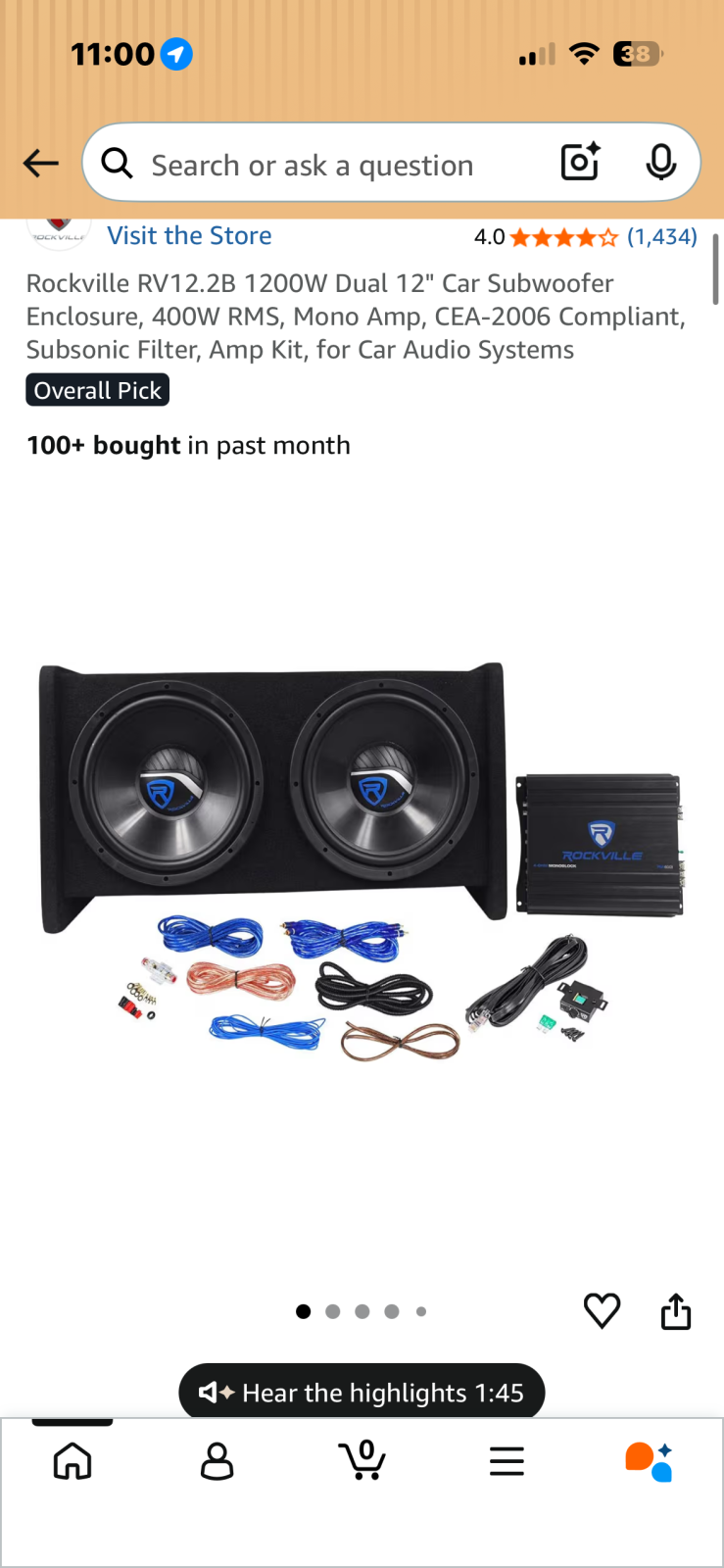

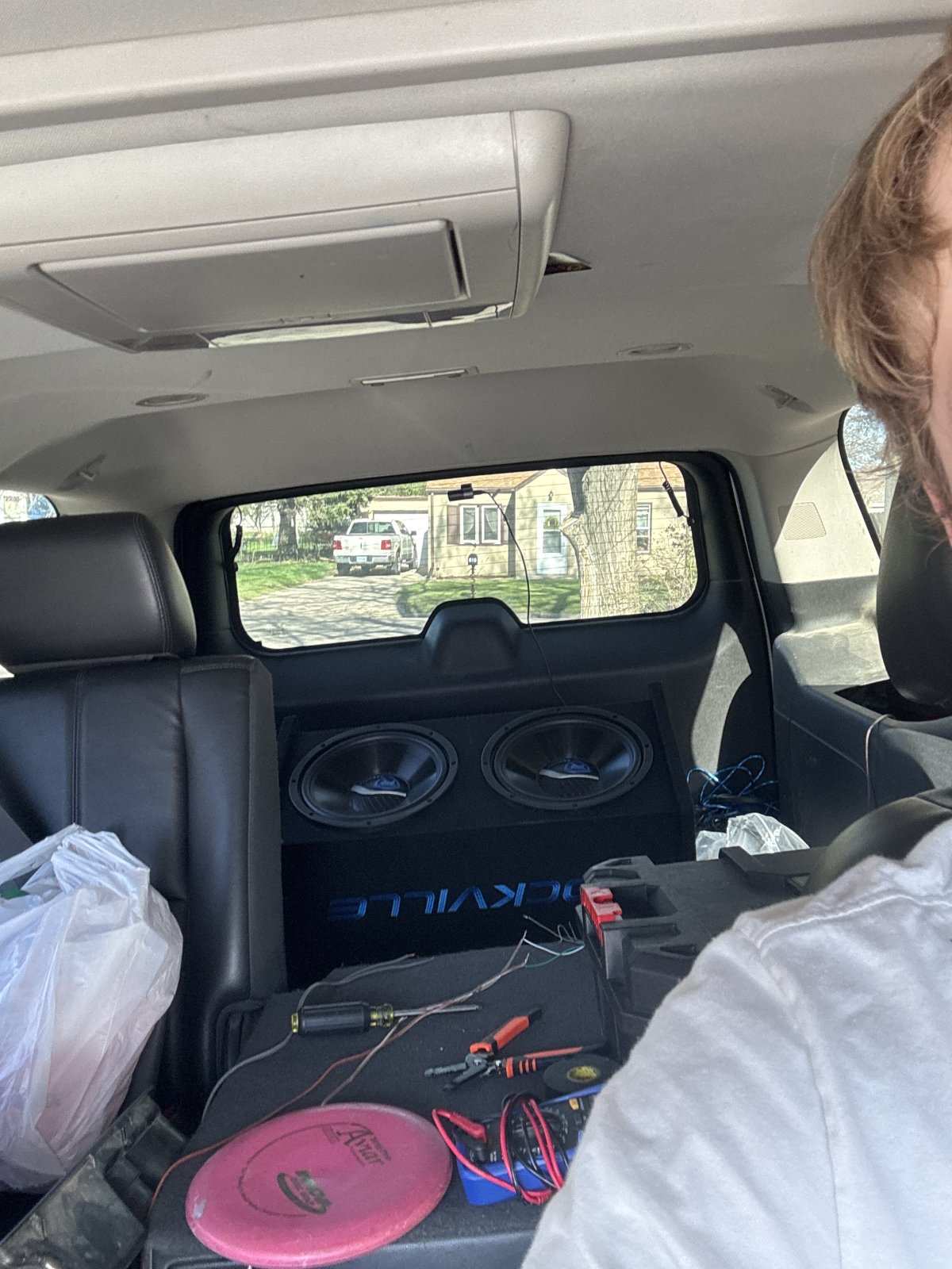

Hey guys, quick update.
I took the Rockville setup to Sound Decisions here in Aberdeen today. After they listened and looked at it, they said one of the voice coils is starting to fail and the box is flexing pretty bad at the seams (you can feel the panels vibrating).
I’m pretty let down honestly. I’ve spent a ton of time trying to get this thing to sound right and it just isn’t working out. I’m gonna go ahead and return the Rockville stuff.
The shop offered to finance a Memphis dual 12” package for around $400. Memphis is a solid brand so I’m thinking about pulling the trigger on that instead.
Appreciate all the help and suggestions y’all gave me. Learned a lot even if it didn’t work out.

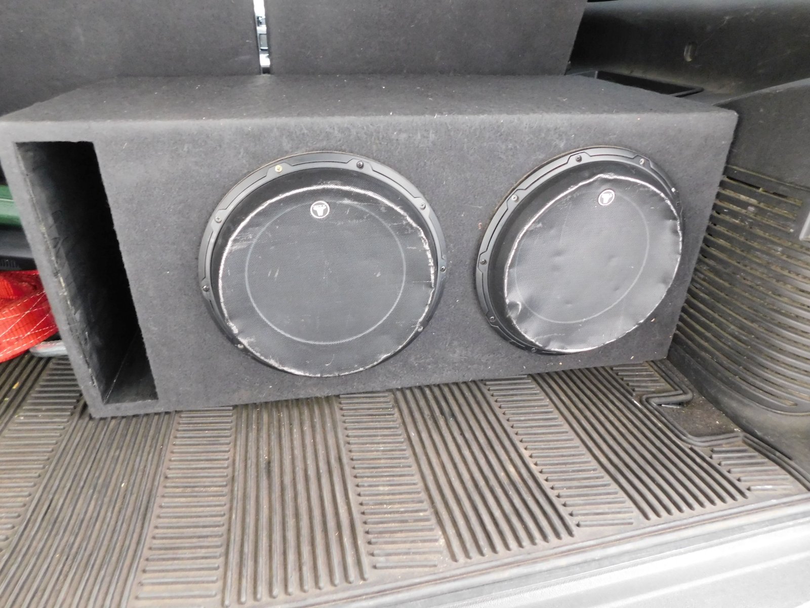

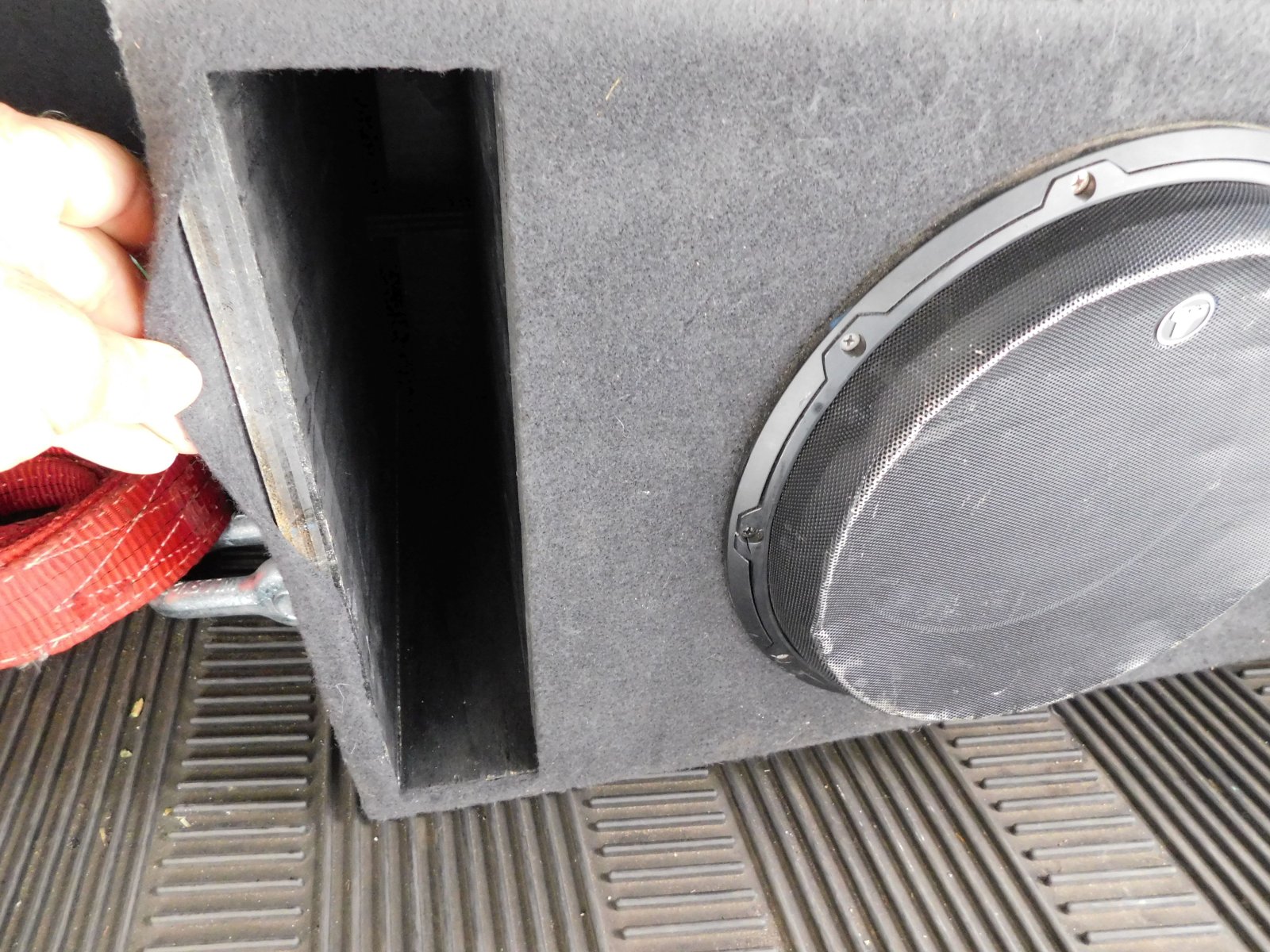

not a wedge right? got a picture of the box?

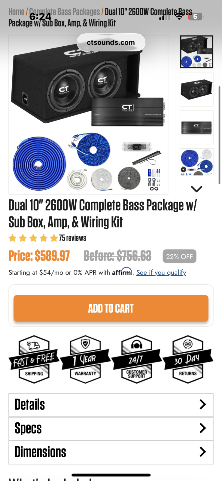

Ended up pulling the trigger on the CT Sounds TROPO single 12” complete package — sub, amp, and wiring kit. 650W RMS, quality brand, within budget. Going the DIY route since I already have power and ground run in the truck. But to be honest, I’ll probably just gut all that Rockville wiring and put the CT wiring in

I meant the memphis...
that single will probably sound better than the rockville ever did or would
Oh. Got ya. Not a wedge it’s just a big rectangular box. With two ports either on the outside or the middle of the front. Wasn’t able to grab a picture of the box. Regardless $700 for installation, the subwoofer package, amp, and LOC, and wiring kit. Is WAY above my budget. (For the Memphis dual 12s)
