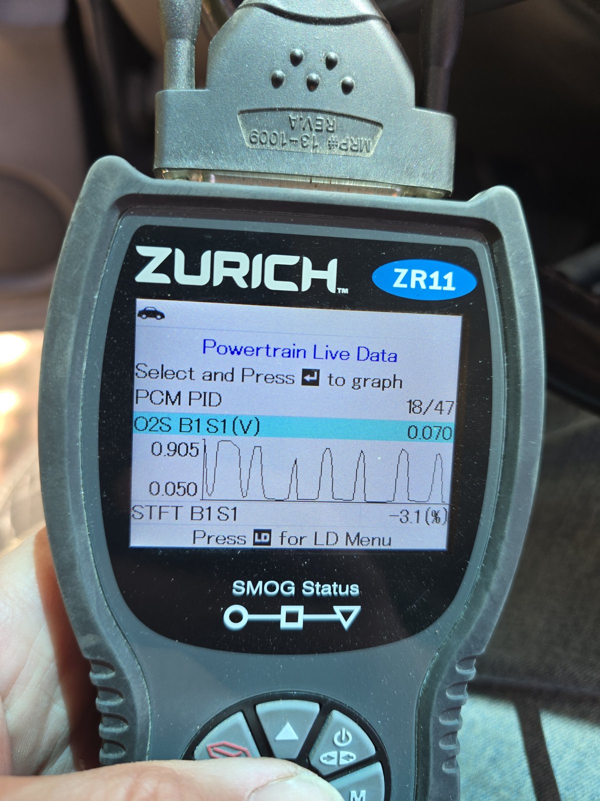

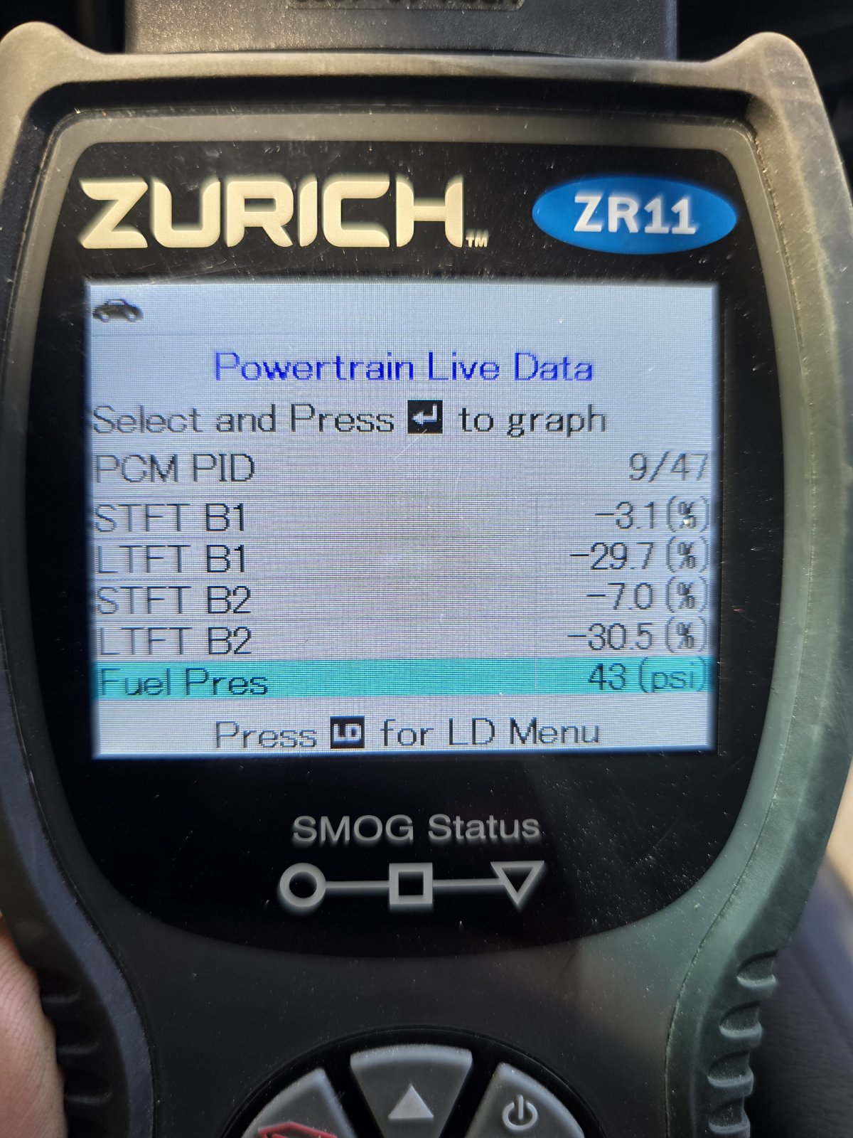

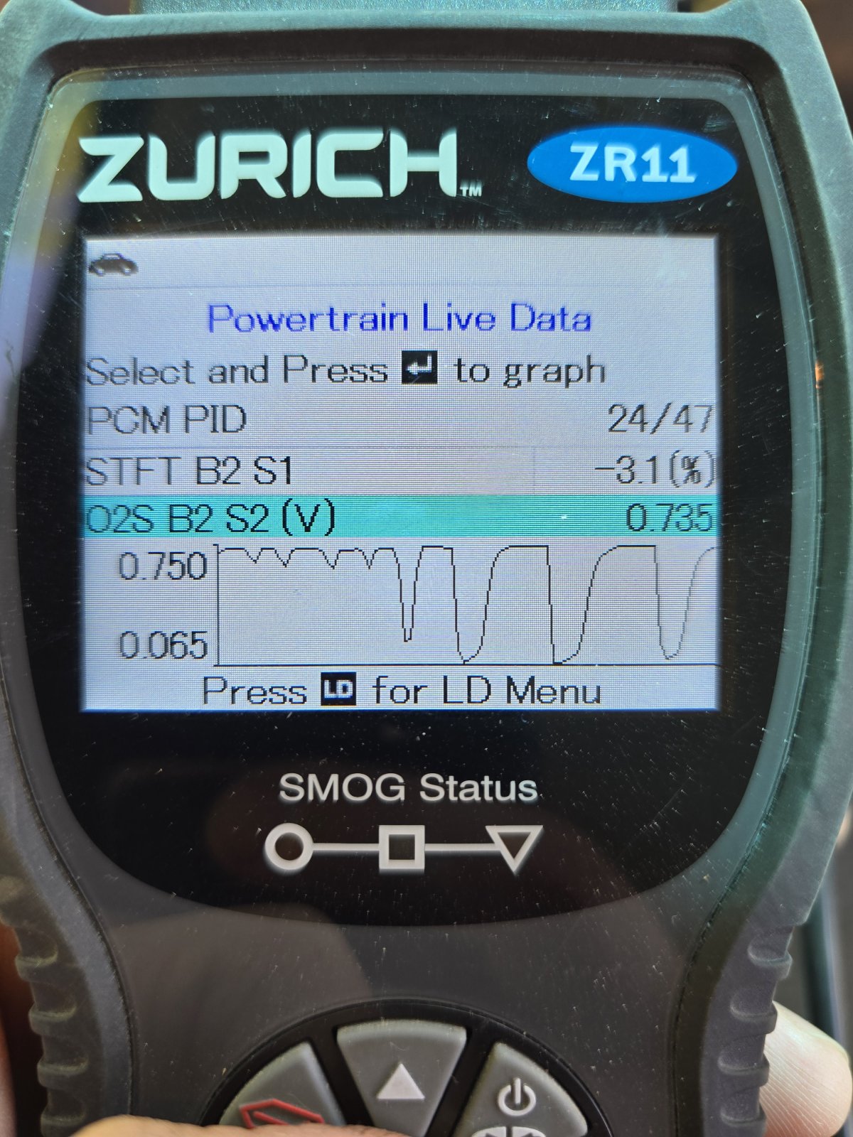

I have a 2013 tahoe, 5.3 flex fuel, 134k miles. I have a issue where when I start it stumbles but not enough to die. It will smooth out and run fine after that. It does it when its cold or has sat for a bit. There are no issues after it. It runs fine, strong, has power. No hesitations or shaking and I average 16-17mpg.
I am dealing with a P0446, P0172, P0175 and P015D codes. I have a basic Zurich ZR11 scanner that can view live data and graphs. Alcholol percentage is at 80% however I do not have a scanner than can reset it.
I replaced my charcoal canister and purge canister hoping to fix the 446 code. I have run B12 cleaner through the tank. Cleaned the maf and throttle body.
Attached are some pictueres from my scanner hoping to help diagnose my issues without being a parts cannon.

Long-term fuel trims indicate very rich condition on both banks. Measure the fuel pressure on the rail, key on, engine off.

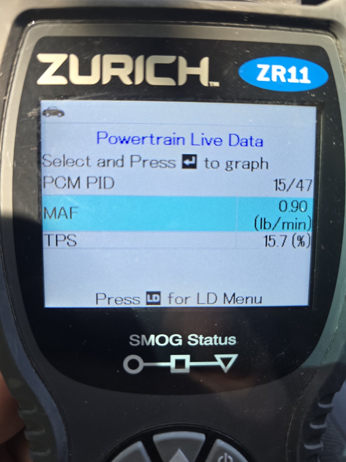

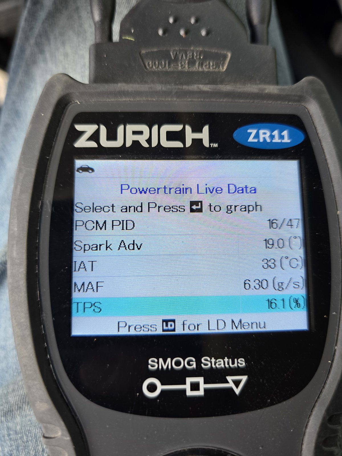

At hot idle, what does the MAF report in g/sec (not in lbs/min, please). It should be somewhat close to the engine displacement in liters.

At hot idle this is my MAF. I will get a fuel pressure tester tomm and check it at the rail. I try to run e10/15. I got into some Jumpstart 93 that apparently can have up to 30%....wont be using that anymore.
