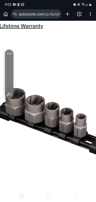

I ordered a nut extractor socket set from amazon.. I'll try it on the stripped one
The other one I guess I'll soak it some more and try heat as well... again and
hope for the best

So I need some help...
I've got one 15 mm nut that won't come off on each side...
and the pass side nut is now somewhat stripped
This is sooo annoying.. Just to do a trans service
So stripped not spinning on the stud?
1 on pass side is getting rounded off.
The 1 on the drivers side is fine still... it just won't budge
And that's the type of sockets I ordered ... I made sure it had 15MM size
