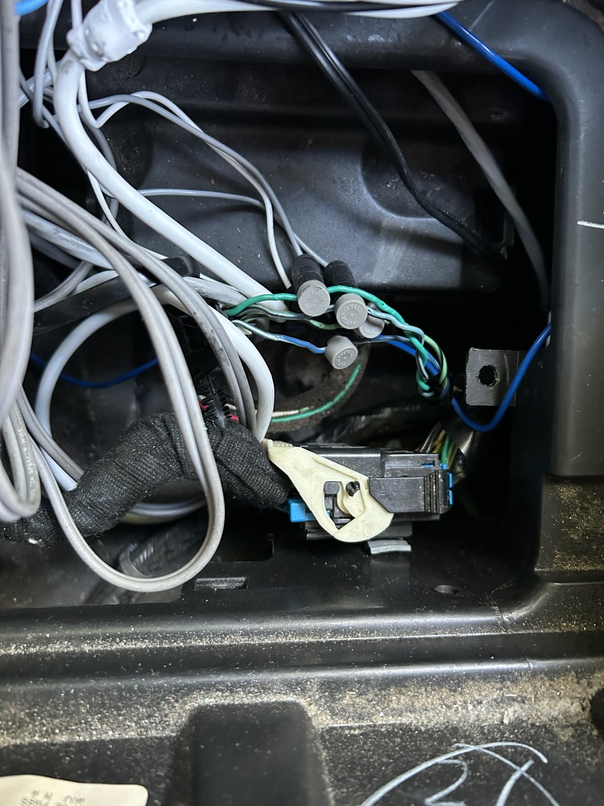

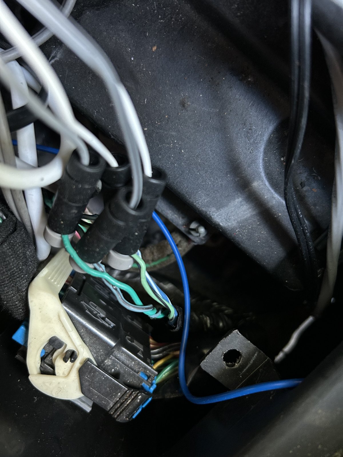

I am running JL Audio CP210-W0v3 off a AudioControl EPIC750 amp tapped into the sub harness under the cup holders with a regular line converter.
I keep a roll of TP in the cup holder tray and that wedge sub will make it walk and dance around. It hits HARD.

So u tapped the 16 pin harness ? What wires exactly ?

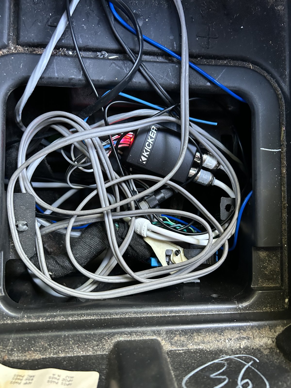

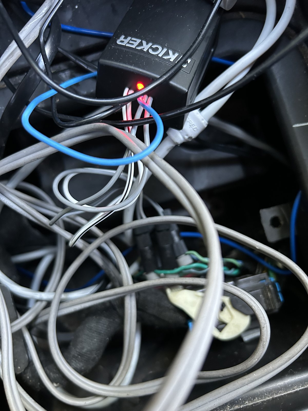

Update: Got the new Rockville RV12.2B dual 12s and separate amp. Power, ground, remote wire all good — green light comes on clean with just those three connected. As soon as I plug in the RCA cables from my LOC it throws into protect mode. Disconnected everything from the LOC, still happens. Thinking the LOC might be sending DC voltage through the RCA outputs and triggering protect.

I'm sorry I ddn;t get pics yet, I'll post it up in an hour when I get out of work.
Did you tap into the input side of the factory sub correct?
I haven’t even done that yet. I’m still trying to get everything to work off of the door speakers because the old slim powered sub. Same brand worked fine with this set up. I don’t know why it wouldn’t work with this one.
