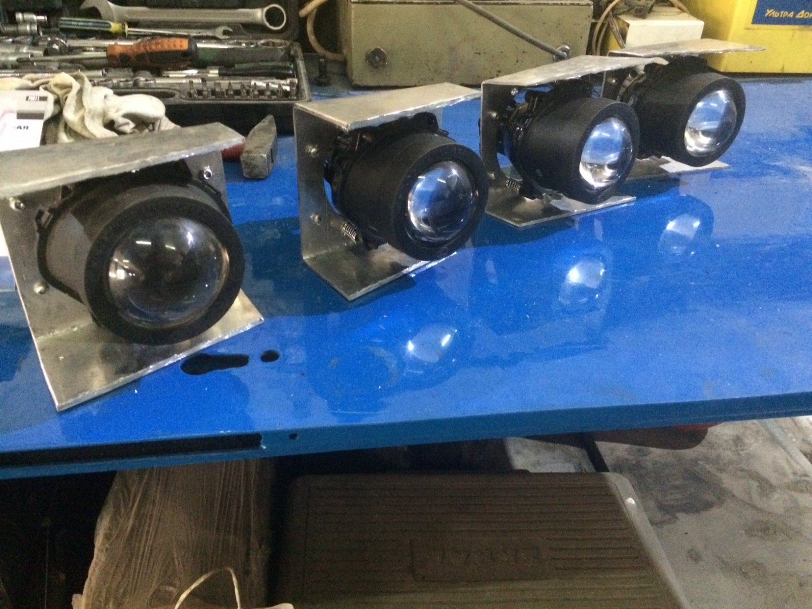

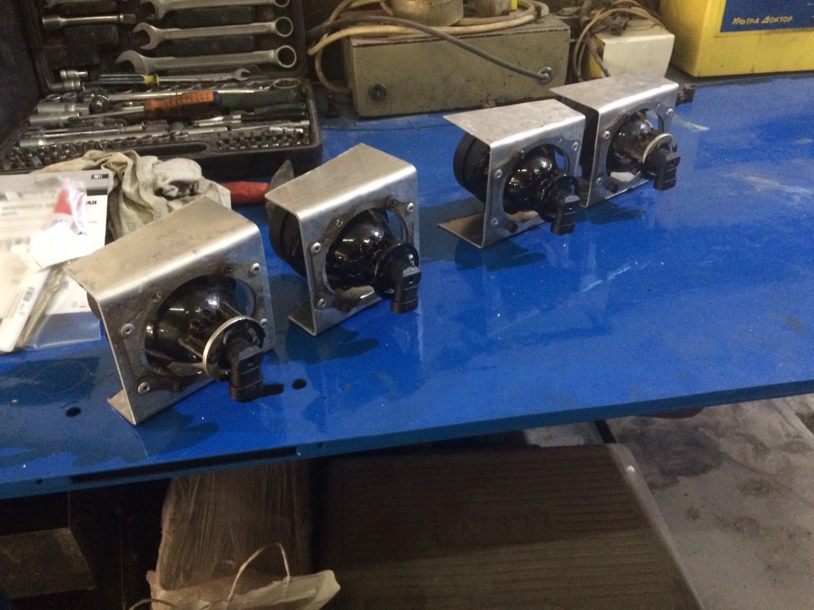

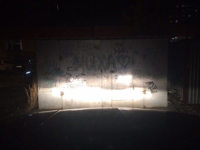

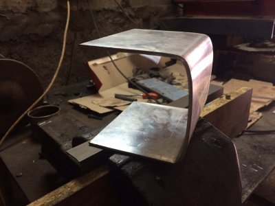

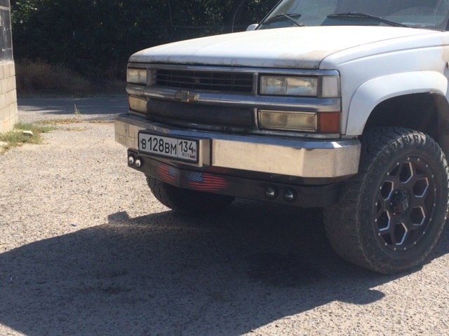

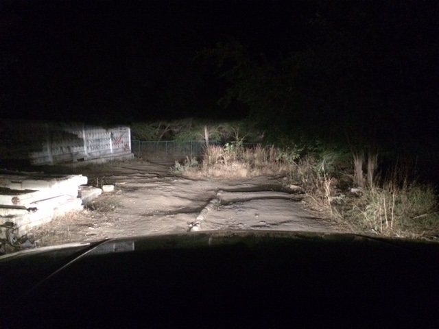

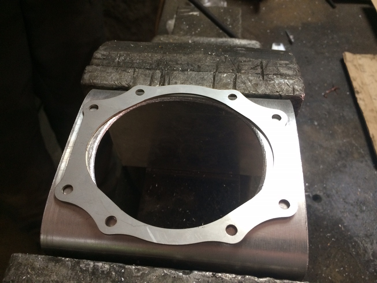

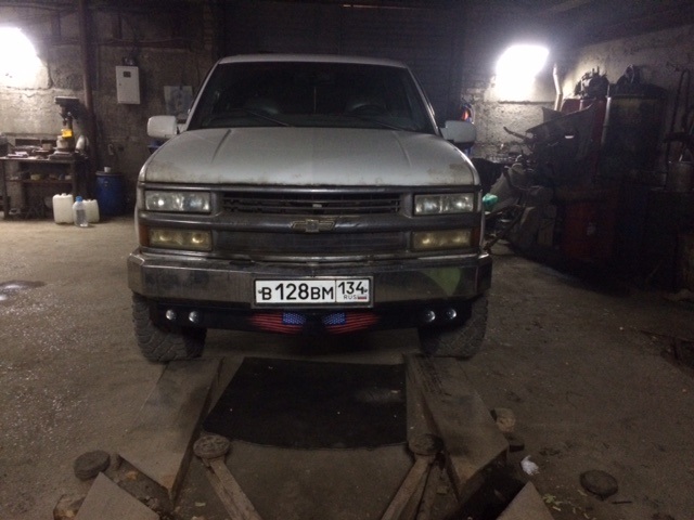

Hello!
Native headlights have never been of good quality.
Moreover, a paraffin candle under the windshield gives more light).
With only 1% of intercity roads illuminated, this is a very sad fact.
Headlight modules (lenses) "Hella" in the bumper lip.
Middle - https://www.allhella.ru/catalog/mod...60mm-blizhniy-svet-modul-s-krepezhnoy-ramkoy/
Anti-fog - https://www.allhella.ru/catalog/mod...ivotumannogo-sveta-modul-s-krepezhnoy-ramkoy/

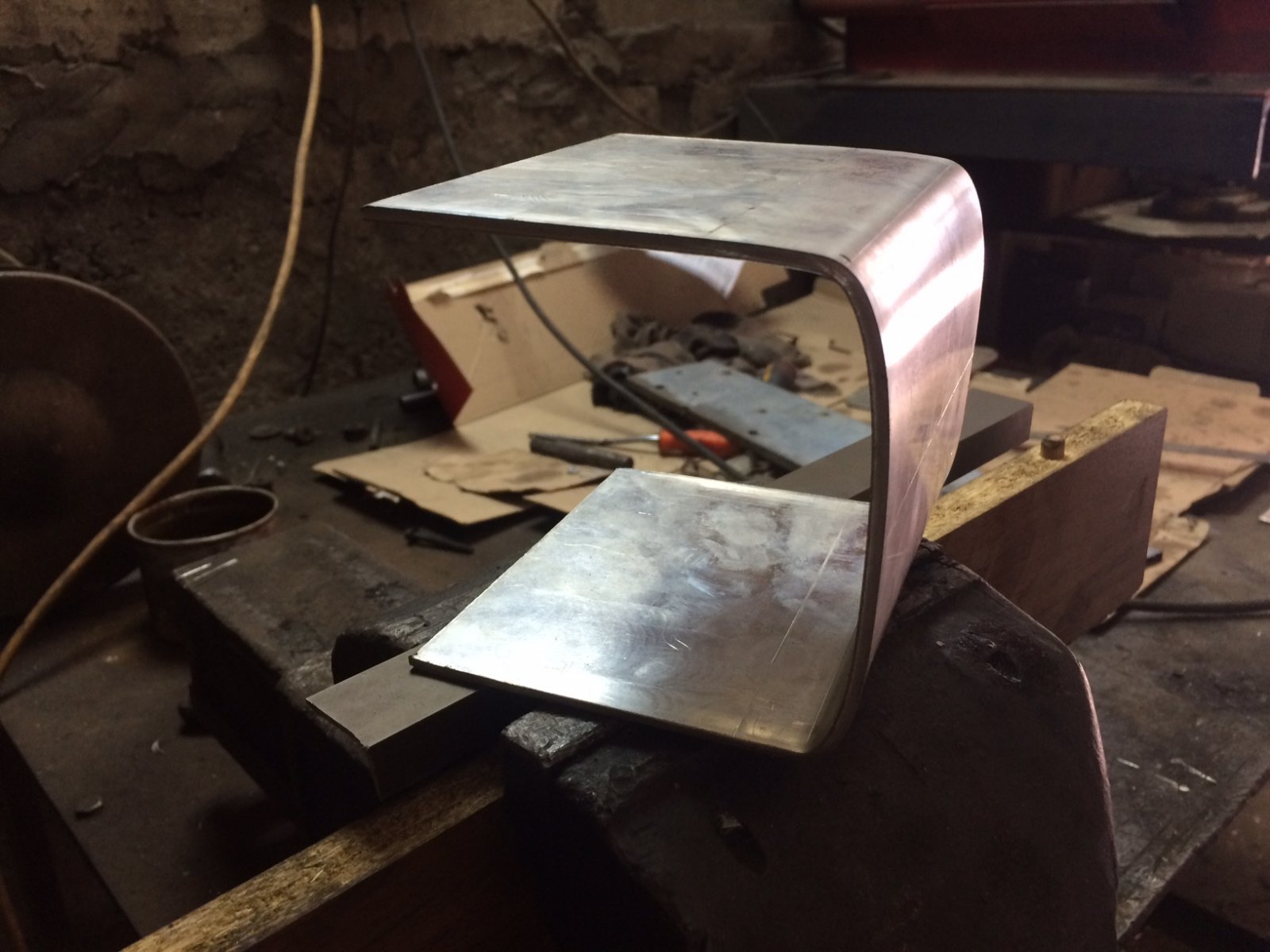

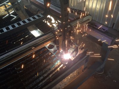

Using a plasma cutter, I formed four holes of 83 mm.
The stainless lip was designed in the style of the place of origin of the Car).
I inserted the lenses into the brackets and inserted the brackets into the lip.
Now, the light is quite good.
It remains to adjust correctly.
In the penultimate photo above the light from "Hella" there are two ridiculous spots from native headlights .....
Is the comparison inappropriate? ...)

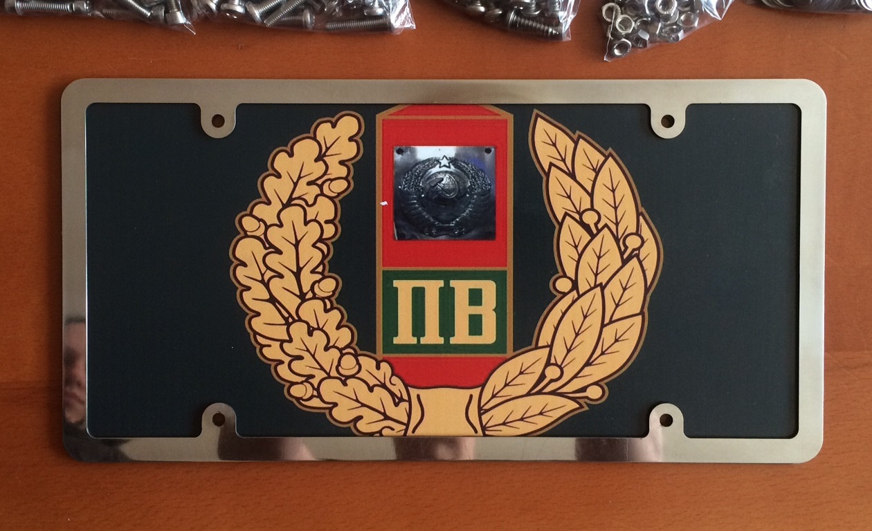

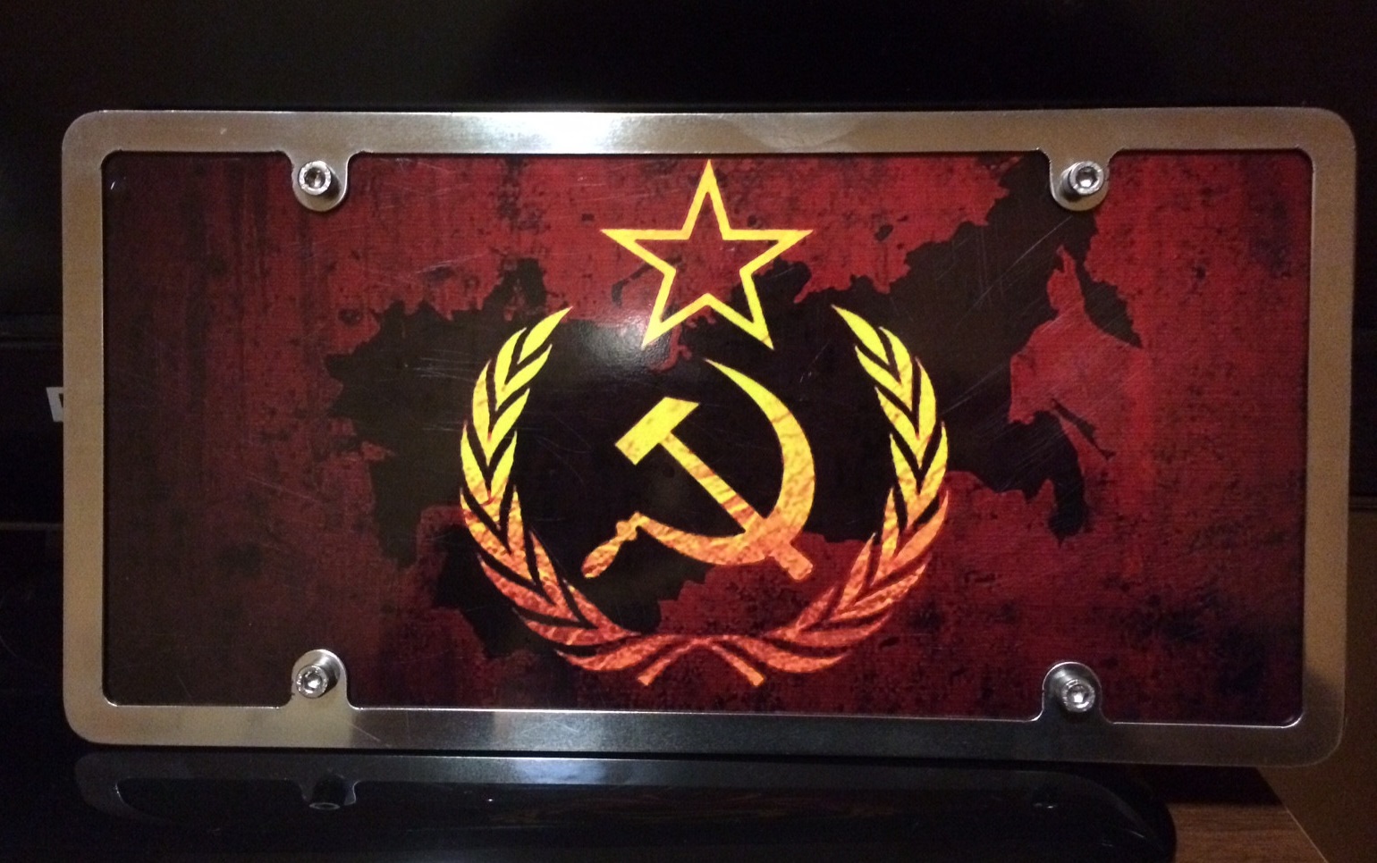

Love the flags!! [emoji631][emoji631][emoji631][emoji631]

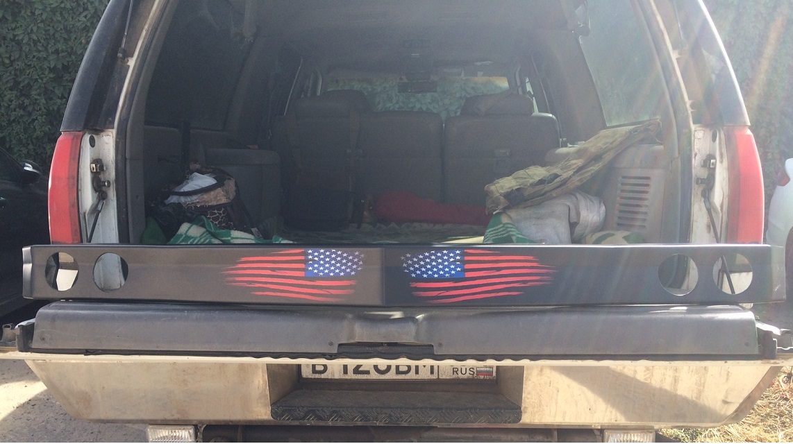

Yes!
If they are directly related to the topic.
In my handicraft collection there are several themed flags or symbolic pictures in stainless frames, stylized in the format of American numbers
For example:
"Confederate" for me represents Tradition and Protest.
"Crimson Union" is my Great Motherland.
And the third is the symbol of the troops where I served my military service.
I apologize for the distraction.
