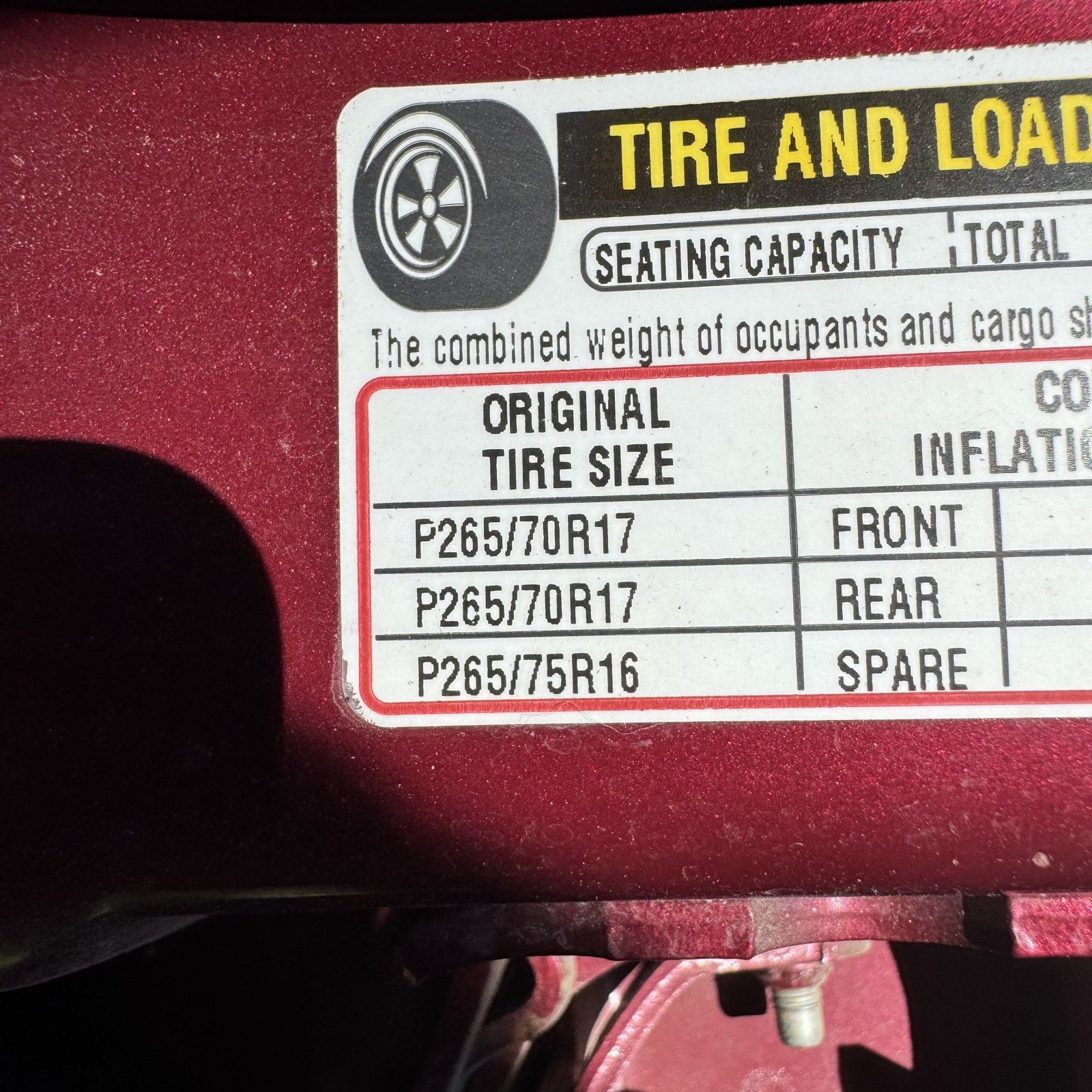

Since you called me Marky, I doublechecked your driver's door sticker here
and to my surprise, the sticker and your VIN's RPOs seem to agree.
Your vehicle was issued 4 265/70R17 tires; the 5th tire would need to be 265/75R16, to be of equal rolling circumference (31.6" diameter).
Your vehicle was issued 1 265/70R16 tire; the other four would need to be 265/65R17, to be of equal rolling circumference (30.6" diameter).
Either way, GM done did you wrong, @ueww40. Statute of limitations, among other things, means GM gets away with saying something like:
"Since it's a 2WD, and GM never gave it any G80 to begin with (click the link, no G80 RPO to be found, meaning it has NO Gov-Lock),
so there was no harm to come to the vehicle when we pinched pennies by providing a spare tire 1" shorter than the other 4 tires."

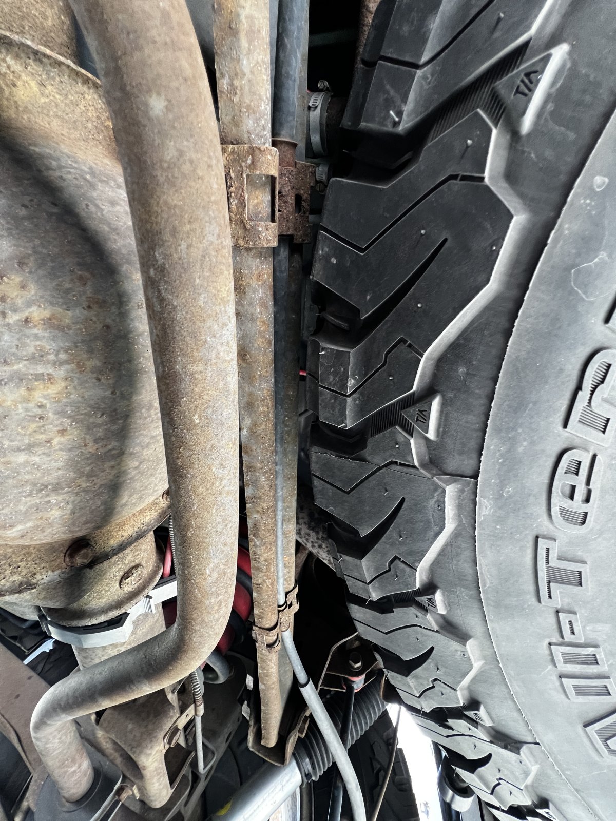

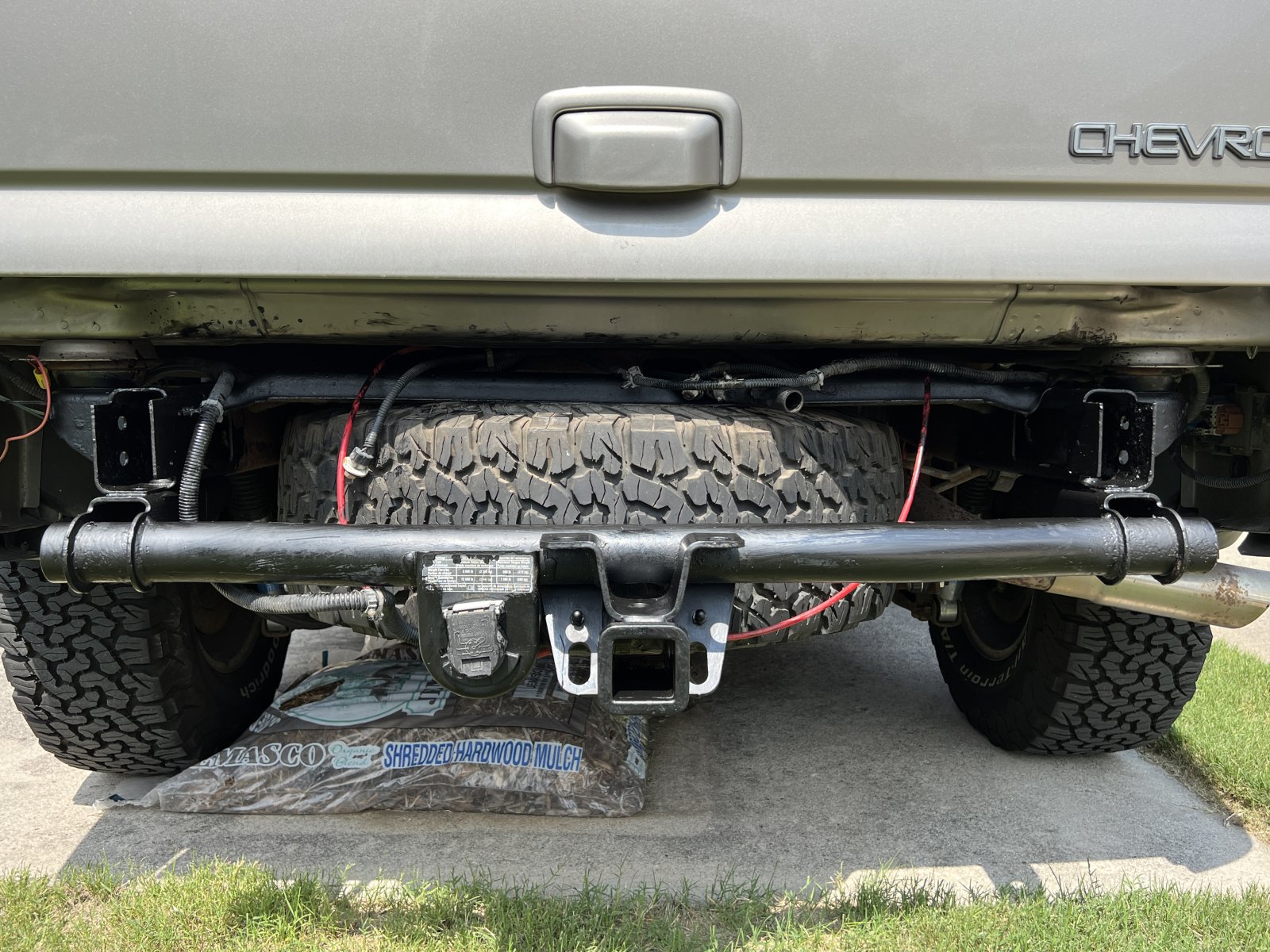

Running 285/70R17 on 03 Z71.
Bought an EBay special OEM junk rim and mounted a take off tire from when I needed to replace its match due to multiple punctures (another story).
The 285/70R17 fits underneath, but it is tight and really close to the track bar and Gibson CatBack exhaust.
Spare w/ rear bumper removed

Running 285/70R17 on '03 Z71.

Since yours is a 4WD, all 5 tires must be the same radius/diameter/circumference.
@ueww40's is 2WD, so GM clearly pinched pennies with that vehicle.

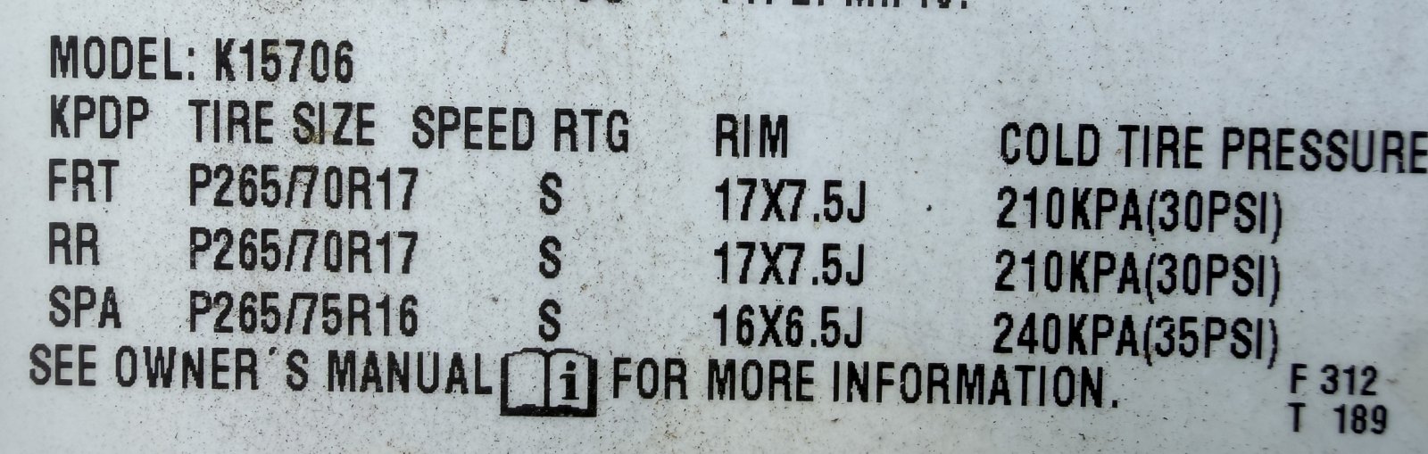

Confusion at its best. I call up tire places to shop for tires for my 2004 Tahoe. They all say that the tires for my Tahoe need to be 265/70R16. I look what's on the car now and they are 265/70R17. I look at the label on the driver side door and it gets even weirder. It says that the correct tire is 265/70R17 and the spare is a 265/70R16. Now why would that be. The spare (I assume SPA means spare) is a different diameter than the rest of the tires? Never heard of that. I know that the 17" size tires that are on there now is probably what the car came with from the factory, because my speedo is correct and I am pretty sure that the rims are original. Why do the computers of all the (so called) tire experts insist that I need 16" tires. Can anybody shed any light on that?
My 2005 Z71 has exactly the same size tire and spares as yours. It’s apparently the std. Here’s the door label.
Better have a closer look. The OP's spare tire is a 70 aspect ratio (on a smaller wheel), same as the front and rear. Your spare is a 75 aspect ratio (on a smaller wheel) which makes its overall diameter very similar to your front/rear tires.

No, the case is as PREVIOUSLY stated. The OP's vehicle was equipped by GM with NEITHER 4WD NOR any G80.
GM apparently took advantage and equipped the OP's vehicle with a spare tire 1 full inch shorter than the other 4 tires because 'screw it, it's NOT A 4WD'.
