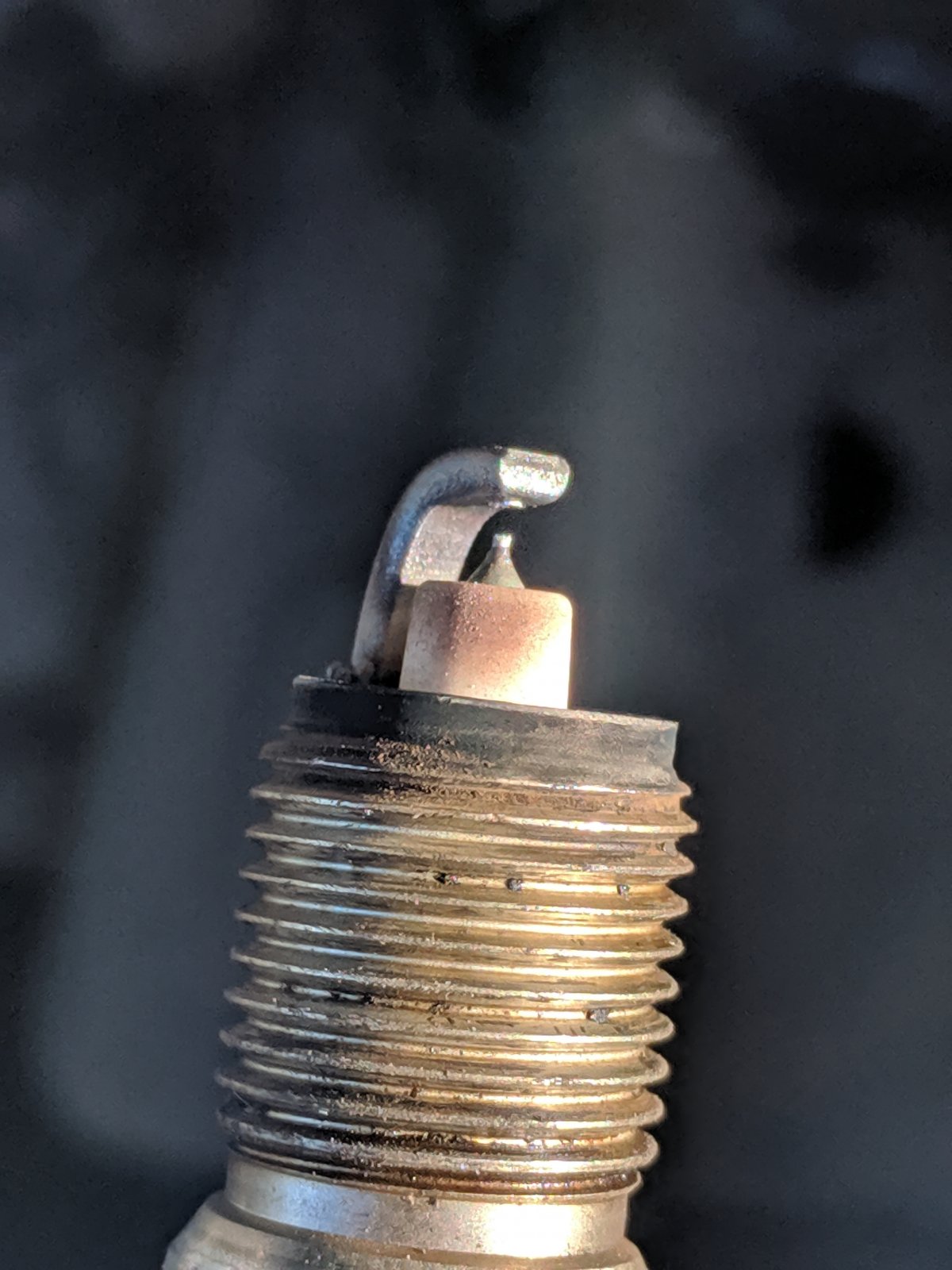

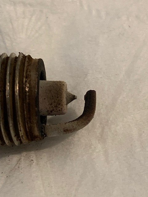

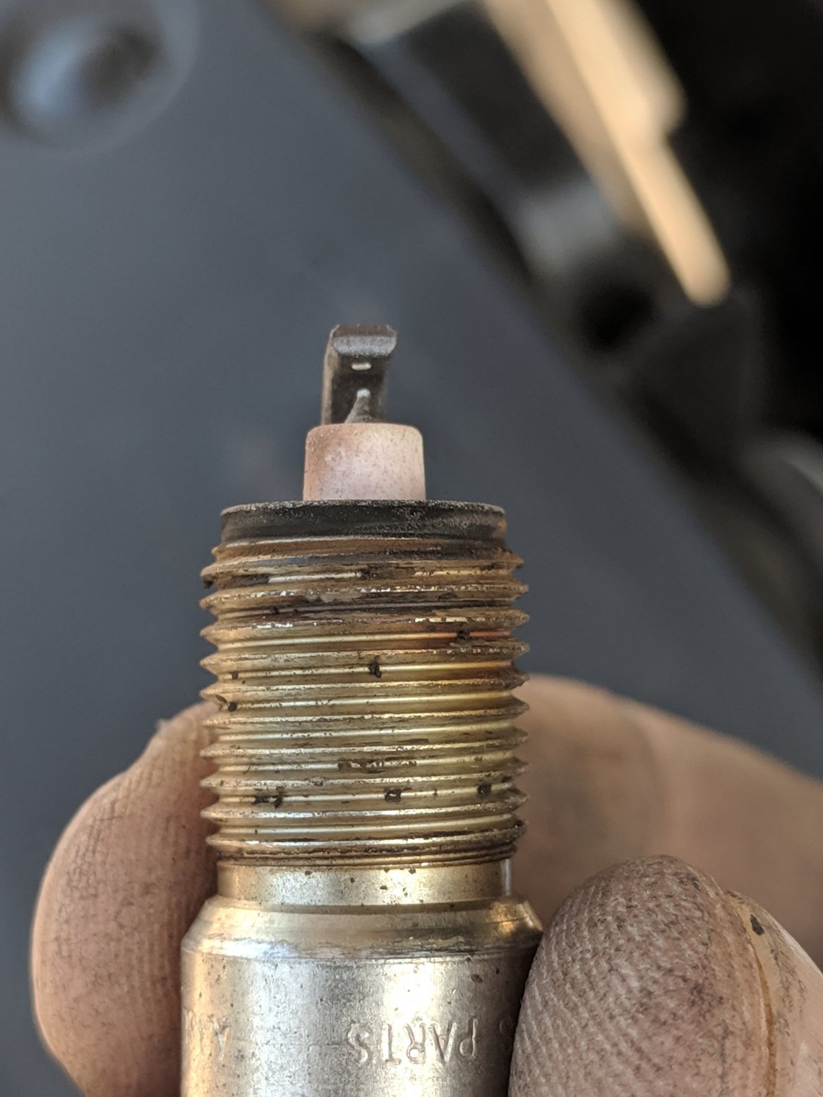

Earlier in this thread I asked what were the chances of having orignal plugs and wires. Well today I pulled # 1 plug drivers side. Wire came off easily. OK good.
Plug fought me all the way out.... not cross threaded just gunkky threads...View attachment 228372 View attachment 228373
OOOPS looks original to me..... 135 k miles
Interseting its the 41-110 EDIT IRIDIUM
ACDELCO has rebates on IRIDIUMS $3 ea.
What says the TY forum braintrust ?
Those are original, get some new ones with the same PN# and get OE wires, should be 748UU but double check on ACDelco's website:

What do you think?
30,563
48,043
Yours are not anywhere near as bad as the 135k ones...
I might just change the wires then, when I had the engine put in they said it came with new plugs but didn't say anything about the wires so they might be the originals which would have 120k

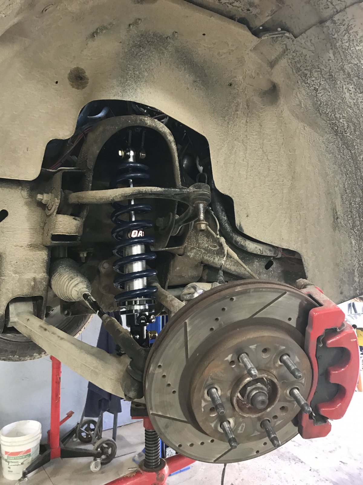

I did a lot this week... Started by taking out my BellTech drop struts up front and put in some double adjustable QA1 coil overs and also removed my rear BellTech springs and put in Tony's 5-6" spring with a spacer. I put in helper bags and did the free travel mod while I was back there. Also put double adjustable QA1 shocks in the rear. The truck rides 1000X better now than it did before.

Front suspension:

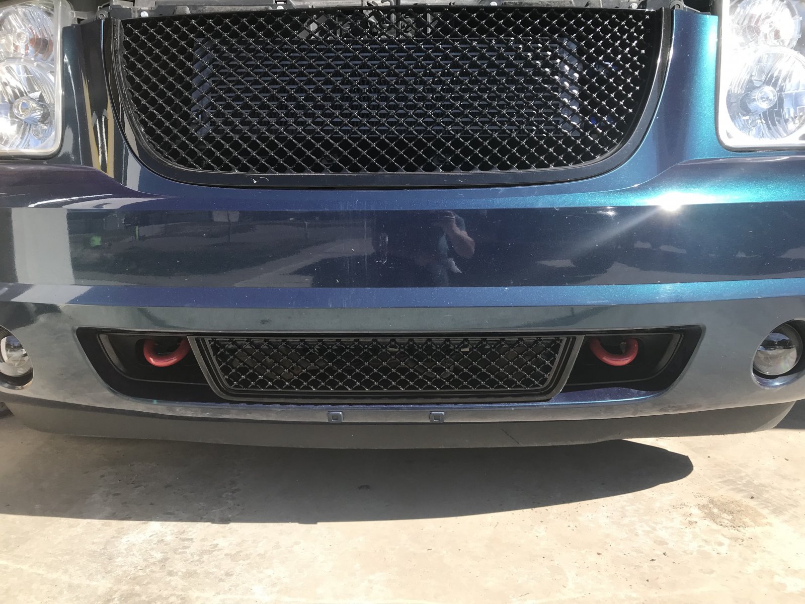

And finally, I painted my tow hooks red
