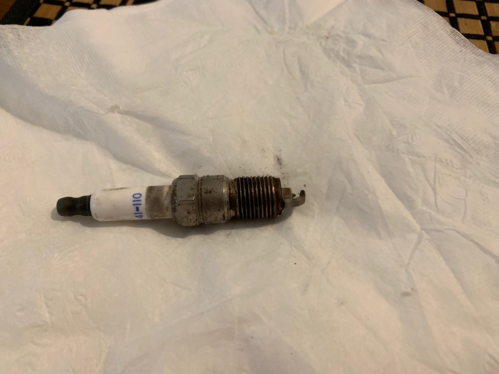

Earlier in this thread I asked what were the chances of having orignal plugs and wires. Well today I pulled # 1 plug drivers side. Wire came off easily. OK good.
Plug fought me all the way out.... not cross threaded just gunkky threads...
OOOPS looks original to me..... 135 k miles
Interseting its the 41-110 EDIT IRIDIUM
ACDELCO has rebates on IRIDIUMS $3 ea.
What says the TY forum braintrust ?
Plug fought me all the way out.... not cross threaded just gunkky threads...View attachment 228372 View attachment 228373
They originally had iridium. Now they spec platinum just for cost savings. I'd go iridium again.
Iridium yessir.
I’d also go irridiums again. I’ve got 228k on mine and prob also OG plugs and wires. Gonna change mine out at some point.
