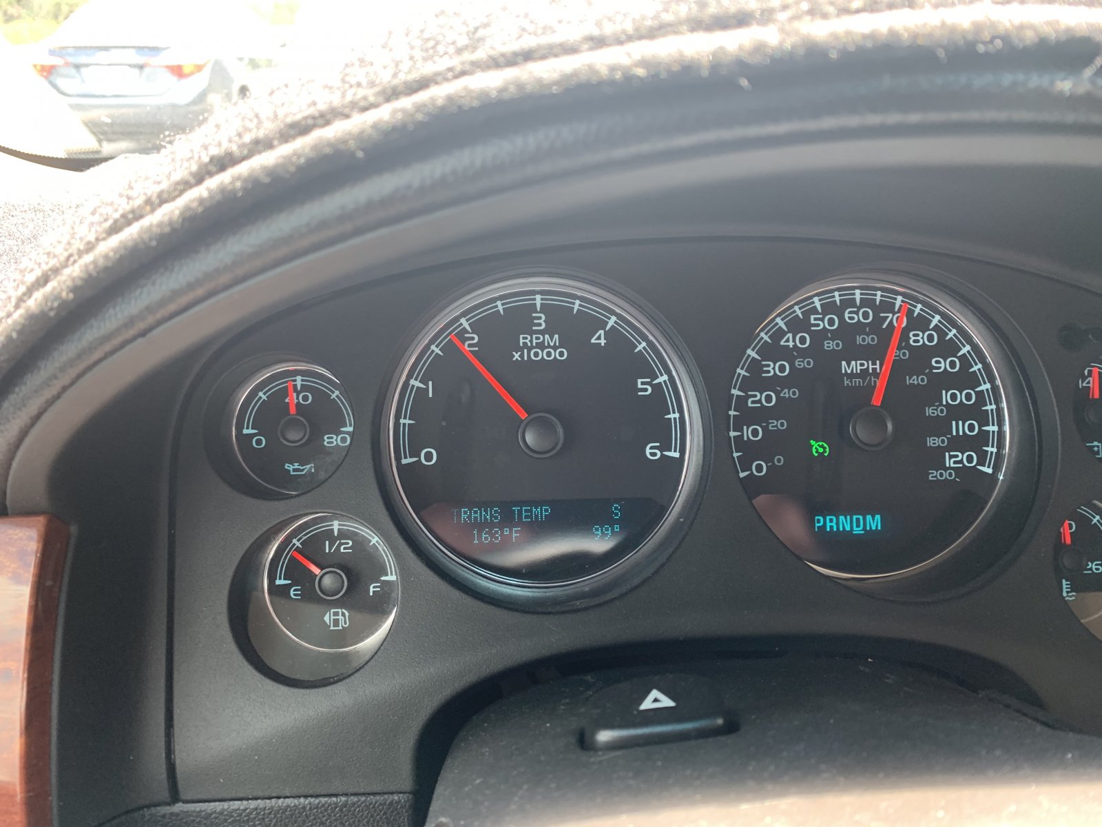

Down to Boynton Beach today:
Hit 100 right after this photo was taken. Time for a dusting!

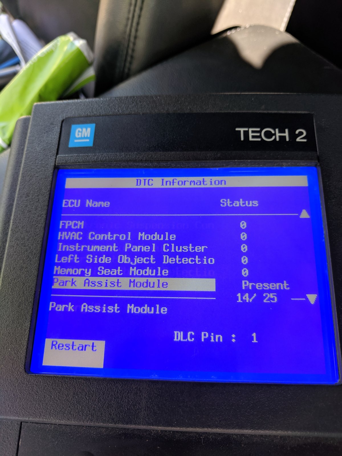

Success! replaced the passenger/right side blend door actuator, calibrated and no more codes! I used the dorman 604-106 which replaces the oem # 1572971, both the left and right sides use the same part number, the left is on the bottom, right is on the top.

Uh oh...a Dorman part in a hard to get to place? Sure hope it lasts. :)
