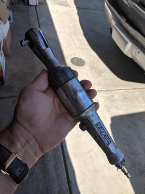

This comes in real handy, big time, time saver, doesn't have a lot of torque but once you break it loose this takes all the work out of it, bought it used at the flea market for like $15 put a new connector on it works like a champ

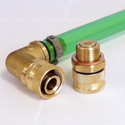

I bought the Femco, it has a different design. It can’t drain until you screw the fitting on that has a hose already attached pointing straight down from the engine. When you screw the hose on, it pushes the plunger in. It also has a brass cap that screws on to the part that’s in the pan, to keep dust out and just makes it look better when not draining oil.

Nice, I like it!

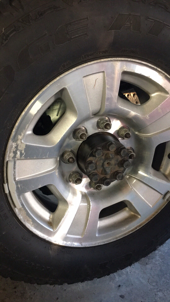

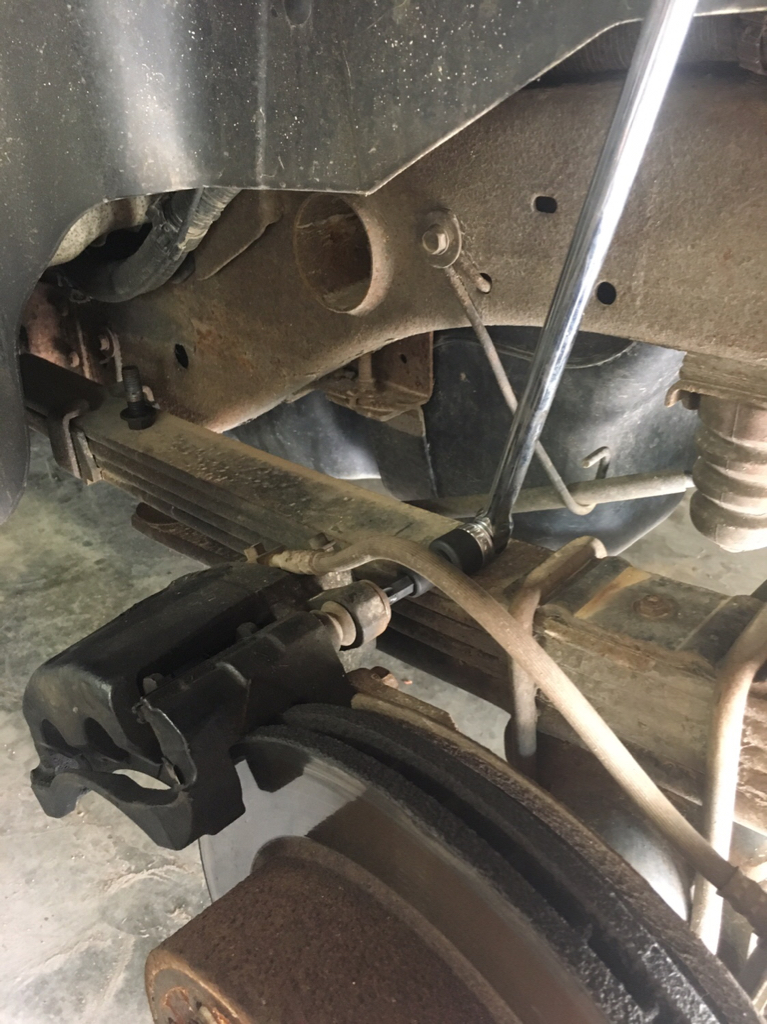

I did rear brakes and the driver side axle seal over the last couple days. Figured out a easy way to get the top caliper T55 slide bolt out without using cussing GM. Took the bottom bracket bolt out and swung the caliper up, which gave me clearance for a T55 socket. If you have ever done rear discs on a 14bolt you know how frustrating that top bolt is.
Buttoned up with drilled and slotted rotors to match the front.

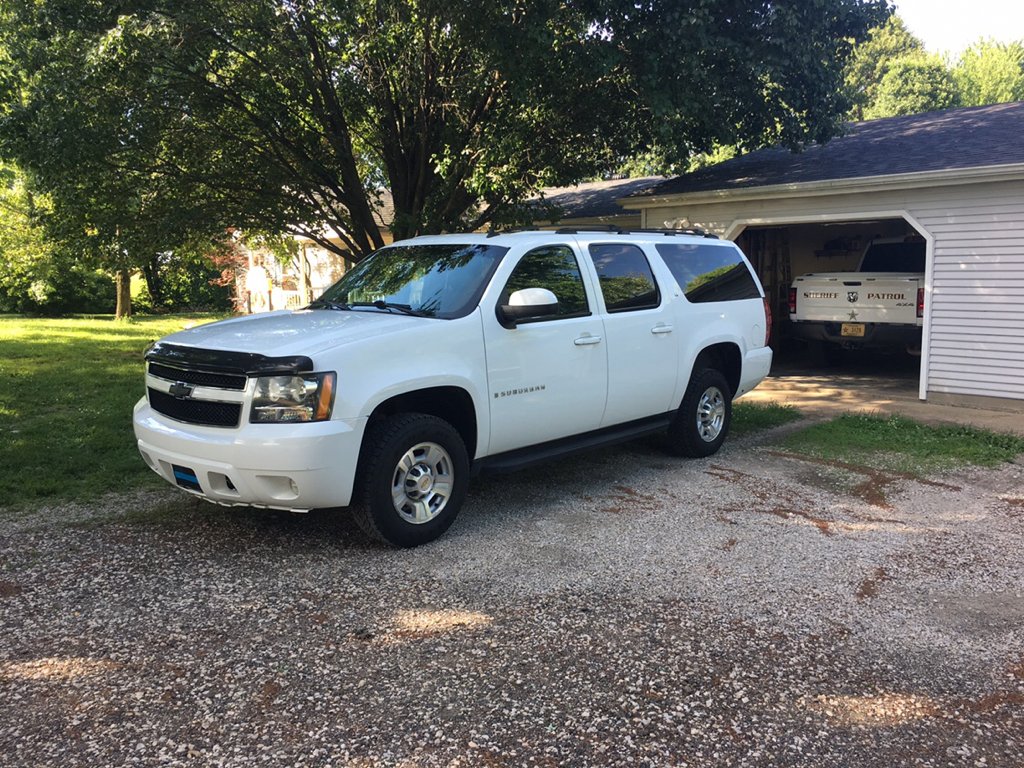

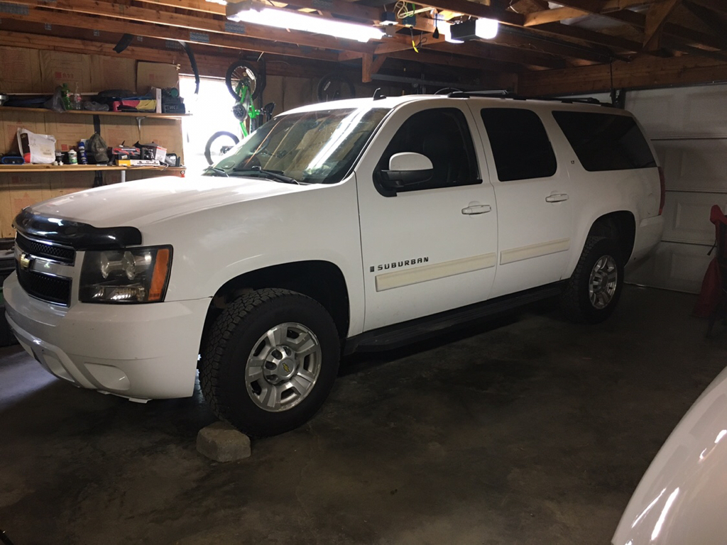

Pulled the faded door trim off once that was done.
A before pic; they were more of a buttercream color than white...
It’s amazing what all you can get done while your wife is out of town [emoji2]

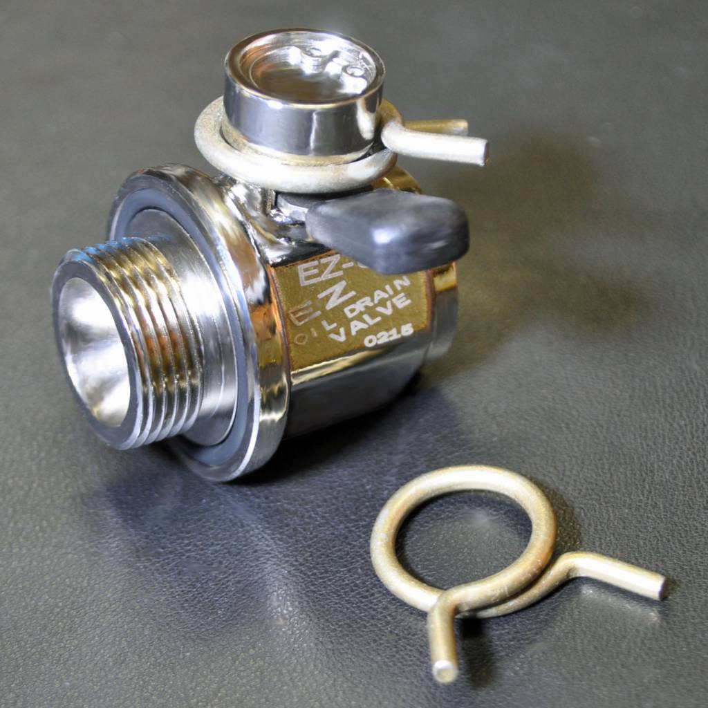

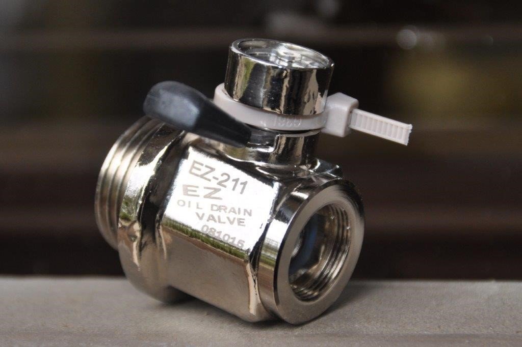

Not the Fomoto brand, but just like it. They use a 5/8 spring clip. A zip tie can also be used.
For users under extreme conditions: If you are using the Engine Oil Drain Valve on off-road vehicles such as farm tractors and logging equipment under extreme environment (i.e. corn fields, brush areas), it is recommended that a hose clip as shown below be used for extra safety and security..

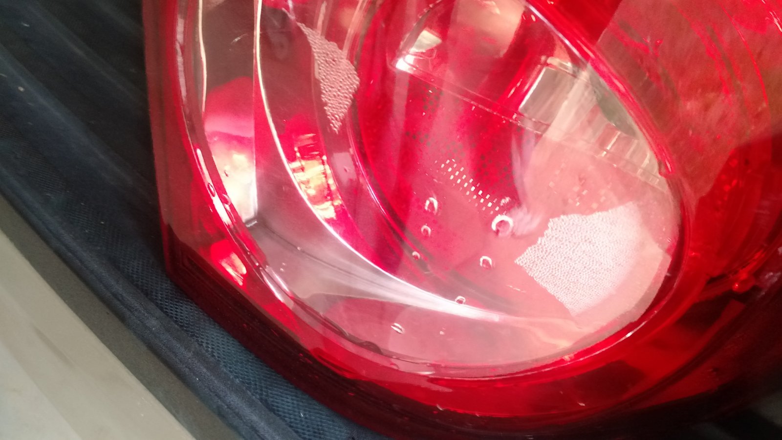

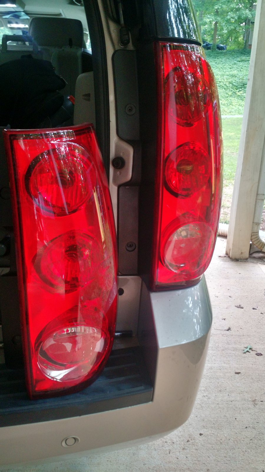

Well, been meaning to do this for a while.. light had a small crack since I bought it, and since I'm lazy and love the carwash, the "forced" water found the crack. Got sick of looking at the condensation.
So anyway I love swapping the tails on these, two screws and some wiring.(screw you GM for the headlight design)
I do have to pull it again, apparently one of the bulbs that came with blew already(cheap chinese bulbs.)
I still haven't put LEDs in the reds back there, maybe I'll do that.
Anyone in NC have use for a RR taillight with a crack and wiring harness.

I just google that and don't even see it pop up :rofl:
