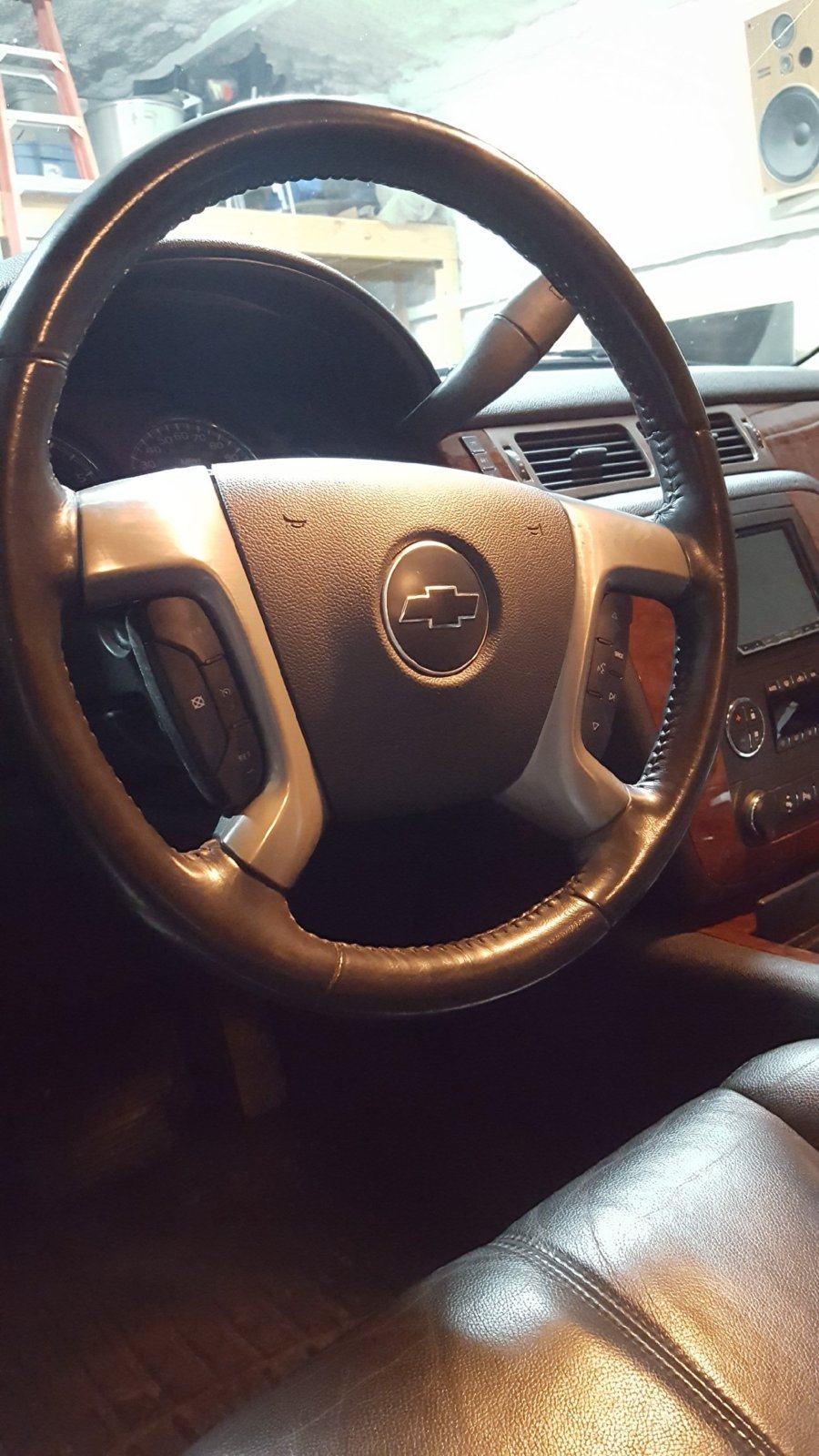

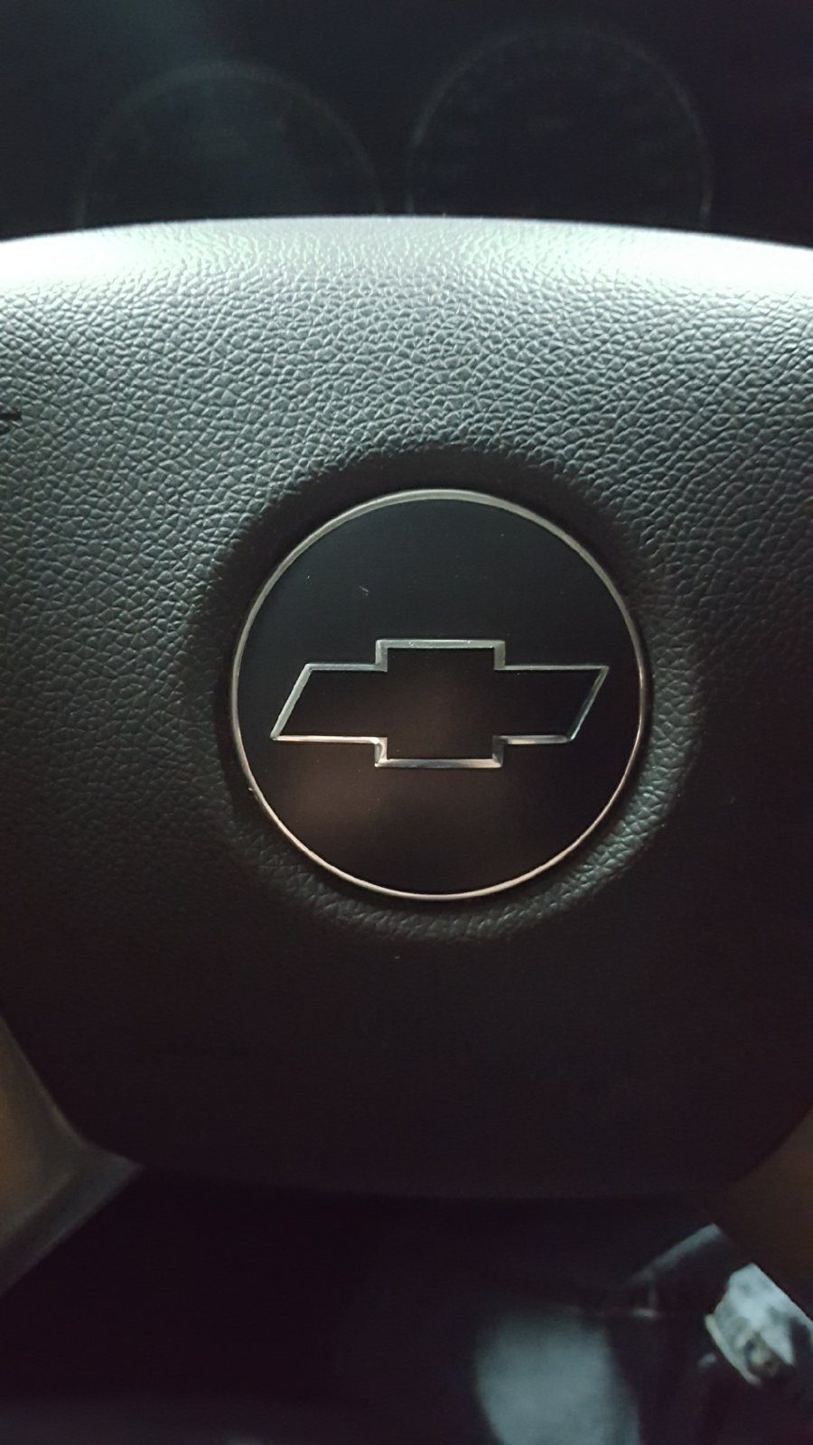

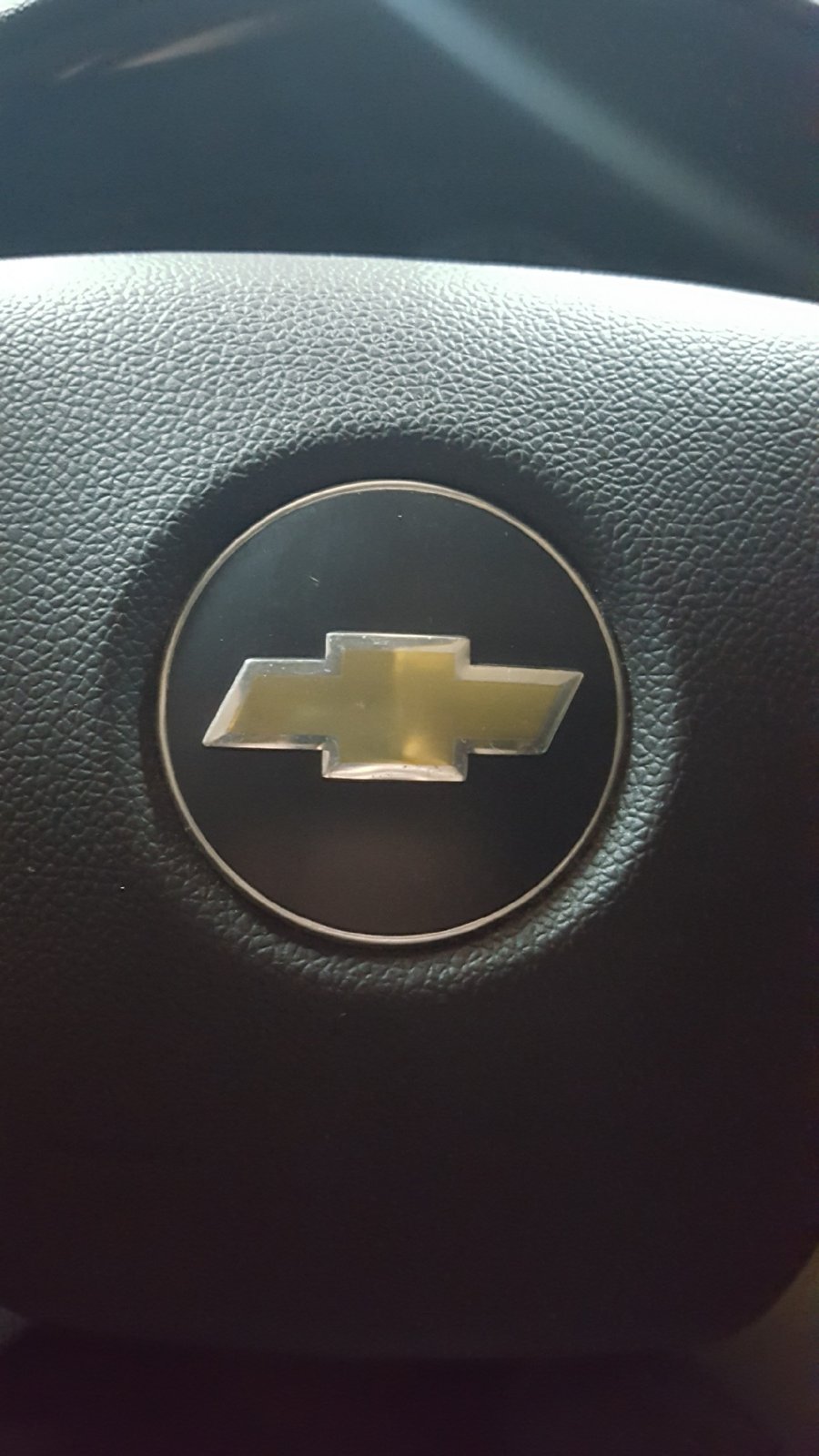

Before:
During:
After:
The color matches better from normal angles and lighting:
Thanks for the lead, @mazdawg(Mikey)!
What did you remove the gold with???
Lacquer thinner and a Q-tip???
Is that part of the instructions for install or are you just that ****???... lol
*** EDIT***
Nevermind I just saw your post in your build thread about it... didn't see that before I posed these questions.
45,012
*** EDIT***
Just an alcohol prep pad. I use them for everything: Cleaning cell phone screen, automotive bulbs, and any surface to which I'm applying a decal/sticker. Plus, I like the smell of rubbing alcohol. When it comes to stickers, I aim to make them look like they were printed on the surface directly. Trapped specks of dirt and air bubbles eat at me.
Anyway, I rubbed the gold part pretty hard to ensure it was completely clean. When I was done, I saw what I thought was a speck of something stuck to the gold part. When I tried to pick it out with my fingernail, I realized it was a tiny flap of the gold overlay sticking up. The alcohol softened it and I rubbed through in that one spot. It all came off with about three minutes of scratching with my fingernails. I'm glad this happened cuz that $5 sticker would've been stuck over a de-laminating layer which likely would've caused it to lift soon.
The only instructions that came with the decal was "Top" roughly scribbled with an ink pen on one side of the bow tie. It looked the same to me flipped either way, but I followed their "instructions" when placing it.

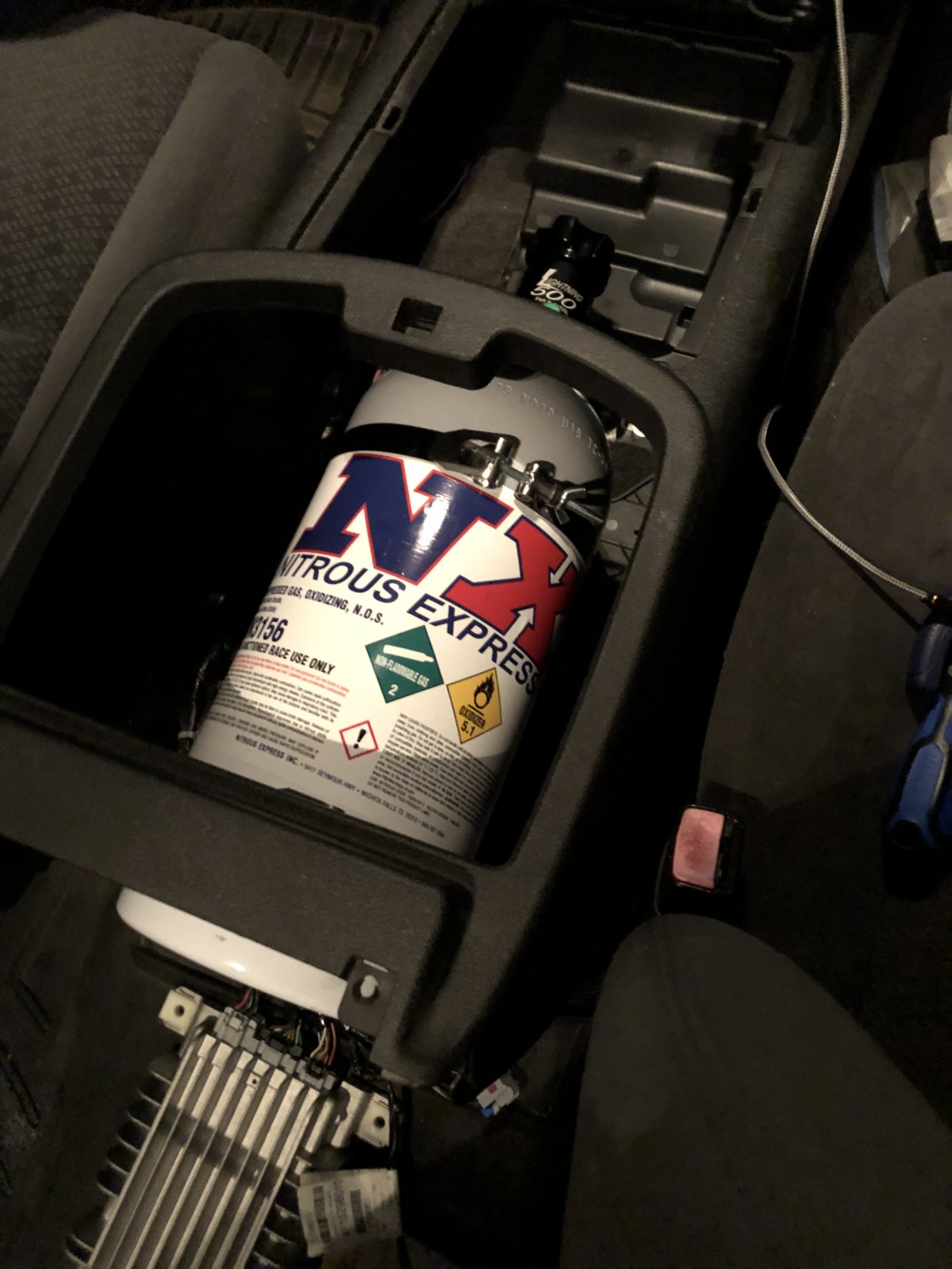

Yeah video to follow... spent tonight trying to come up with a cool spot for the bottle. I think I can get this to work and look very clean... I’ll probably leave the back panel off of the console.
Otherwise refilling the bottle may be a bit tough... Lol
I used to run nitrous on my mustang. The instant power was cool. I used an rpm activated window switch wired into the throttle position sensor that would only allow the nitrous to run between certain rpms and only when at WOT. It had a master arming switch.
Got tired of paying/filling bottles and put a Vortech supercharger on along with a meth injection kit
2001 Yukon SLT
2012 Yukon Denali XL
2011 Yukon Denali RIP 5/20/18
Yeah, I got a window switch for it. I have an LSA supercharger (not installed)... but it’ll be a more extensive project. Gotta finish my old truck before I start on that. The plan is to run both blower and nitrous...

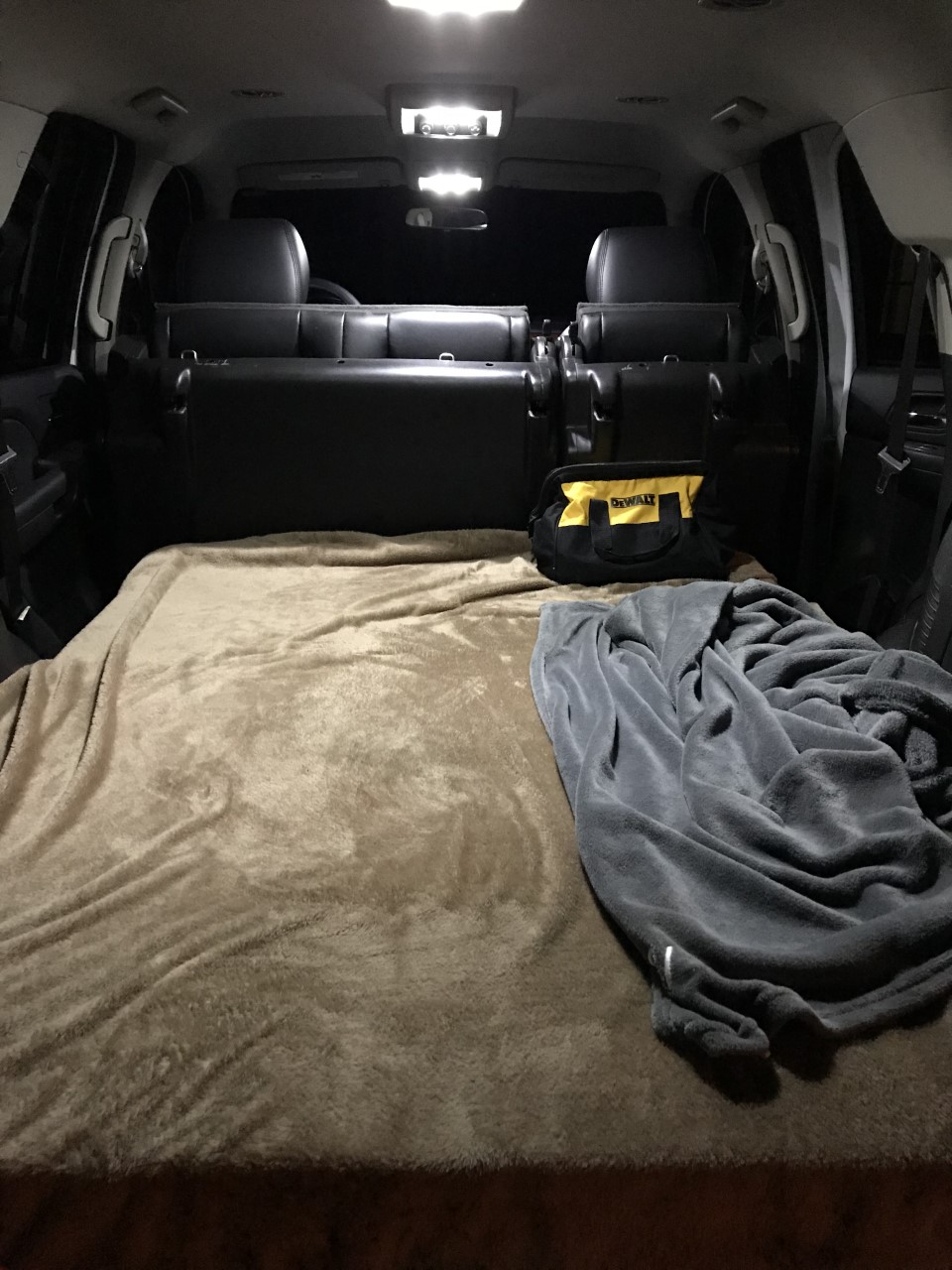

Doubtful anyone saw or remembers my custom three piece foam set I made for the Tahoe to make a bed, but I finally just went ahead and made that the default seat format. Something fun about having the bed area made up back there all the time. Especially with my $15 super soft luxurious Dollar General blanket over it. Feels like a little home. And it improves ****** efficiency. Yes, that's a Dewalt impact. Never leave home without it (and the appropriate sockets).
Doug118
Sep 22, 2012
558
1,052
I have a dewalt impact and tool bag full of sockets and a few wrenches that will never leave my truck
