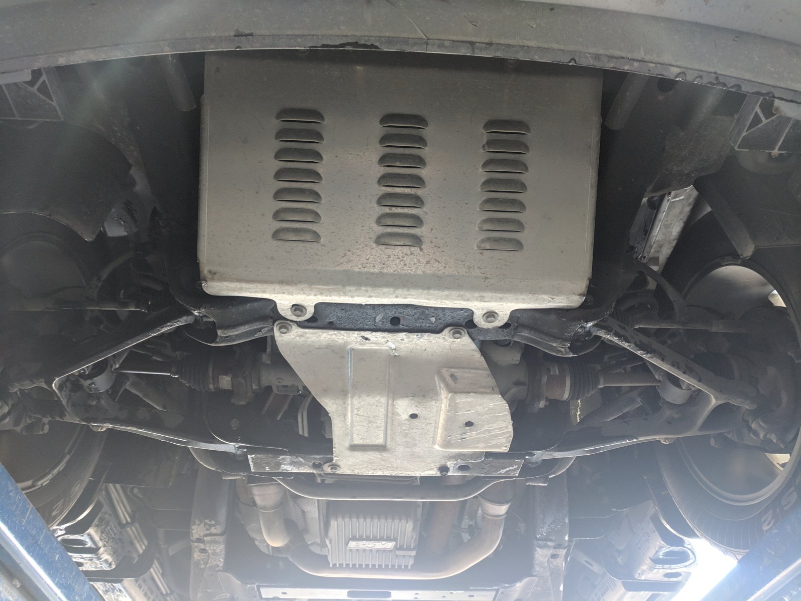

Put it up on a rack today, not a scratch underneath, the one mark on the plate is from my jack and has been there

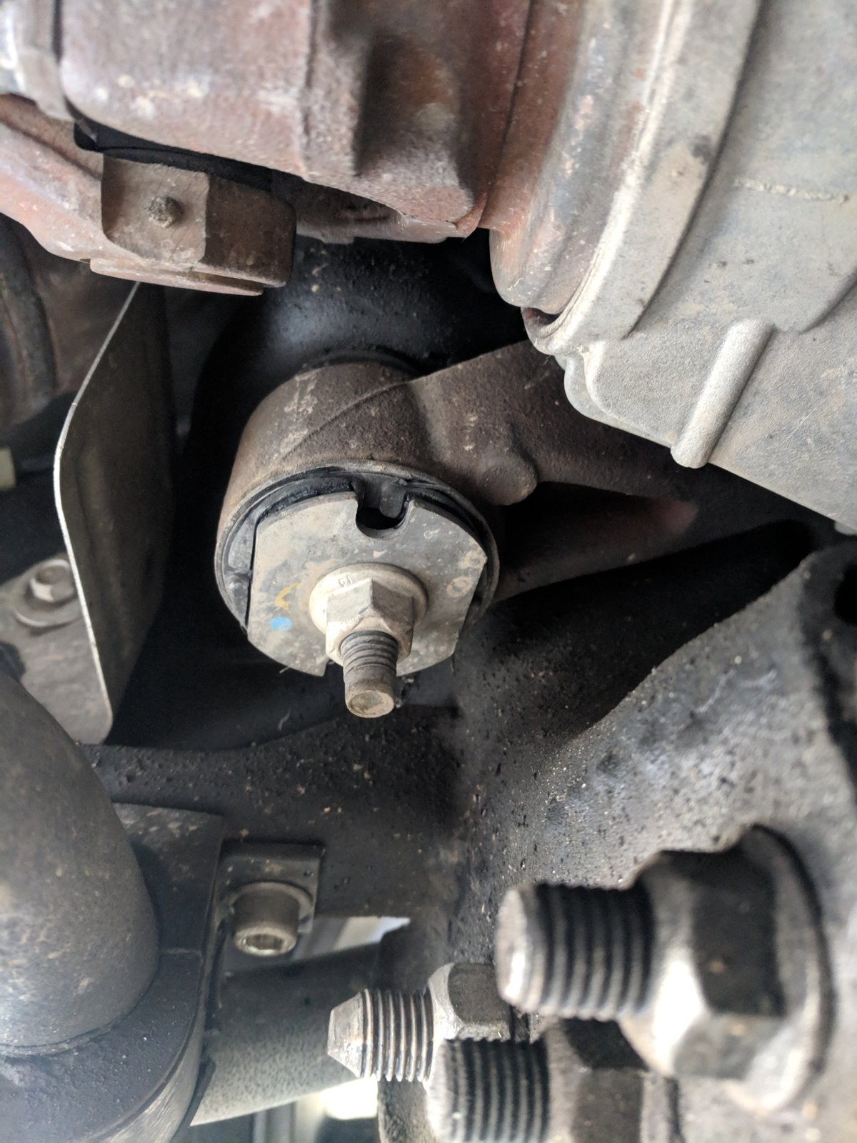

While it was up on the rack, I see these gaps on the front diff mounts, does that look normal? Does anyone else front diff mounts have the same gap?

Looks a little loose to me but I don't have a 4wd to compare.
does to me too but it also has a metal shaft in the center so it could just be the rubber bushing appears to have a gap I was just borrowing the lift to look at it so I haven't tried to tighten anything figured I would see if it's normal or not

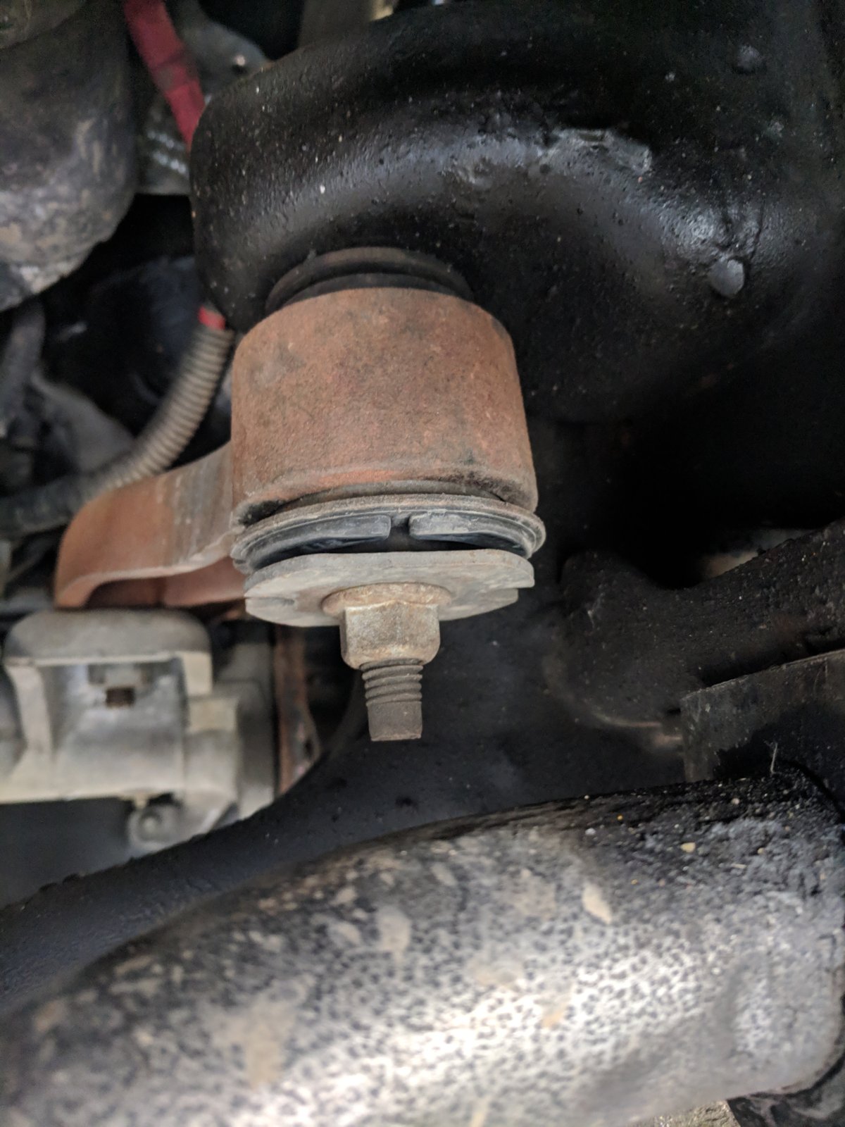

Give me a few and I can go check mine out...

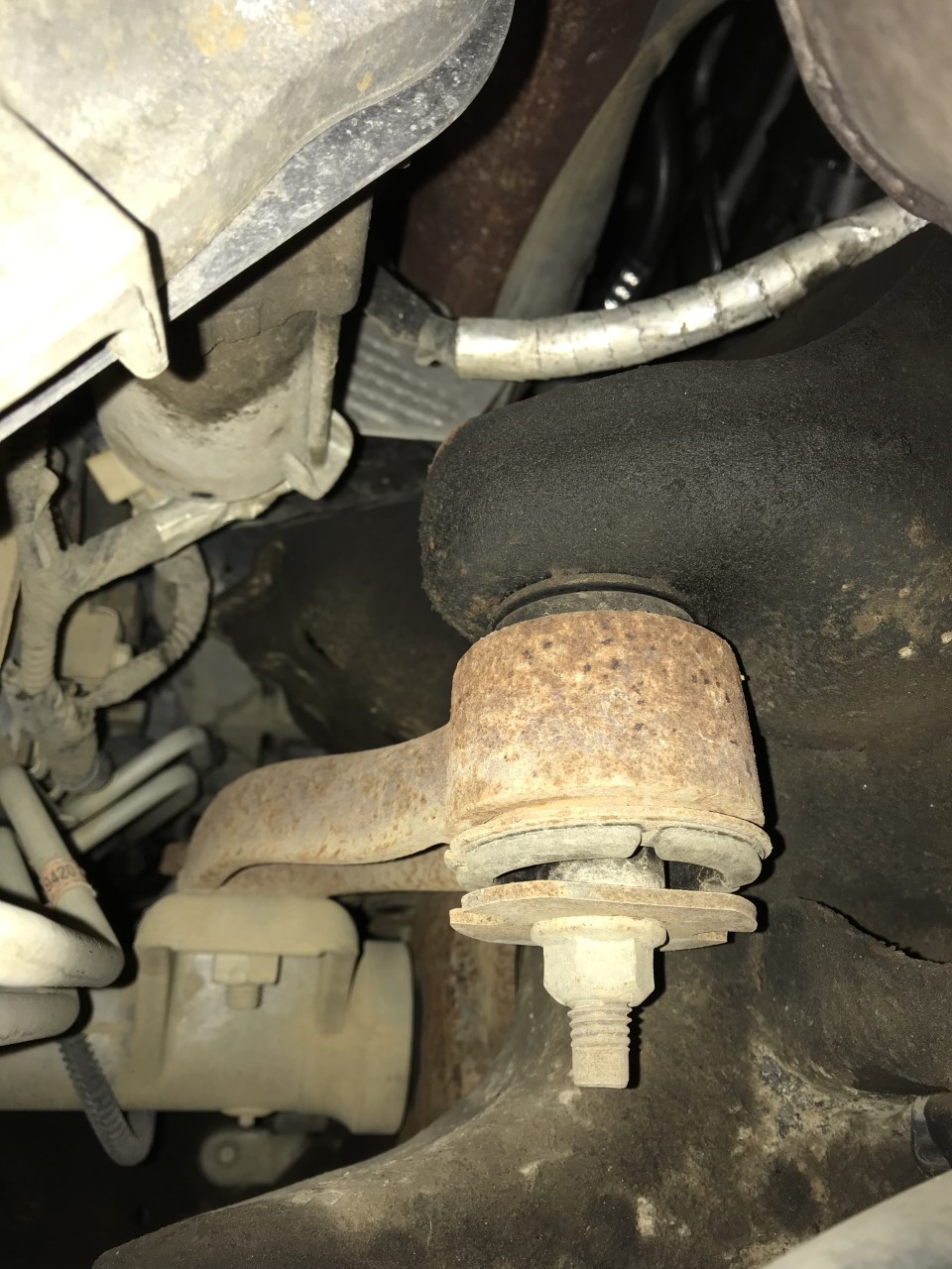

Yours looks better than mine...maybe the PO hit a stop sign in a low speed chase and never reported it.

lol, I'm pretty sure it has been this way....but I have been trying to chase down some front end noise for a while
Likely too late now, but I’d just say to try moving around with a pry bar, to see how easily it moves, as with pretty much anything underneath.
