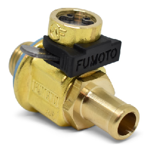

Changed the oil today. Fumoto valve makes it SO much easier. This is my 3rd change since installing.

Which fumoto did you get?

p/n F107N
On my 6.2 (and I would assume the same on the 5.3) you don't need the extra little extension fitting. Just thread right in in place of the drain plug. For piece of mind, add in the little lock clip.
Attach some clear 3/8 ID tube to the end when it's time to drain, remove the lock clip, open, drain into an empty jug.

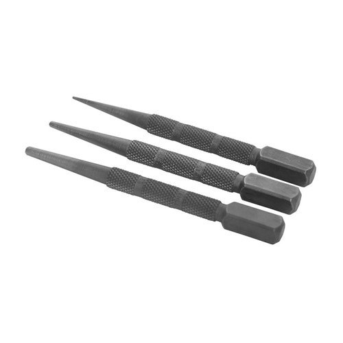

I basically do the same thing, but use a punch that's pointy on the end. I use a hammer and tap it into the center of the bottom of the filter. The punch is about 1/4"-3/8" diameter and doesn't get messy/leak oil until I wiggle it to pull it out. If I do it swift enough it just has a small run of oil down it that a paper towel in hand while doing it takes care of. I then go inside and let it drain for 5-10 minutes. When removing the filter, no oil runs over the edges and down the sides, very clean proceedure.
The punch is like this, about 6" long, and I put it in all the way to the start of the knurled part, so about 2" into the filter

Essentially the same as what I'm currently doing. Just looking for an approach that allows the attachment of a hose to simplify draining into an empty jug.
The punch & drain method works good, just when the oil stream gets thin, any kind of wind will risk blowing it around making a small mess. Currently to reduce that I try to get a jug & funnel up as close as I can to the punched filter.
