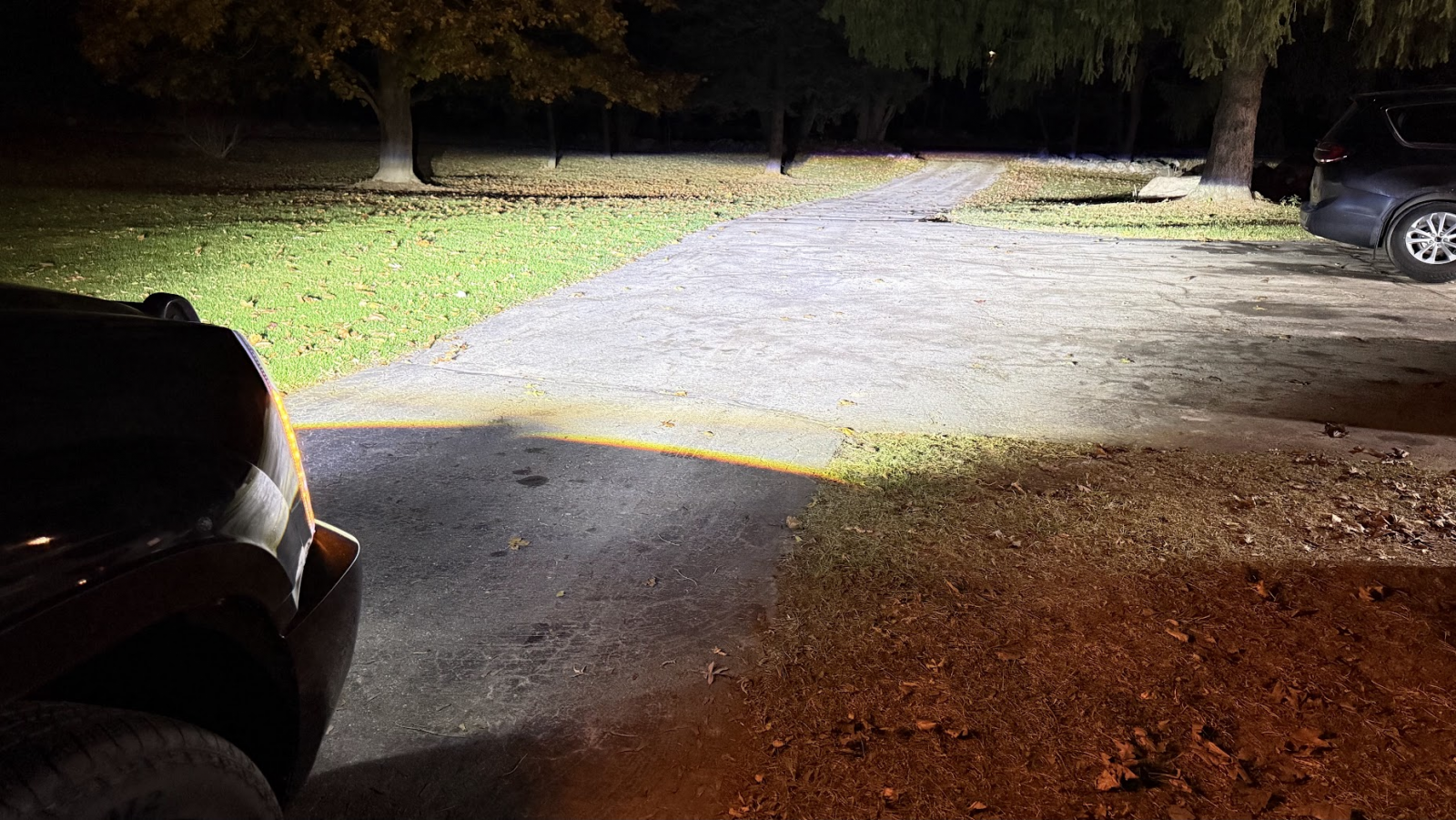

Yes Sir,
Bi-LED projectos from amazon.
Cut off the wires that used to go to the Ballasts. The yellow one is power the black is ground. On the projector the red and yellow get tied together and black on black.
For high beam there is no polarity so you hook up the original wires to the two black ones on the projector and then you either leave the ballast there or you find a nice thick piece of foam and you stuff it in the opening to prevent water intrusion. The rest is easy, reinstall, reseal with butyl or silicone or whatever you got handy and you enjoy them.
My favorite part is now the auto high beam it works very well. It didint seem to work well before due to the weak output of the headlights.
The beam is wider and goes farther than any OEM HID projector that I have seen. The old oem unit is hella based so it has a good high beam but hardly any width.

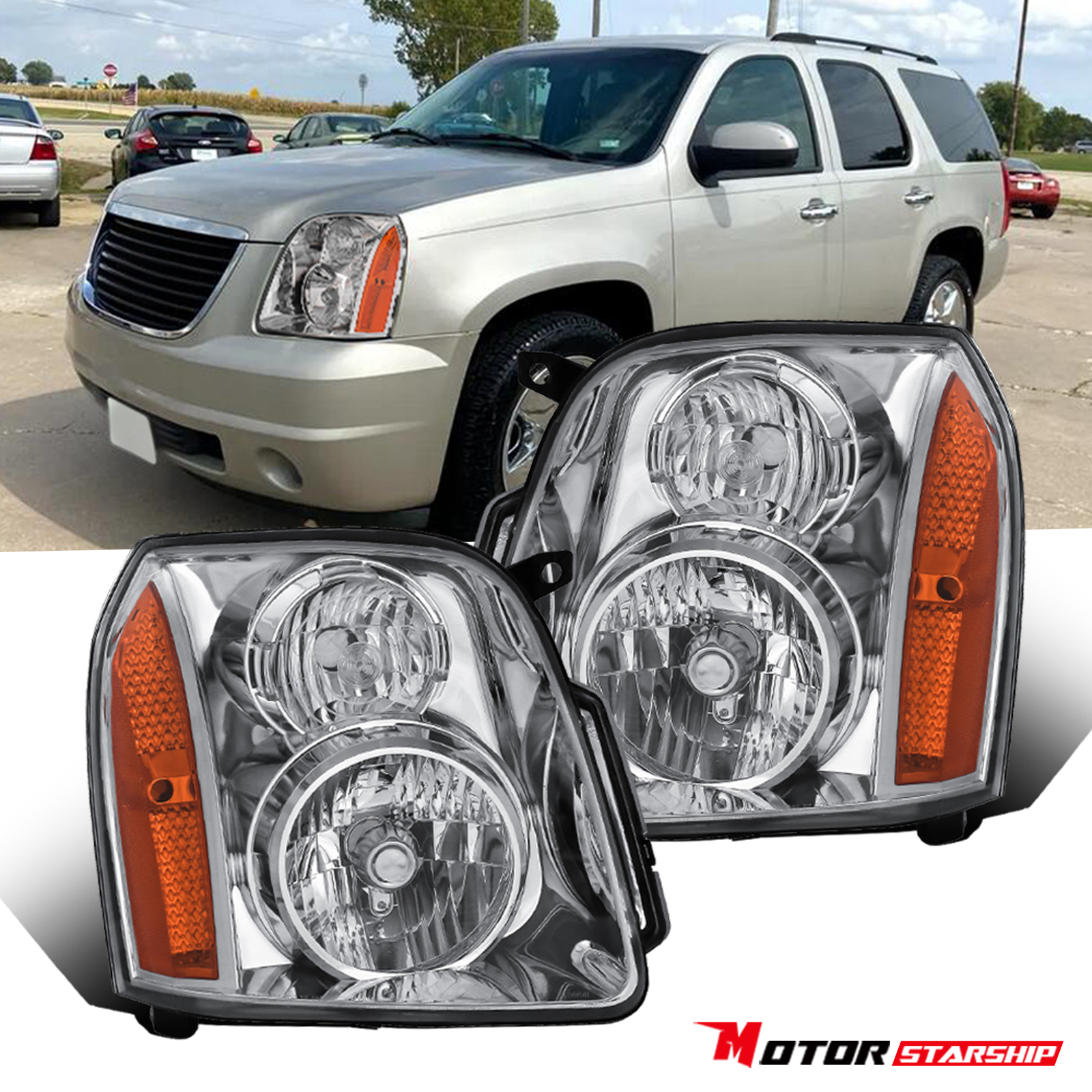

Did it take a lot of hacking up to make it fit the OEM housing?
I'm curious about buying some of the projectors you linked, and a pair of El Cheapo housings from Ebay (I see some for like $80), and performing some surgery.
How dumb would it be to jam four of those projectors into these housings? (dumb!!)
People used to do the retrofit mod of this nature on the forum all the time back in the day. Do a search. It’s super common.
