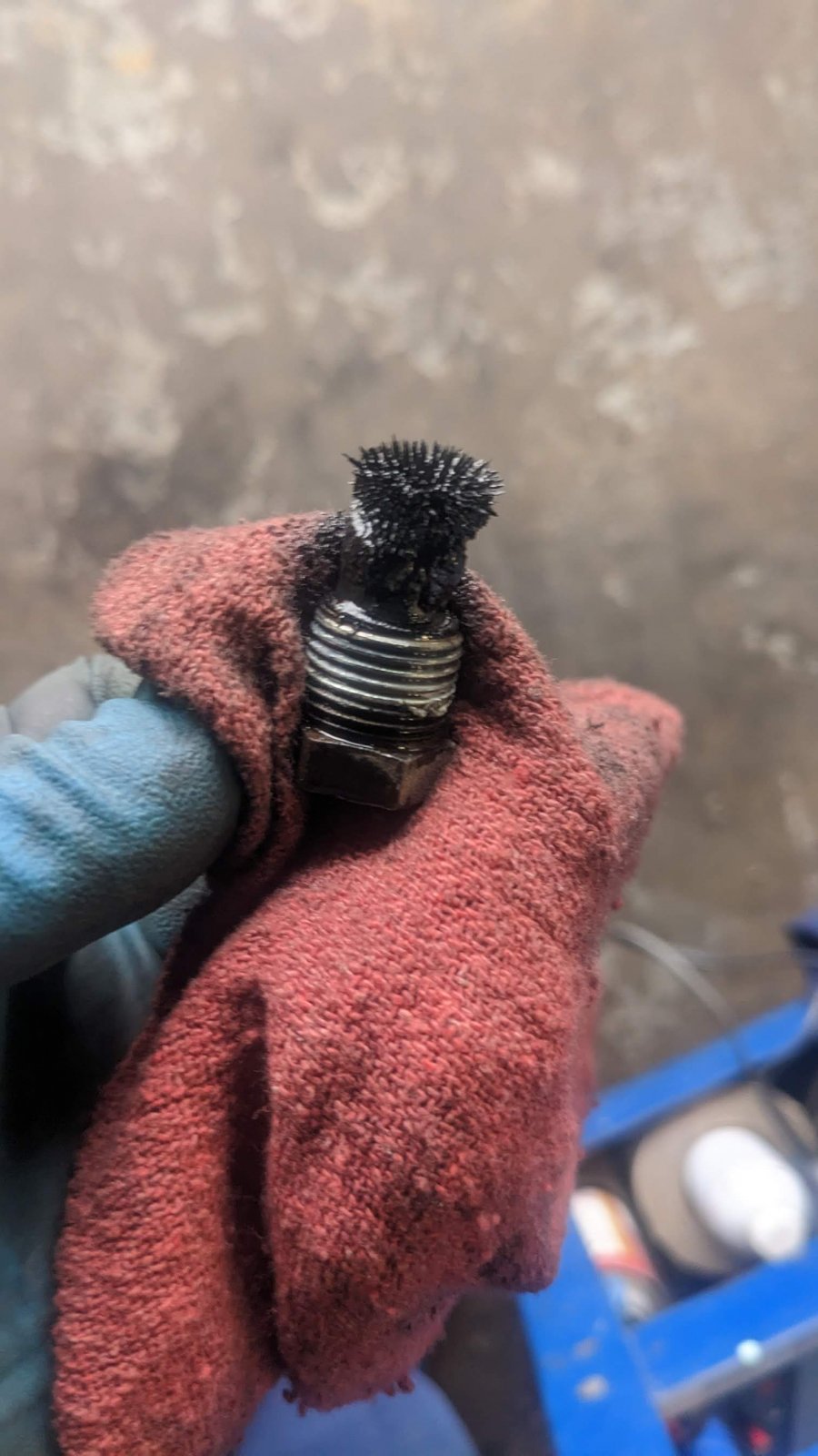

Hows the fluid in the TC?
I changed it back when I got it at 135k ish. (170 something now) it was horrible looking like it had never been changed and had metal on the magnetic drain plug. so I ran it for a few 1000 miles and then changed it again. looked pretty good that time. I haven't touched it since. I honestly never drove it is auto to know if it was noisey before or gotten worse. it's very rare that I'd use it.
it's only a few qts. I'll probably do it again just for the heck of it and see if the drain plug as metal this time.

That’s a normal amount of metal on the drain plug for a transfer case. Transfer cases and manual transmissions will always have some. Big chunks are what you have to worry about.

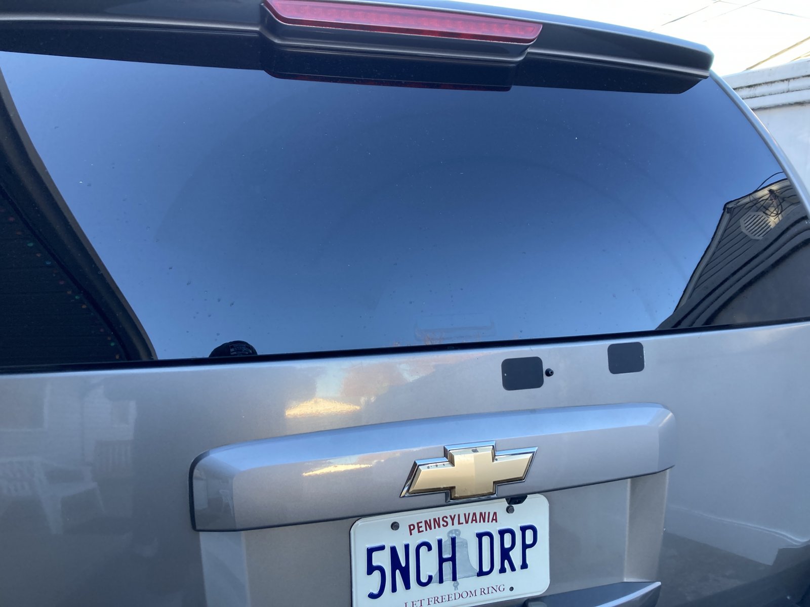

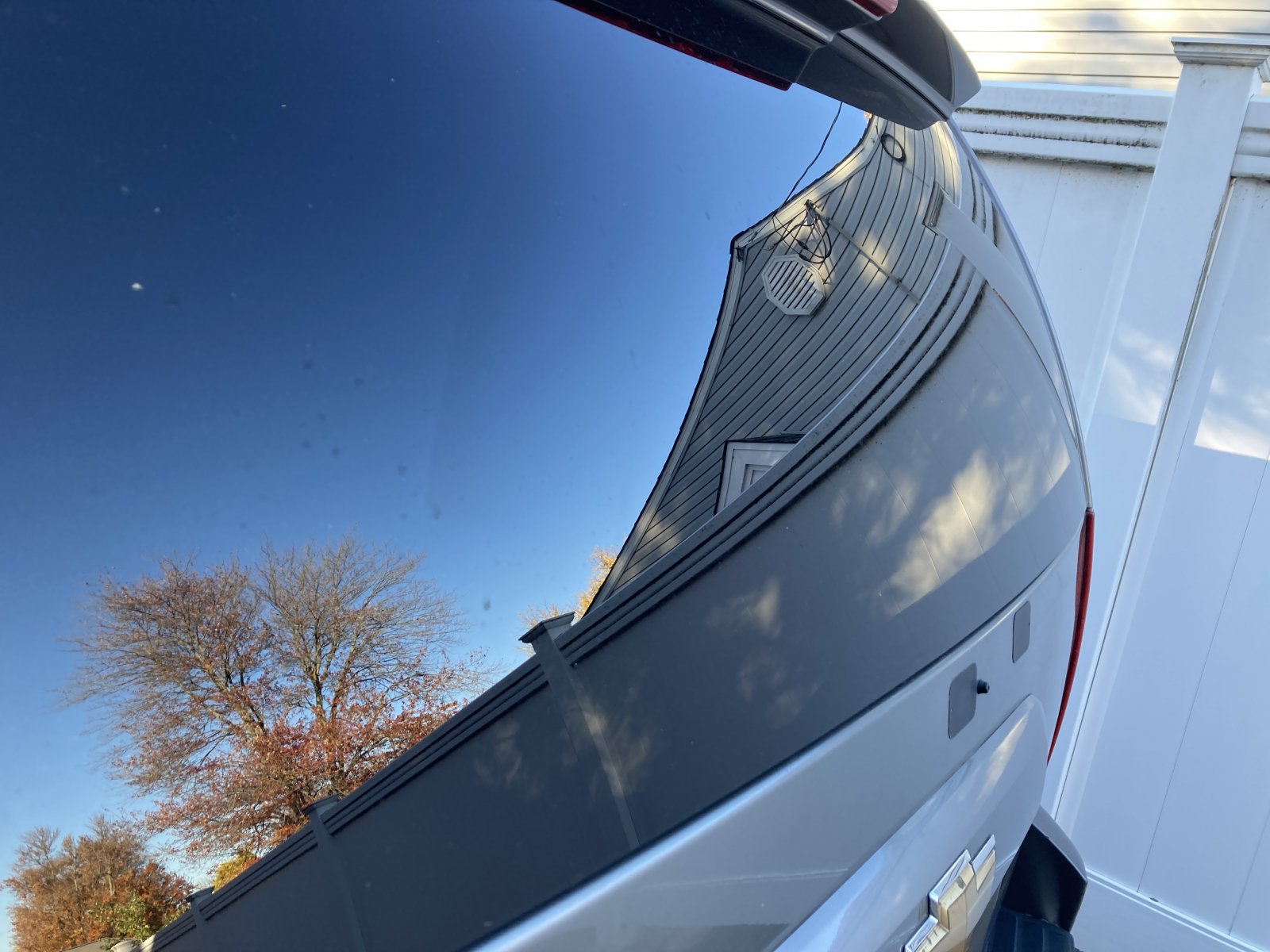

Thanks for the photo! My eyesight has been declining and I'm starting to wonder if I saw what I saw.. (hoping it's just a cataract in one eye..)
That makes me want a new rear glass. I swear it's also more noticeable when raining. It won't wipe cleanly and you get water lines in an arc, even with new blade.
So It's been about 4 years since I deleted the rear wiper. I took these pics of the glass this morning.
I haven't messed with t-case but did a lot of manauls. they definitely all have metal. this just looked a bit off to me. more like long slivers than the tranny stuff I was used to but definitely not taking it apart since I can switch to 2wd. if it was Awd and sounded like that. I'd have to look into rebuild or replace
Yeah, it'll have some metal on the magnetic plug, but it shouldn't be a ton, and the fluid should be sparkle-free.
Other than chunks of metal, the sparkles are the sure sign of bad bearings.
View attachment 471314View attachment 471315
use some of that bruces GSR those lines will disappear, you will have apply it with pressure I would use a short ladder or step so you can stand higher and lean into it while applying. glass is harder to polish than paint. you can get it on amazon, virtually nobody sells it retail.
I didn't expect the fluid to be bad, so I was just used my big roll around drain tank at work. so I never got to inspect the fluid, other than to see it was very black, which is never good for atf ha.
it wouldn't surprise me if it's bearing related. I really should look into those these style work. I just expect it to have a clutch like a auto tranny it could apply and release quickly. but I'm probably wrong as I don't even remember where it got that idea.
it's even odd gm put this tcase in a Denali. I get the feeling it was only the hybrid ones and everything else got the awd. which is weird on its own.
