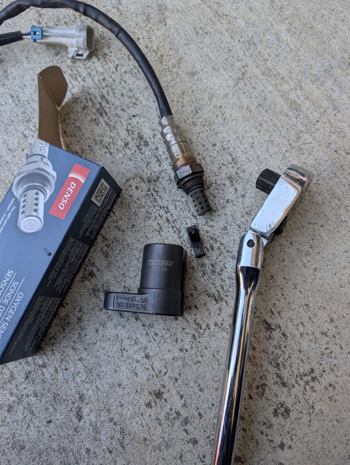

Well that went a hell of a lot easier than what I recall it taking last time, took a whole 5 minutes lol
Crows foot and angled ratchet head
