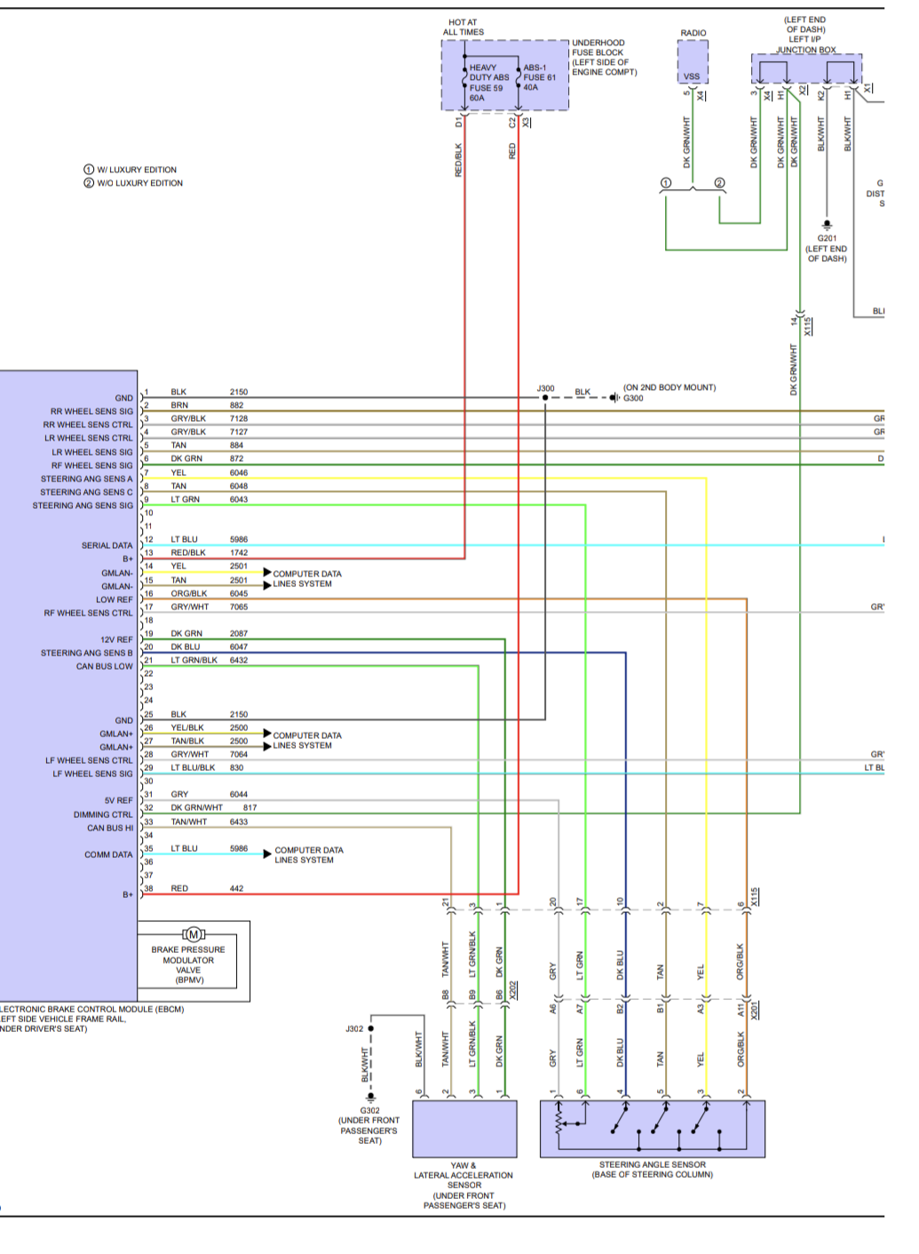

hey I forget, where you looking for a wiring diagram for your abs module?
Yes. My new oscilloscope arrived in the mail yesterday, and this weekend I'm going to start digging into the loom to see if there are any crushed, cut, melted wires.
I am starting to suspect that I might have damaged some section of the engine loom while pulling out the 5.3 or when I installed the 6.0, and this lines up (at least in theory) with how I had zero issues when I parked the Yukon, but lots of issues as soon as I fired it up with the new engine.
I guessing you don't have JD9 rpo code. this is what I get for a. 2014 slt with a 5.3. let me know if it's to blurry to read. it looks kinda blah on my phone zoomed in.
