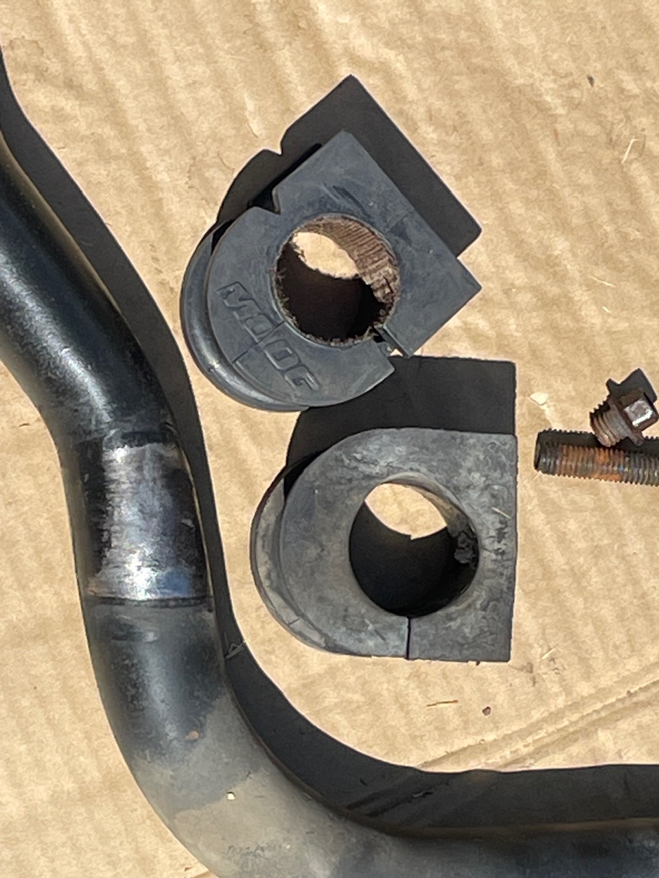

Found out my stock swaybar bushings were squeaky.. Broke one of my front swaybar bracket bolts.
Ordered some new bolts.. and still have to drill out the broken one.. but

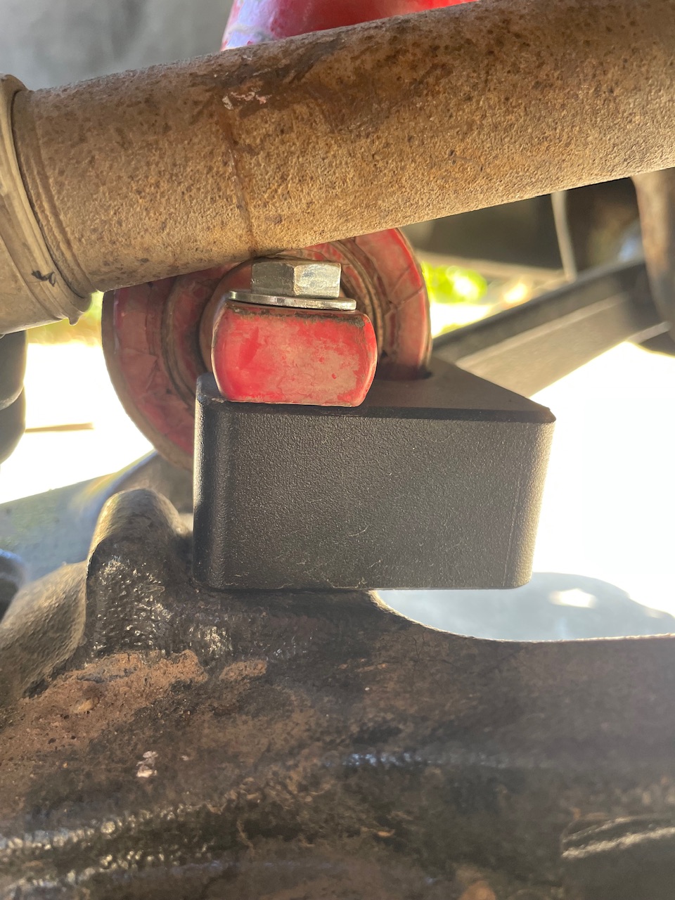

Swapping lift spacers again, the 2.5" are too close for my liking and I decided to run a 1.5" - 2.0" lift in front and nothing in rear
full droop 2.5" lift (1.25" thick), drove ok. !?
smaller hardware in the generic 2.5" kit than the roughcountry 2" hardware, smaller head, slightly smaller thread diameter.
rears with a 1" spacer seemed to bottom the shocks with stock z71 suspension... rear spacers now removed..
That bolt head is definitely rubbing that axle shaft.
You can also get spacers for the top of the strut, so you don't have to run as large of one on the bottom and still get the lift you want.

I just lubed my stock 160k mile ones. with the energy suspension lube, it's this crazy thick water proof silicone based stuff. they didn't have any crack or anything. Just a little squeaky when cold in the morning. could have been the end links. I did both.
I clocked the bolt head to minimize interference, with the smaller Motofab 2.5" bolt heads than the rough country 2" bolts..
a little space between with wheels on ground...
But yeah I'm going back down to stock level heights..
Going to try an ebay 22mm spacer vs the RoughCountry 25.4mm spacer (2" lift?) I had before for slightly more relaxed angles and little bit of rake.
