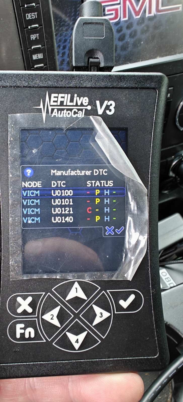

I'm trying to figure out why I have the ABS, TCS, BRAKE lights on my dash.
Both front wheel speed sensors are tight... I triple-checked harness connections this morning.
I want to see if the ABS controller is sensing the left & right sensors, but that particular function isn't working in the Tech2. This leads me to think there might be a grounding issue with the module. I'm trying to find a professional/official diagram and list of grounds that would affect the ABS module. The fuse is good. I pulled/swapped the 25A fuse with other good ones, and nothing happens.
When I get a multimeter in my hands I'll be able to test each wheel speed sensor for continuity, to rule that out.

I don't believe a sensor input missing is going to keep the tech 2 from accessing the abs module. that's either power, ground or can bus lines to it.
I feel like it should also had the ecm throwing a code that it has lost communication, but that might just be my system. since there's over 30 modules in mine, there's a request check engine light code they can send the ecm to turn on the dash light when something major happens to them. your abs sounds major.
I wouldn't be able to look up a trouble tree till Thursday, but without a code to start with. it's basically going to be checking for power at the module. shorts to power and ground type of thing.

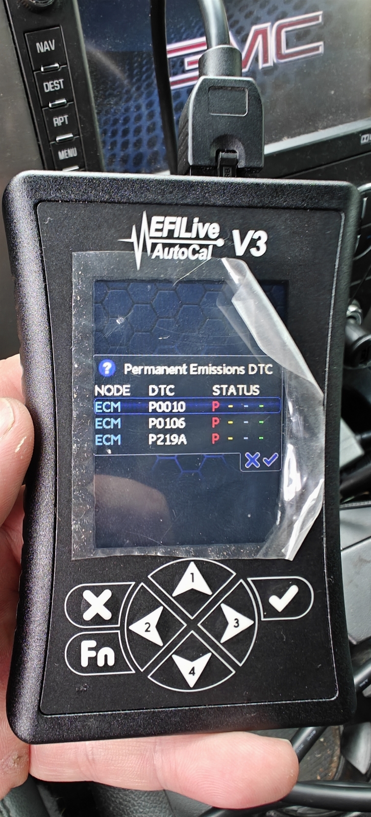

The codes should give you a pretty good idea of what is wrong

Well.... Then you will probably have to get under there with a meter and start testing for power ground, ohms. You will probably need a diagram to reference and values expected for each pin
