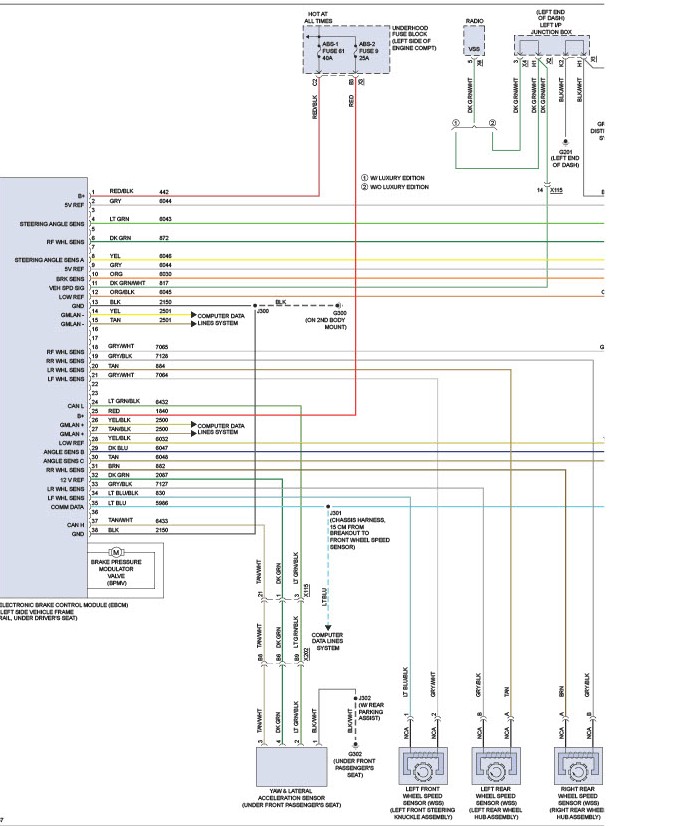

I guessing you don't have JD9 rpo code. this is what I get for a. 2014 slt with a 5.3. let me know if it's to blurry to read. it looks kinda blah on my phone zoomed in.
Awesome, thanks.
I do have the JD9 RPO code.

interesting, I quickly Googled and looked like something about 17in brakes over some weight, I'll look and see what's different about the diagram with jd9
Per your diagram Fuse 61 (ABS 1 (40A)) is getting 12v, but fuse 9 (ABS 2 (25A)) is not getting any power.
The 25A fuse is good, and I swapped it with other good fuses, to rule it out. Neither side of the fuse gets power.

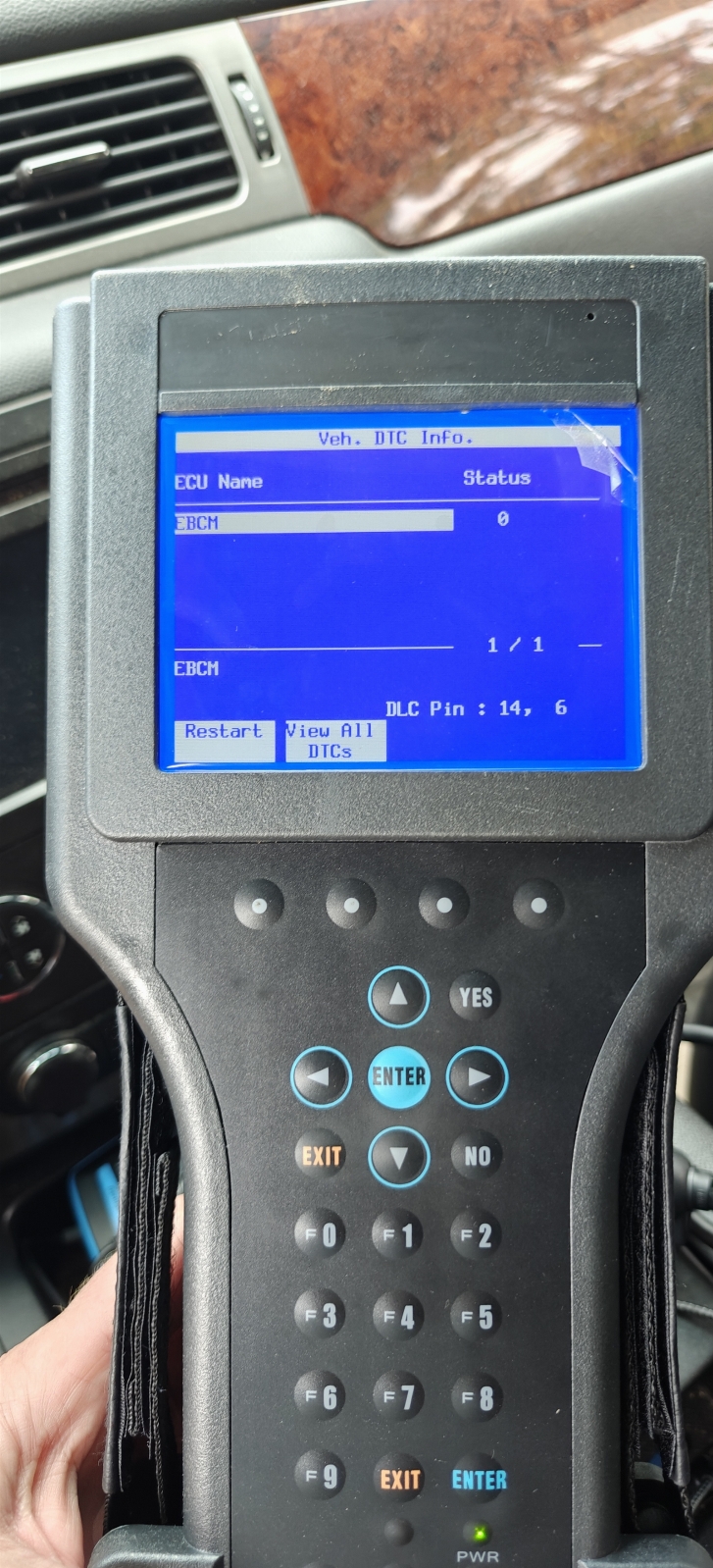

Hahaha, so I'm an idiot to the Nth degree. For some reason there should be a 2nd 25A fuse right above the ABS fuse, but..... there wasn't. I have no idea when/how/why I pulled it, but I just swapped in the wiper 25A fuse and all the dash lights went away. And, now my Tech2 talks to all Chassis modules.
