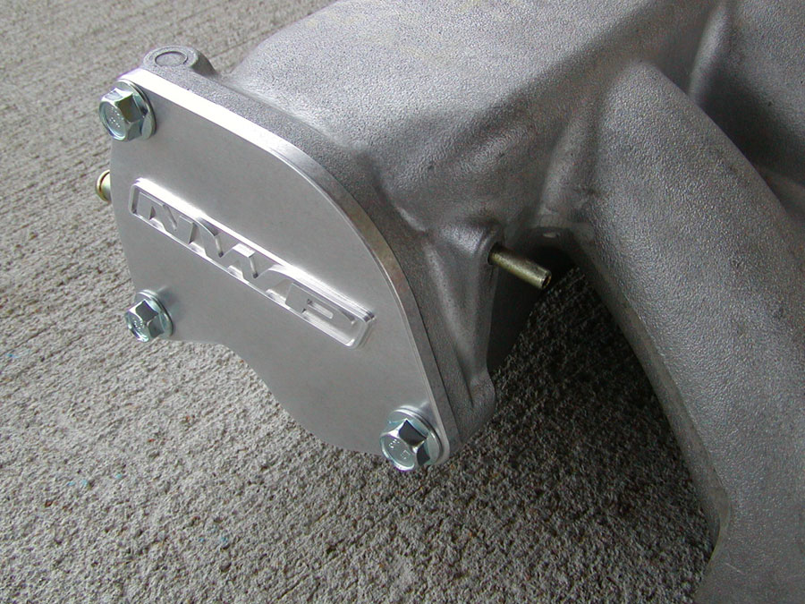

My 2002 Altima has an adjustable intake manifold where a vacuum actuator opens and closes portions of the runners depending on engine load, rpm and other crap.
I removed that and just have a plate covering the hole where the actuator went.
Not a singe time I've had it smogged has any tech ever questioned the plate.
The plate isn't small, it's at least a 6 in by 4 in aluminum plate with the name of the manufacturer embossed into it.
My guess is they are clueless about the intimate details of the VQ and since I have never been flagged to see a referee, no one has ever had the spec sheet out while looking under the hood.
I don't know anything about Nissan engines. Why did you bock it off? Is that system generally a problem?
Long runners move the power band lower in the rpm range while shorter runners move it higher in the rpm range. Having both and the ECM controlling a valve for which one it uses for best performance for certain conditions would be a neat bit of engineering. Did it not work correctly?
So does this just open the whole manifold up, both short and long runners, or???
From what I read from performance manufacturers, the entire mechanism only restricted flow and was mainly a mpg deal and not really a performance enhancement.
Without the assembly the car has a pending code for the system but it never throws a MIL so it still passes smog OK.
Removing it was supposed to help high RPM performance but sacrifice a small amount of low RPM performance.

sadly many difference manufacturers have tried the variable intake runner length thing. the 90s zr1 LT5 went as far as giving each runner its own set of injectors for each set of runners. 16 total.
while I don't know know about around town drivability, they all alway go faster full throttle by removing it all and just using a short runner manifold. shame really because in theory it should be a good thing. but kinda the same for our vvt. you might see it on a dyno chart but no one misses it in the real world delete.
