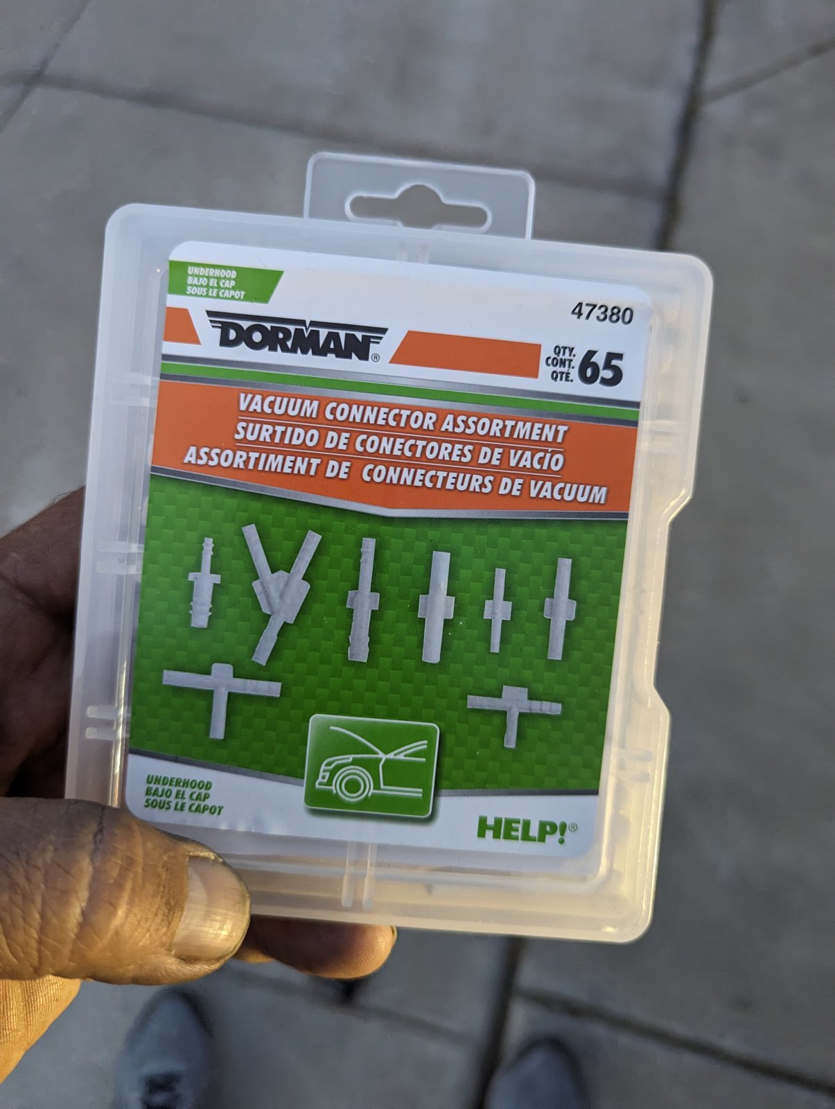

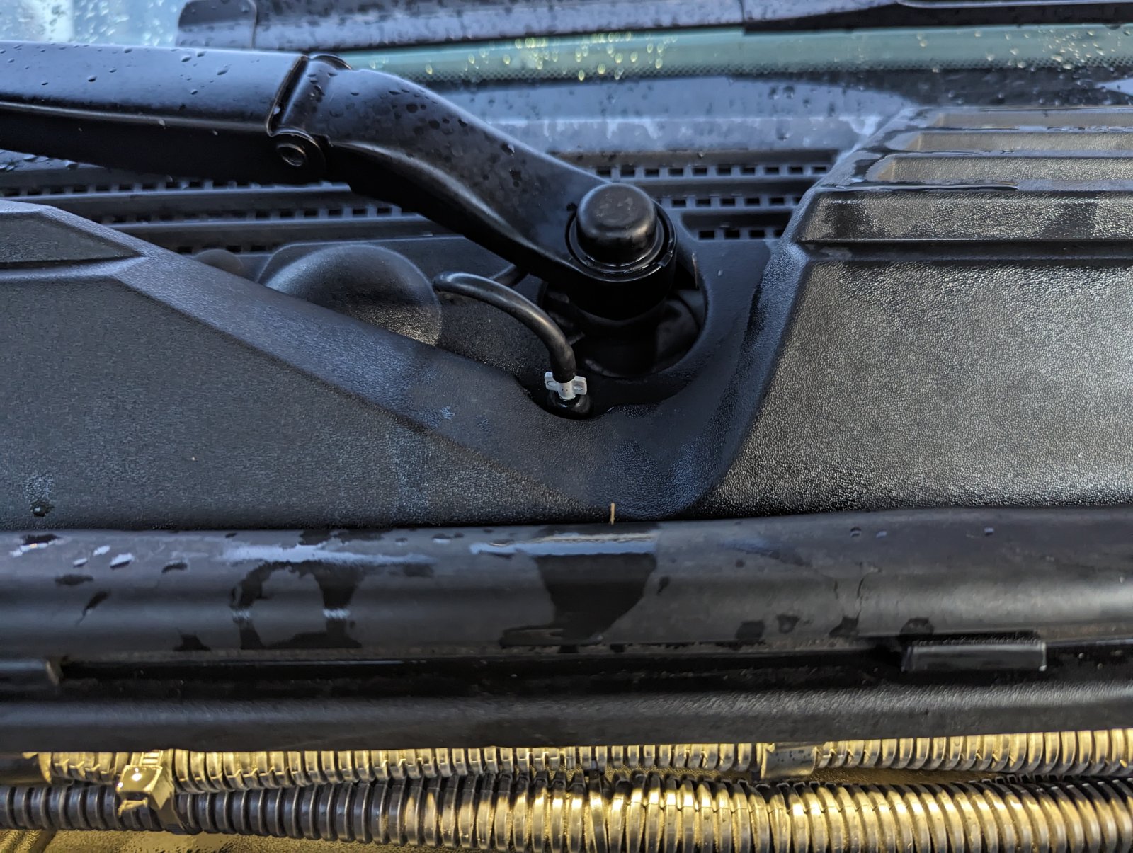

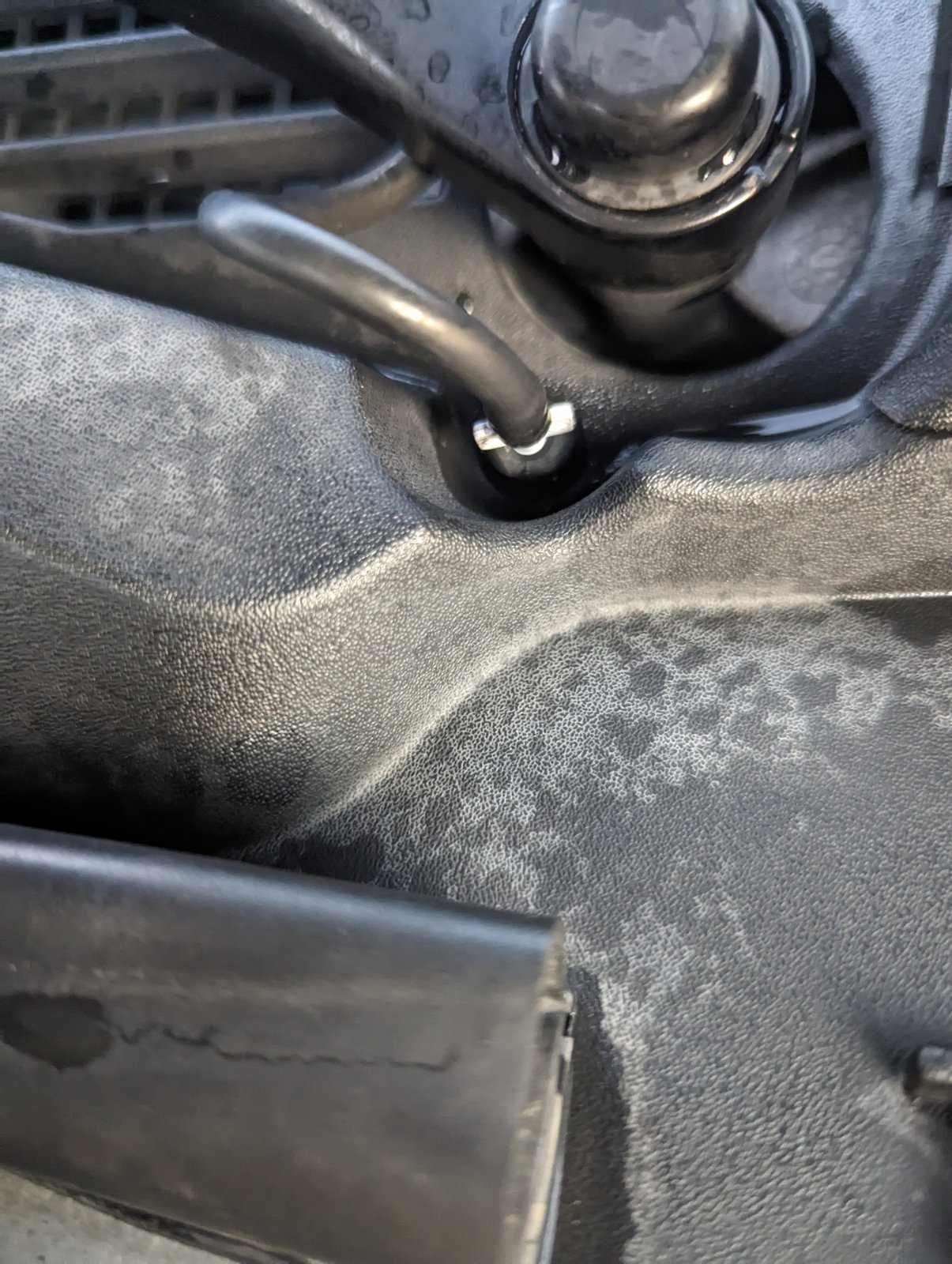

Was trying to spit polish the engine bay after cleaning all the doors and door jambs and proceeded to break both the windshield wiper fluid hoses off of the shroud, thought I had only broke one but discovered otherwise after fixing one, luckily dorman came to the rescue, guess it's time to order a new shroud if they are even made anymore
30,574
48,064
the shroud side hole wasn't quit big enough so I just hand reamed it with a small drill bit and it worked out well. I figured there was just hose connected under the shroud but I pulled it up a bit and felt under there and it's a elbow leading to the drivers side so I didn't have to brace it or anything.

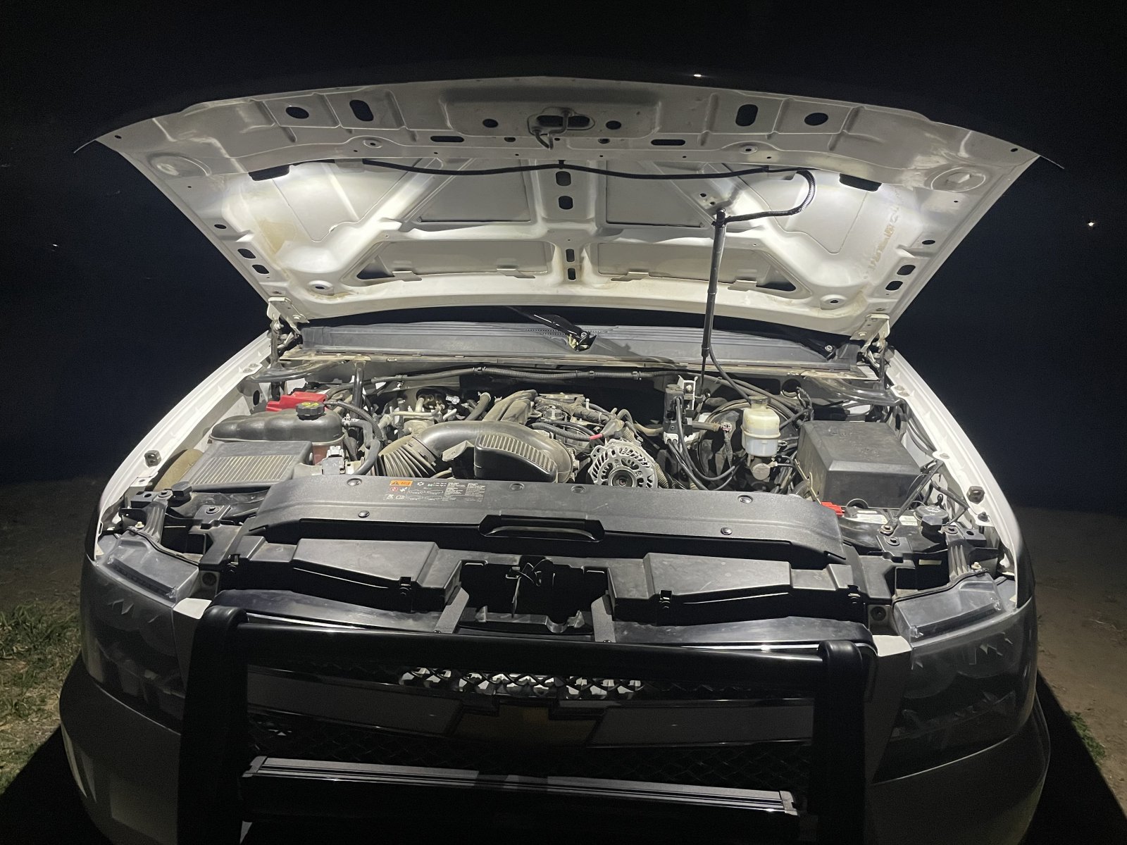

Was trying to spit polish the engine bay after cleaning all the doors and door jambs and proceeded to break both the windshield wiper fluid hoses off of the shroud, thought I had only broke one but discovered otherwise after fixing one, luckily dorman came to the rescue, guess it's time to order a new shroud if they are even made anymore View attachment 428821View attachment 428822View attachment 428823
Glad you posted this because I was contemplating taking mine off tonight to look for a water leak. Glad I didn't.

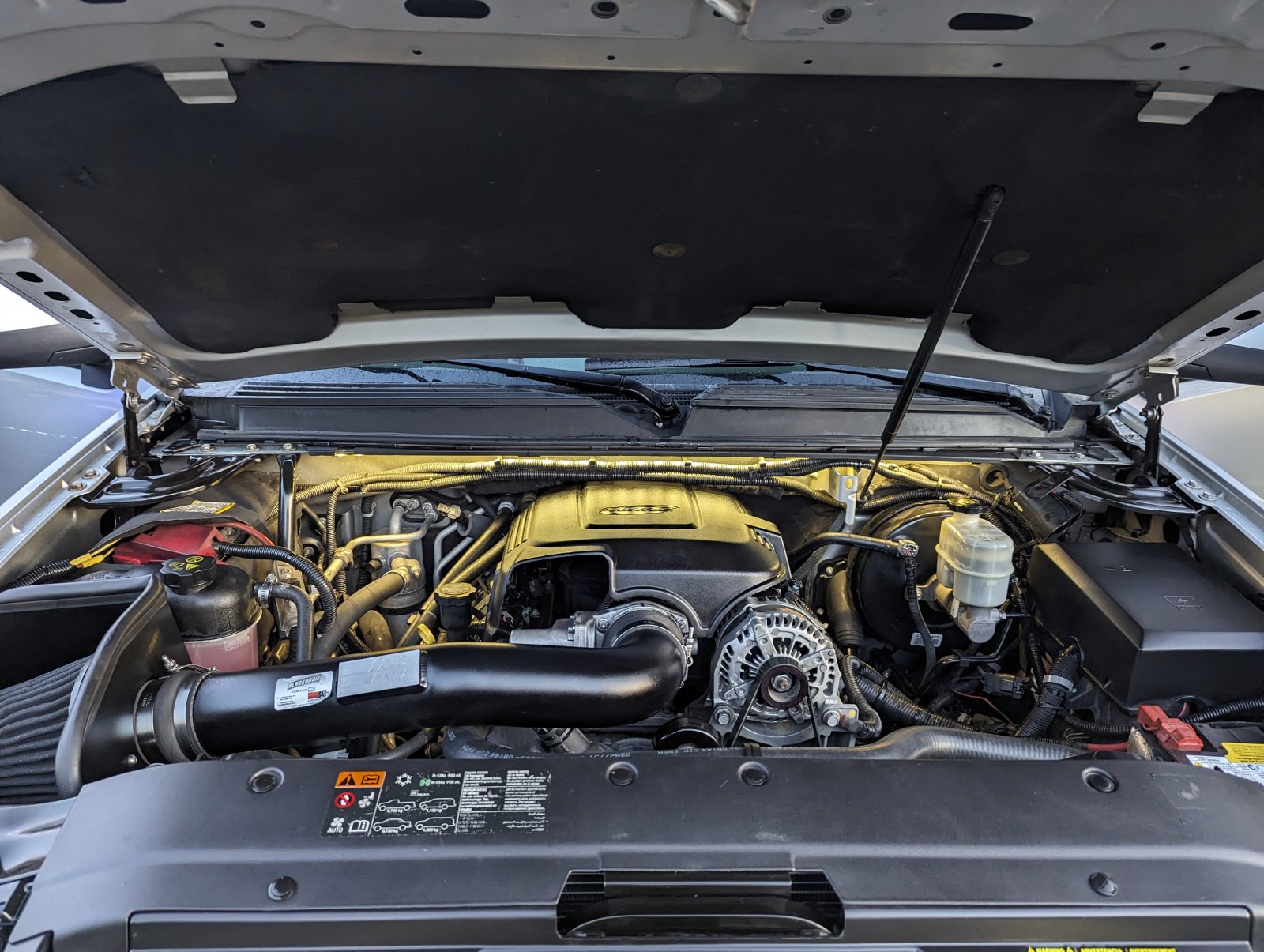

Really like that lighting under the cowl setup there though.

a replacement one is about $230, I guess my fix is good for now lol
you can take it off just be carefull those nipples for the washer fluid hose are pretty small I was just wiping really not near them and they snapped right off from a rag
the vacuum line repair kit worked fine luckily.
