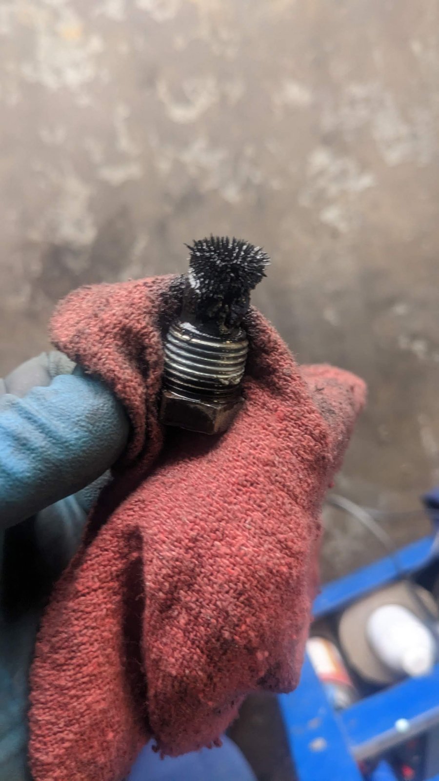

New front diff oil. Squeezed in some Lucas 80w-90, after draining the old gunk out, and cleaning the magnet off. Lots of sparkles, which pretty much confirms that the whining is the bearings failing, but which bearings?
There was at least an 1/8" of schmutz on the magnet.
j91z28d1
Feb 28, 2022
4,611
5,864
this was my rear diff when I got it.. with 130 something on it. dead quiet still but it does seem like a lot.
this was my diff
I didn't take any of the front, but it was ugly too. so far thou no side effects from it. so it doesn't always mean it needs rebuilt, but if you got whining. yeah blah.

Your front looks like actual metal shavings, whereas mine looked like sparkling bearing flakes (ground up mica).
j91z28d1
Feb 28, 2022
4,611
5,864
Less than two years, only using Auto or 4Hi occasionally, even in the winter. Waaaay less than 20,000 miles.
ahh yeah 20k you probably got something eating itself.. if it was the first time it had been done with 100k plus on it. it would be expected.
probably time for full set of bearings and hope the gear looks ok?

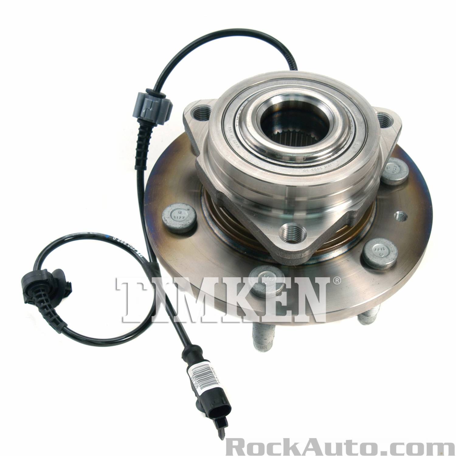

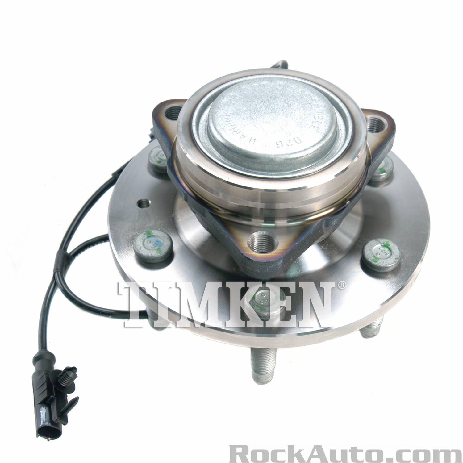

RWD GMT900s use different front hub assemblies. The 4WD front hubs utilize the front axle /CV stub and nut to keep the bearings together. I suppose if I could find some worn out 4wd front C/Vs, and rip them apart to use just the stub to hold the front together while the diff is getting R&R'd it would keep my front wheels from detaching at highway speeds.
RWD front hub assembly:
4WD front hub assembly:
View attachment 422312View attachment 422313
That is exactly what I did with the old CV's I removed/replaced. I disassembled them and saved those stub shafts/nuts just for this.

Not sure, but I'm not about to be "that guy". I suppose they manufacture two different designs for a reason.
And it would be weird that the axle nut torque spec. is like 188lb./ft., which seems like an awful lot to squeeze the outer C/V into the hub if it didn't do anything.
I've been doing some Googling, and seen both answers: does nothing and can run 4wd hubs without axles with no problems, or tempting fate by not having them installed. If I can find dead axles and chop the stubs off I might as well throw them in for that hypothetical situation.
