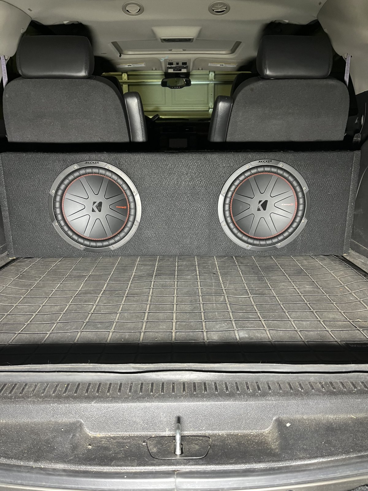

The Kicker amp I bought in Florida is WAY too much power for that Alpine 10". Like, more than three times the RMS. Tahoe Twin gave me his old sealed dual 12 box he had in his Tahoe so I can finally use those two new Kicker 12s I bought last June. The amp is still almost twice the power these need, even in a sealed box. But that makes it about 2/3 less of a waste, right?
This is temporary until I build the box I want, which will be angled to fit up against the seats, ported and downfire. I just need to look into some of the sciences of it, as I'm considering having the port fire downward as well, with a sloped floor to direct everything outward, like a horn.

a quick easy mode to that box would be to add feet on each end then you could flip it down if you want downfiring

Agreed. The side panels were added cuz he had it in his Envoy but needed the additional 1.5" of width to fit snug in the Tahoe. I could pull those off and cut out some that are longer then flip it. I doubt he'd care if I modded it. It was just a quick throw-in to have something. I really don't like exposed speakers so I might dig out some scraps and flip it.
