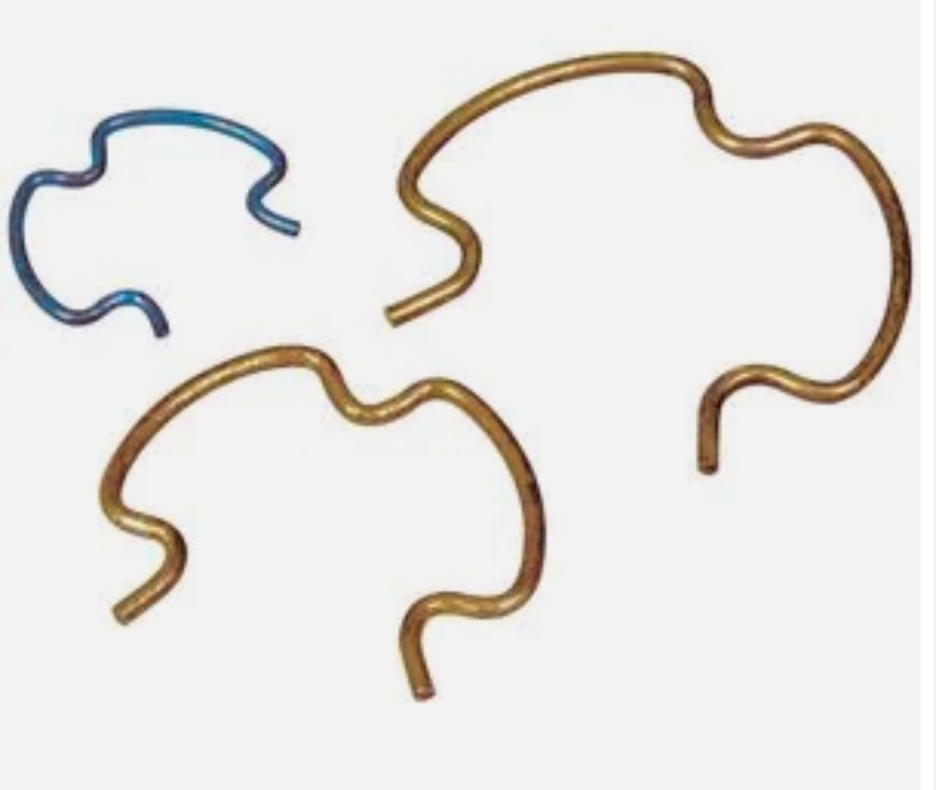

Is there a tool needed to disconnect the cooler lines?
I put a rag over it when I pull the clips with a pick, otherwise you'll never see them again. That said, the new radiator should come with new clips pre-installed. Then all you have to do is press the barbed lines into them until they click. Easy peasy.
Apr 11, 2018
7,124
14,375
St. Louis
There is a tool made to disconnect them, but you can use a pick like mentioned above, or a small eyeglass screwdriver to undo the wire clip from around the fitting. Once off, the line should just pull out. Also watch out for that clip to go flying when removing it.
When assembling, put the wire clip on the fitting first, then just push the line into it and it will "click" when secured.
These are what it looks like

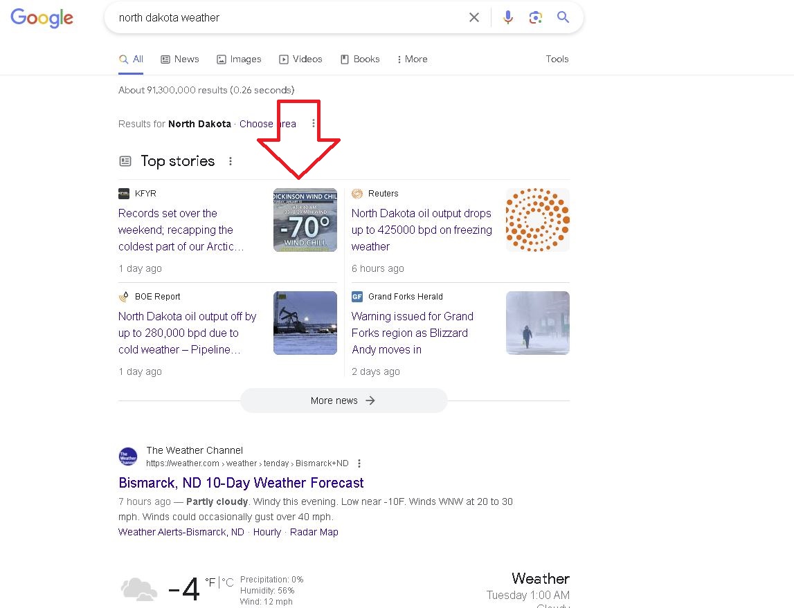

around 1999 Con-Agra gave me a option to go work in North Dakota versus being layed off here in Cali, F-that took my severance and never looked back, lol
That was a good call. I spent several winters in the frozen north of NoDak and Montana as well. One of them was one of the coldest winters on record. I'll see if I can find the pictures of how the wind packed the engine compartment of my old Toyota with snow. The base temperature was -35ºF with a 40 mph wind on top of it. I distinctly remember weather forecasters claiming wind chills of -90ºF in Bowbells, ND, where I was located at the time. Nothing moved without a block heater in that weather unless you left it running all night. Every year, people would die within a few hundred yards of their homes. They'd run off the road or their driveway in a ground blizzard and set out on foot trying to get home. When they never made it, rescuers would find them frozen to death in their own yards. Winter storms there are seriously hazardous.
30,566
48,044
the couple of times I have considered going there once for the con-agra job and researching oil jobs it became a hard no, I like mild weather the cold I can probably deal with somewhat but that wind chill is a no way. I worked one summer up in Alaska which was not bad at all for Salmon season, they wanted me to come back for crab season in the winter that was a hard pass also especially after the boat had caught fire and we were almost going to abandon ship and heard them telling story's of how the end of the ship broke off the previous winter. kind of makes you think twice especially when both inudustries are dangerous already.
