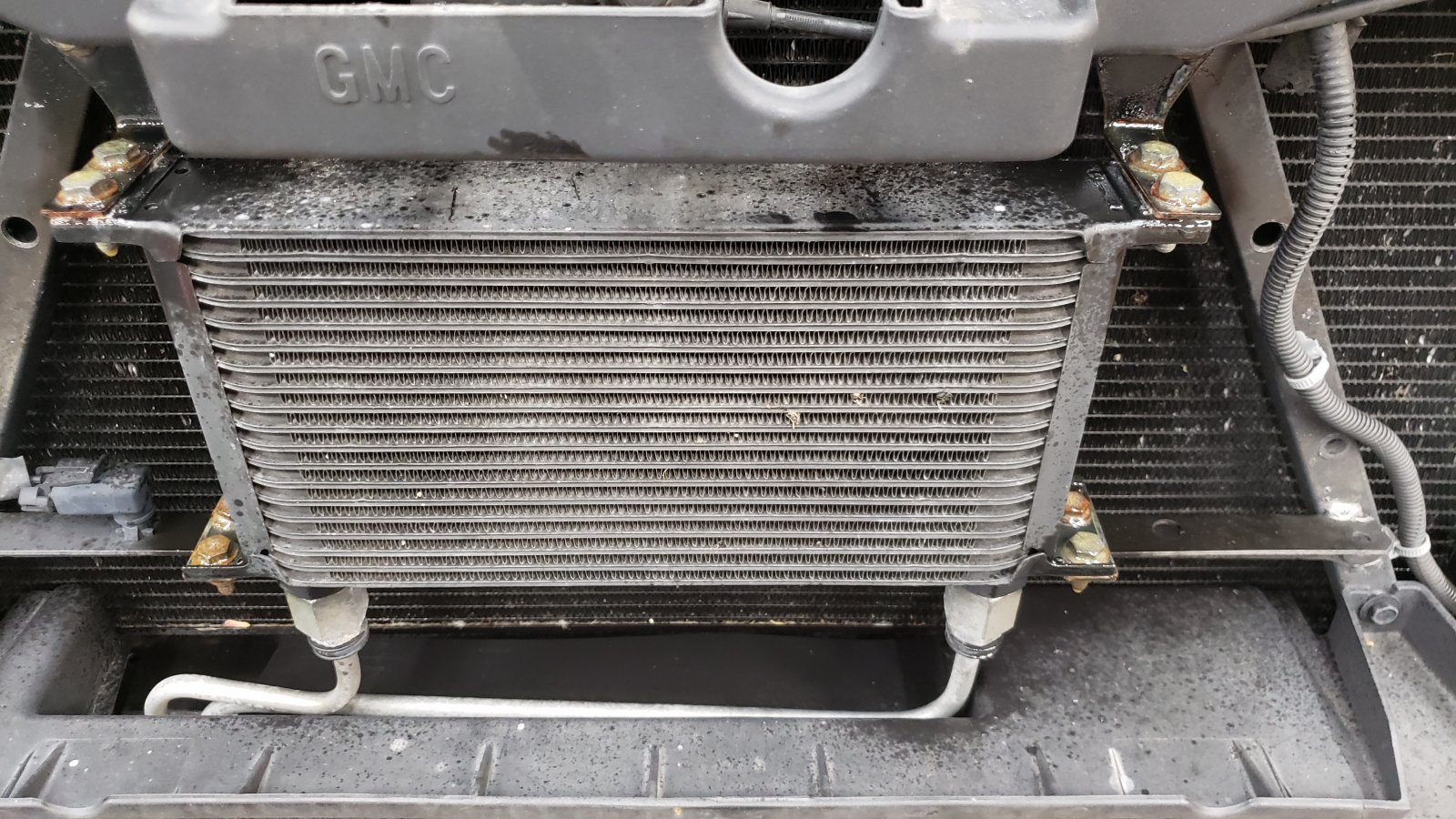

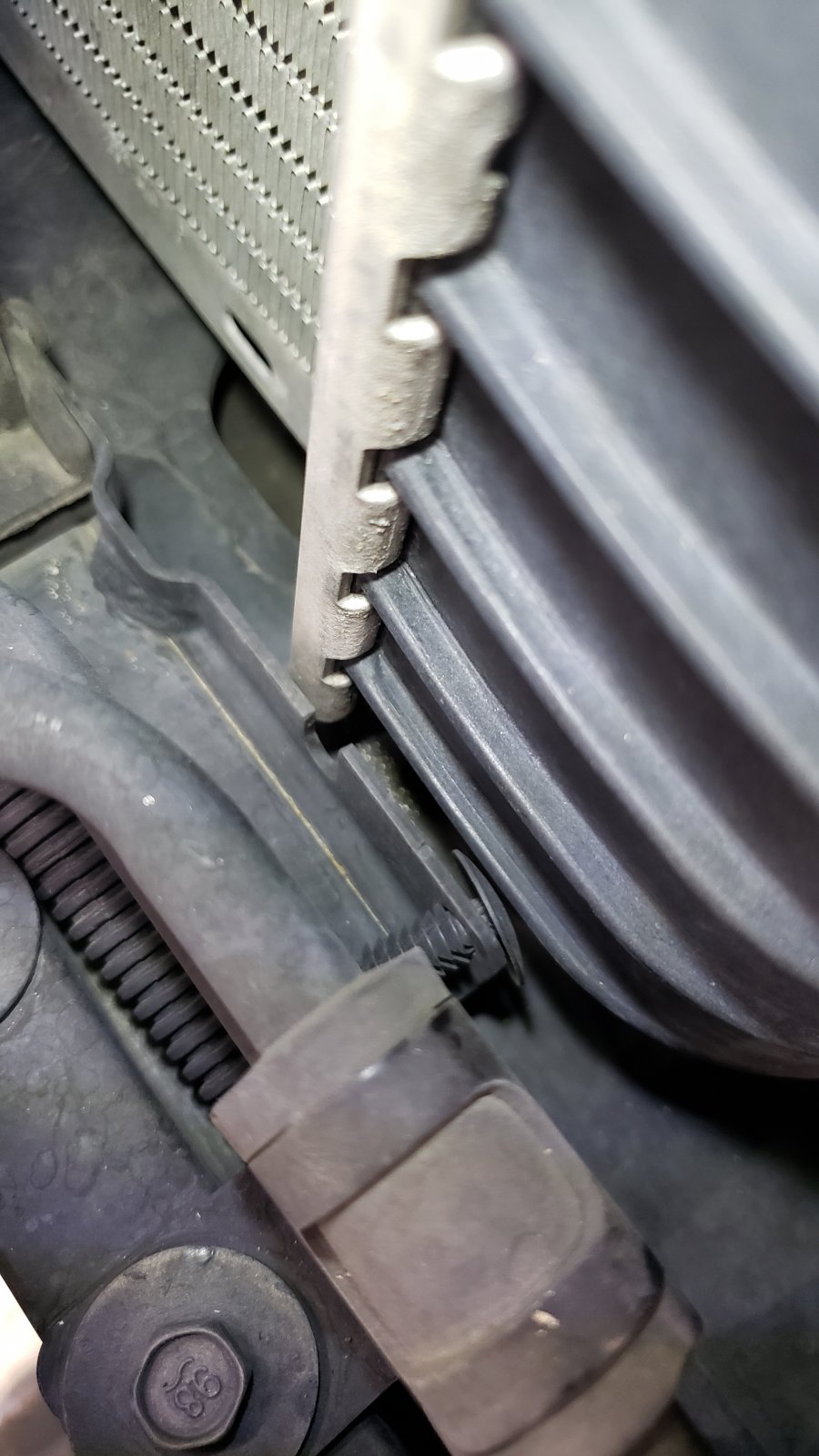

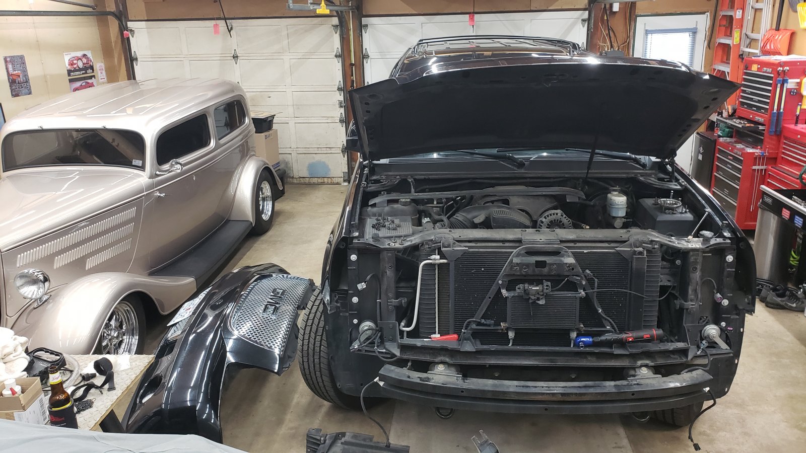

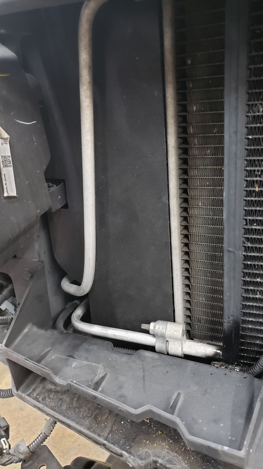

Replacing headlight bulbs. Passenger side is burnt out.
Figured I'd replace the radiator side baffles while I had the front bumper cover off.
What holds the bottom of the radiator? The bottom push fasteners on the baffle are right in front of radiator and I need to get about an inch clearance. The top push fasteners are the same, but I can get enough clearance by loosening the radiator and shroud bolts that are at the top core support.
Have to pull it straight up to get the bottom pins out of the mounts.

I was able to tilt and pull the radiator out enough to get the pushy fasteners installed.
I need to replace the bolts/nuts on the trans cooler mounts with stainless steel or something. They're rusty. I just sprayed them with Surface Shield for now. That's another day.
