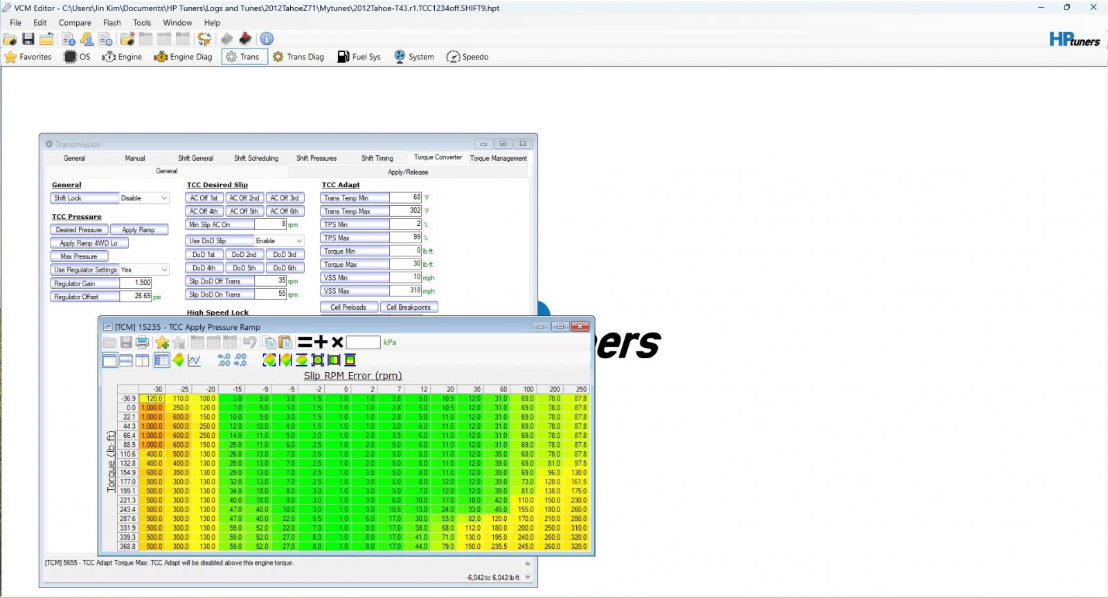

That only made my converter feel "tighter". Drivability was much improved.
I don't know what Mike did when he tuned it. But it went from feeling super loose to damned-near stock after his second round of changes. I'm anxious to actually investigate but have a pile of priorities ahead of even going in the shop.
45,012
There are actually so many settings, you can have it hold really tight but still have it engaged and disengage smoothly.
Yeah? How does one make the TCC engage smoothly? I thought that was the point of it being a PWM-controlled style. Maybe it's the nature of the beast or maybe I got a faulty converter. But, mine has always locked up abruptly. It's like cruising at a steady speed in a car with a manual trans while riding the clutch just enough to have it slip and raise RPM, then suddenly dumping it. Not violent, but much faster and more harsh than I think it should. I see all kinds of settings for WHEN the TCC engages, but nothing for adjusting HOW it engages.
Mine has a noticeable lock up but it's not violent. Just a solid "lock". I'm used to that from driving my Camaro for years though

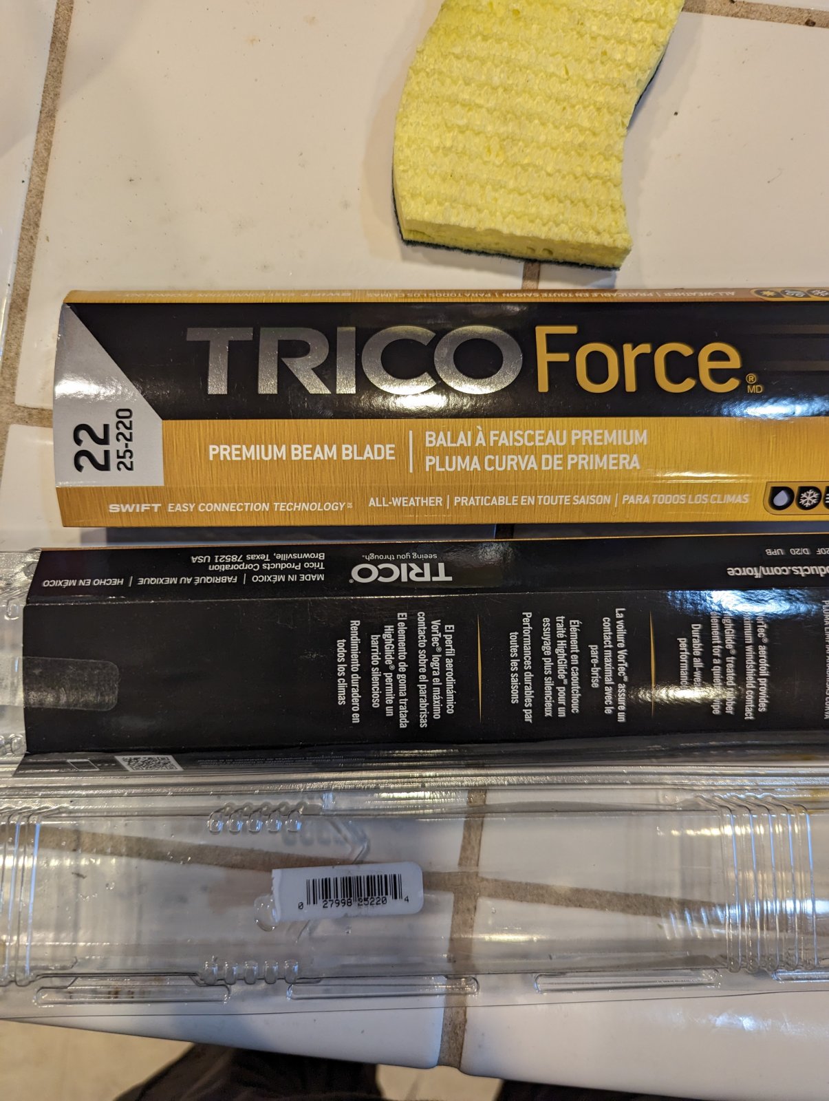

New 140mph blades and a new rear passenger window switch
it's amazing how much they want for wipers these days. I walked in once to get some on the ride home on my car that has 24in wipers. I was in shock when 2 would be 50$. they said it's a dollar an inch these days. I drove home with bad wipers lol.
if you have the kind you can pop off the end, like most oem blades. I've found you can still buy the rubber itself super cheap off ebay. like 3 sets for 5$ shipped. just take a month to ship, so buy like 20$ a year worth. they look identical to the rubber in auto parts store blades. work great and I find myself swapping them much more often because of the price. so they work better for me lol. I have 4 cars to keep blades fresh on and tx sun to eat them up in no time and then random violent storms out of nowhere to drive thru.

I could take a video, but all you'd see is the tach sharply drop. Maybe even hear the engine's hum change. Can't convey the sudden "bog" feeling when it locks.
That's how they work, at least both of mine. It's not violent in the way of slamming, it's just sudden lock and unlock. As per a super smart man meats, aftermarket toque converters don't like to ramp in the lock up. They need to either lock or unlock. None of the easing into it
Amazon also has them as well.
For the record, I've only replaced the rubber part on Stephs accord and my Yukon with oem pieces since they were new. They aren't more than $20 for both sides and the oem "wiper" assembly is nicer than the replacement parts. The Honda is cheaper than gm but that's to be expected
