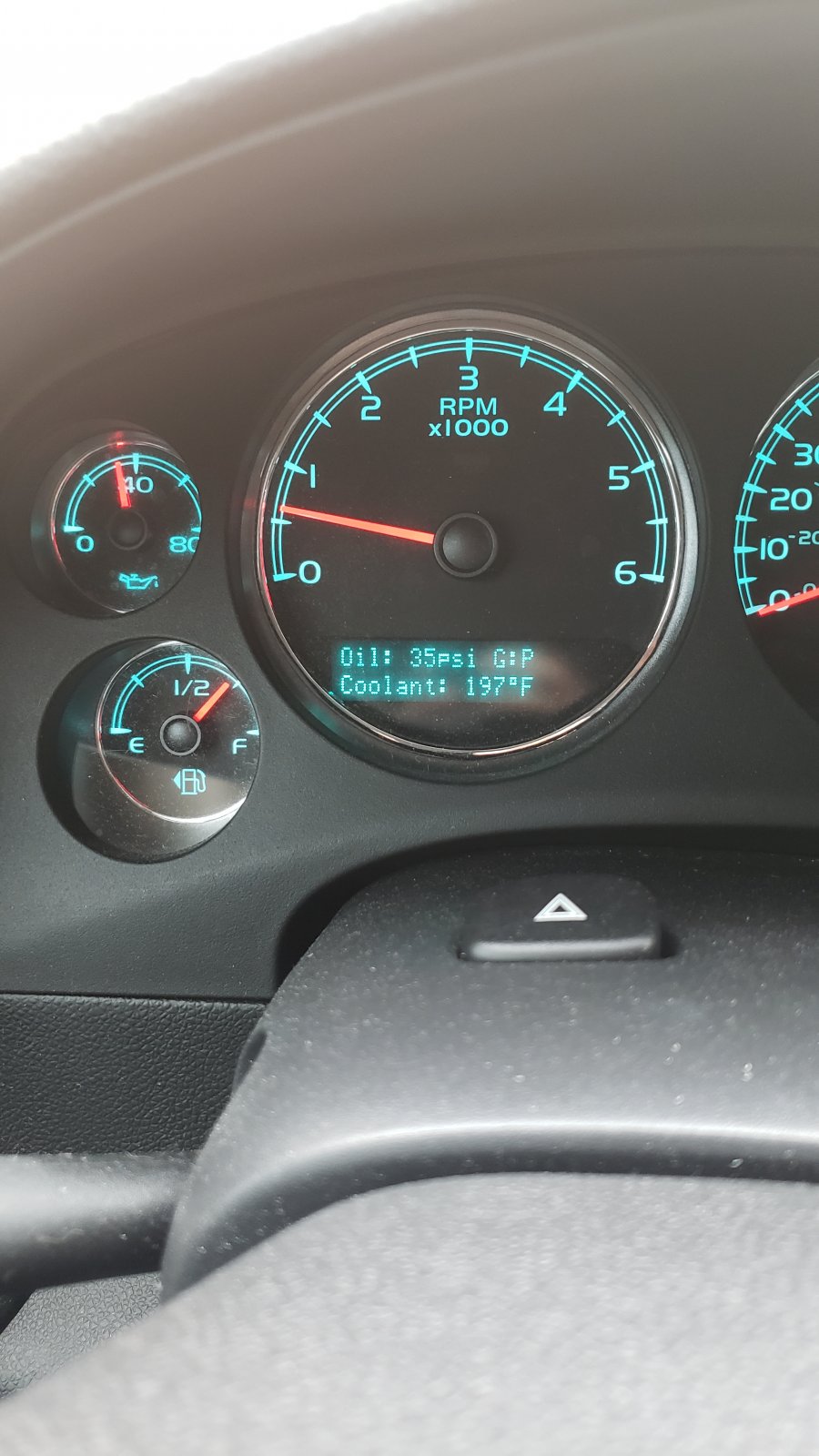

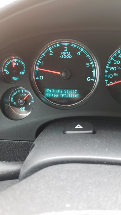

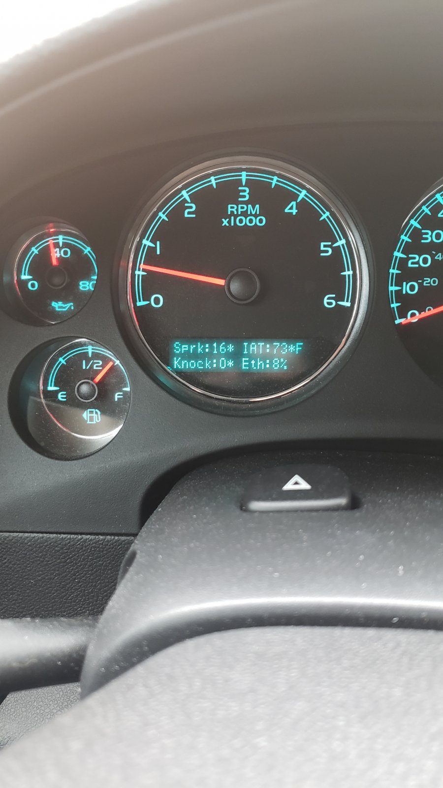

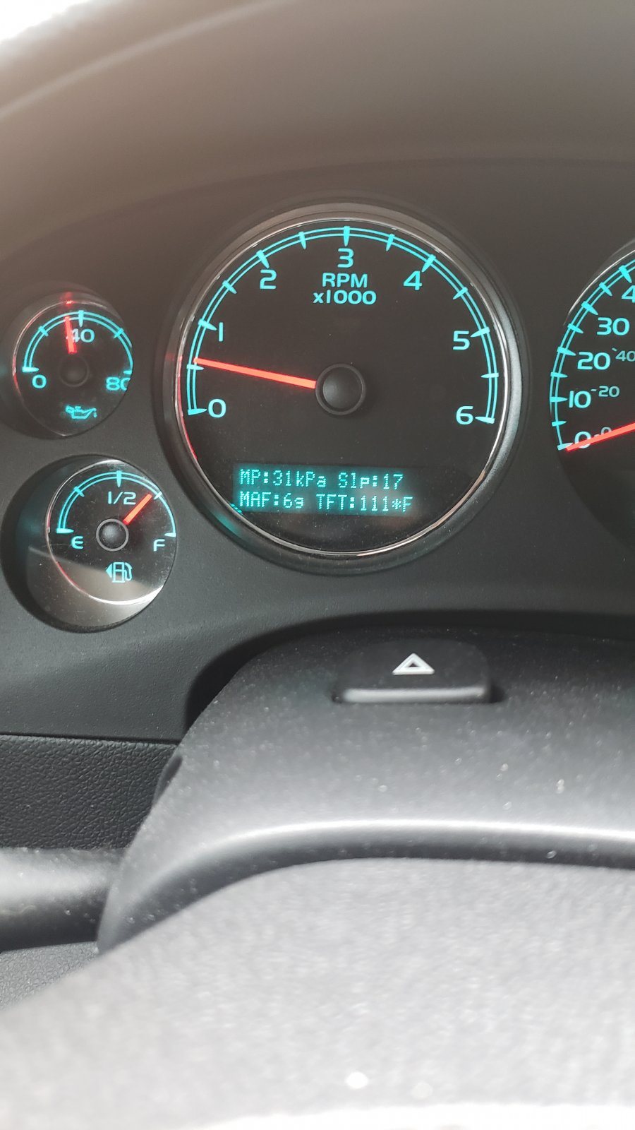

Like everything, they've gone up in price.
Here is my DIC showing Manifold Pressure, Converter Slip, Mass Airflow, and Trans temp...
Here's a pic of the DIC showing Spark timing, Knock Retard, Inlet Air Temp, and Ethanol %
And a pic of the DIC showing Oil Pressure, Trans Gear, and Coolant Temp

Yes, small dongle that stays plugged into the OBD port. I use one of their splitter cables that replaces the original OBD port and have the AutoSync tucked up hidden under the dash.
The AutoSync also gives one touch down on back windows and one touch up on drivers window. You can set the power fold mirrors to auto fold when vehicle is shutoff, can roll up/down windows or fold/unfold mirrors from the remote fob, and can set the TPMS warning pressure to anything between 24-79psi or disable the system all together. Can set the backup camera to come on for a few seconds whenever you use the turn signal. Also view and clear trouble codes through the DIC.
There's a few other things also I can't think of off the top of my head right now.

Wow! Your DIC just spews it all. Mine isn't nearly as forthcoming.
