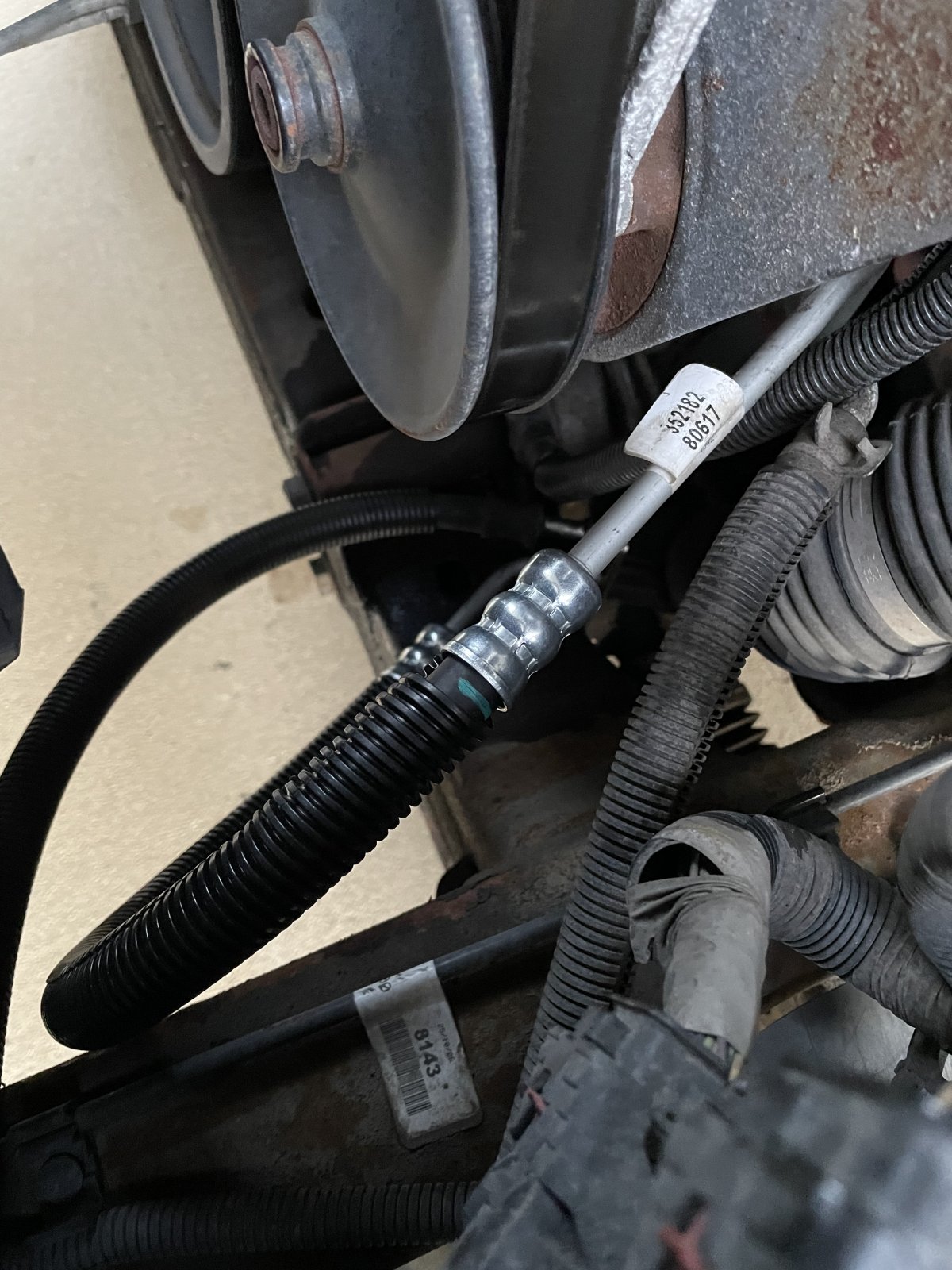

Replaced the power steering pressure hose in the 2007 this afternoon. The old one was leaking bad enough to leave a perpetually wet patch on the frame crossmember beneath it, and the reservoir needed topping up every few weeks. $55 at Autozone plus a little more than a half a quart of fluid, and I’m back in business.
One of the best things about these trucks is how widely available parts for them are.

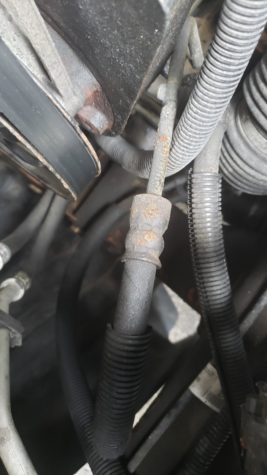

I need to replace that hose on mine. It's not leaking, but it's rusty as hell, especially behind the pump. Actually, it my be seeping a bit, because the metal tubing behind the pump is wet.

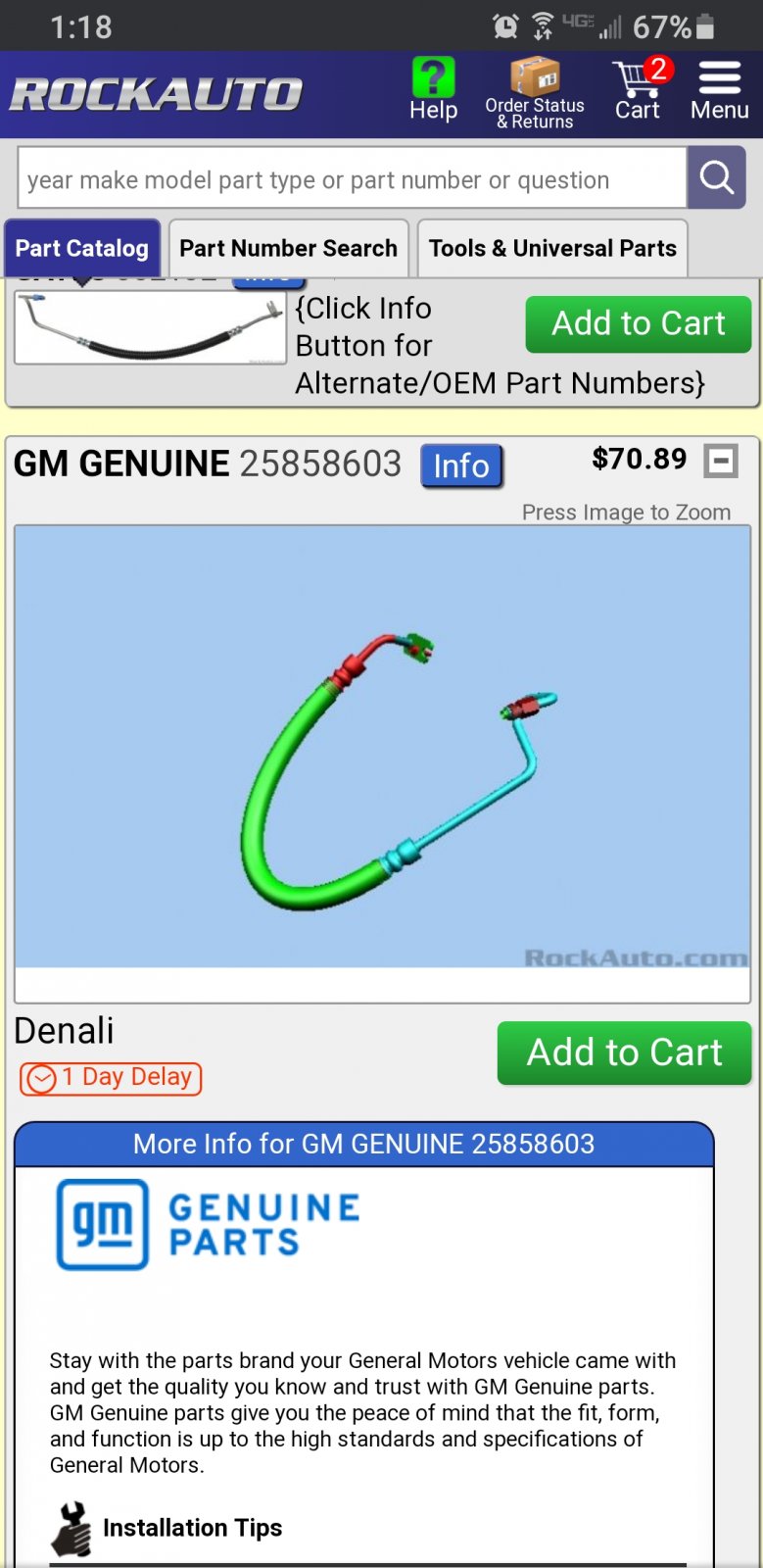

I'm guessing this is the correct hose?

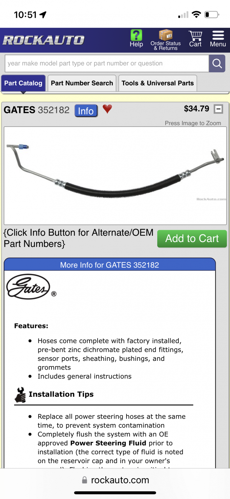

No sir. This one. I saw the GM ones on rock auto as well, and both of them are erroneous or for another spot in the power steering system. The one in the image below is the one you want.
