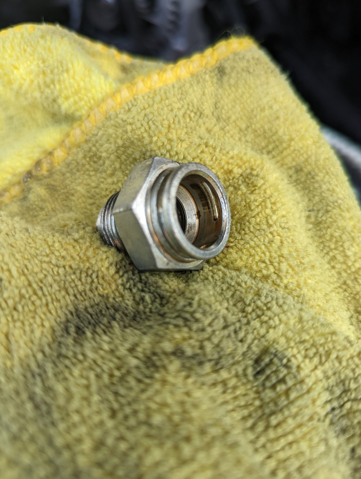

ever since I returned the cold case radiator and put my old one back in this little bastard has been slowly spitting oil at me, I thought maybe the line was just not seated right so I adjusted and it stopped for a minute then it was sweating again and I noticed the c clip wasn't on right so I messed with again and it just spit more oil out so I put a dorman one on I think the o-ring was just done for. I just took a couple runs up and down the road @120 and it's still bone dry now so hopefully that was it I am going for a long road trip for the next 2-3 weeks last thing I need is a leak.

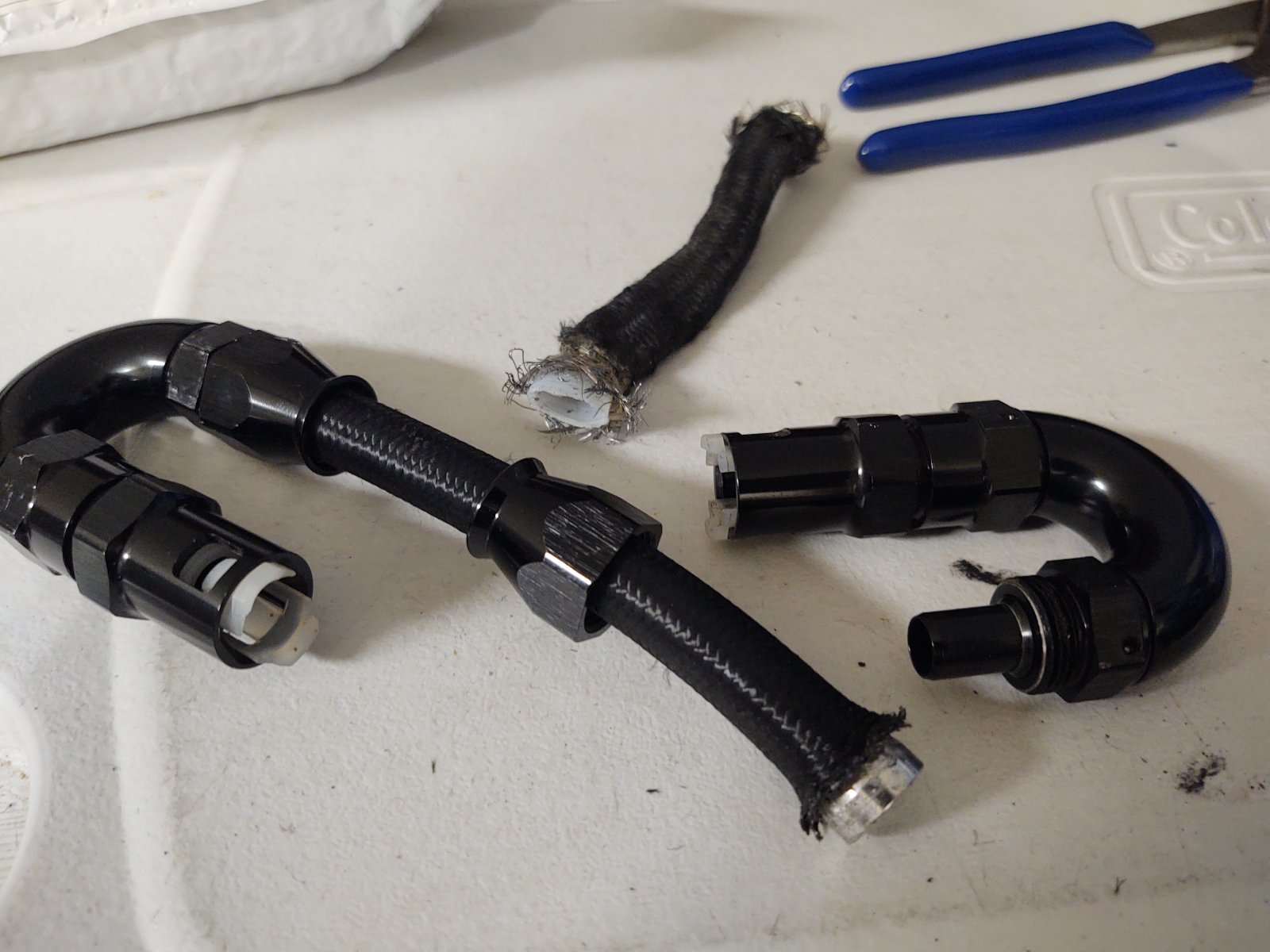

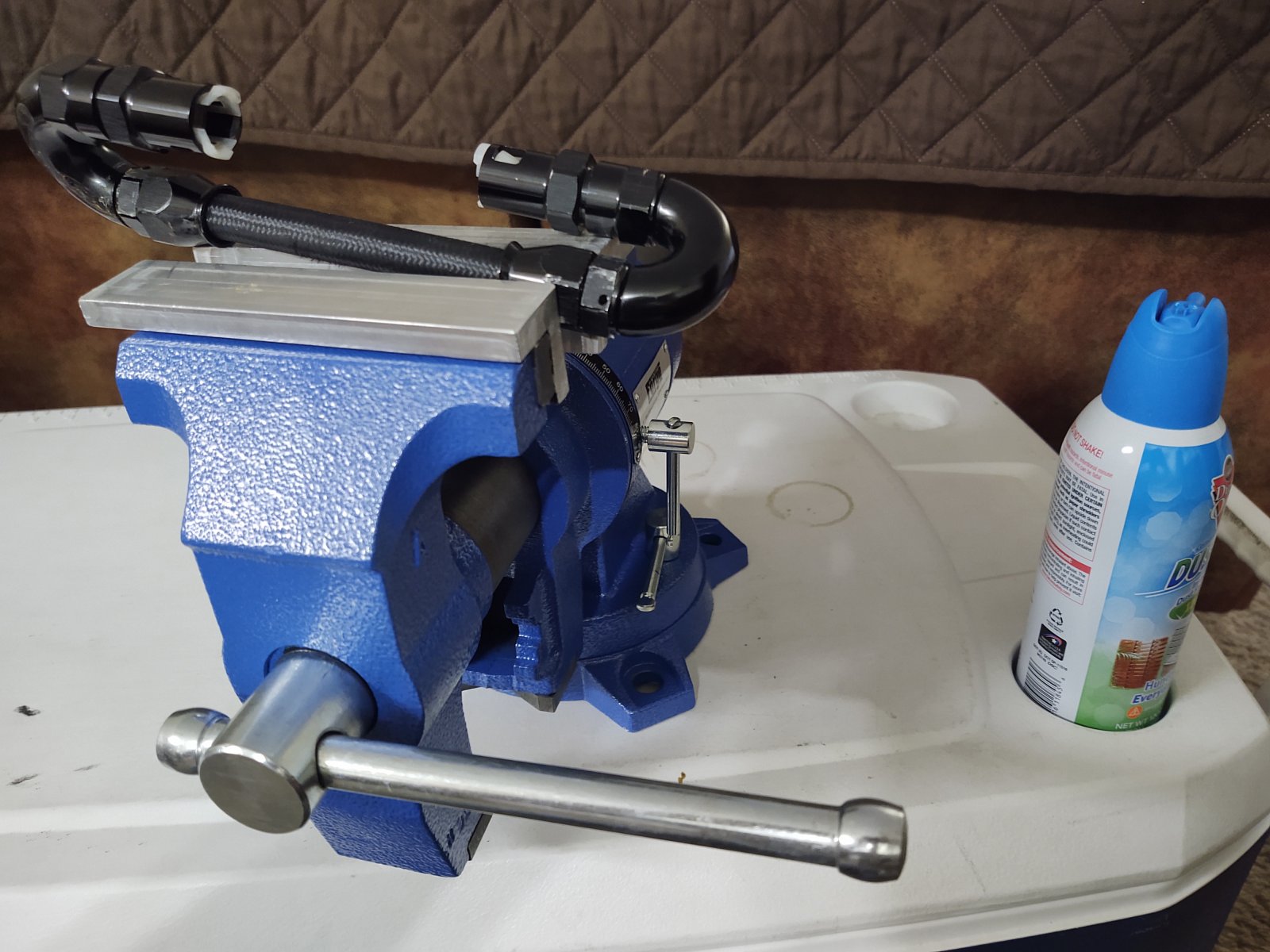

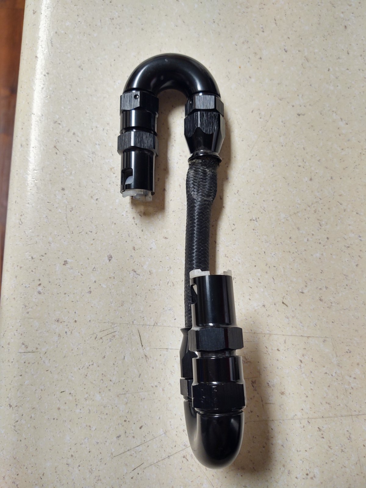

Well, I finally went and rebuilt my flex fuel line adapter.
Didn't put it on yet.
But tried to do some tuning without it, and no matter what I did it was commanding like, 10.3afr. realized that was due to the virtual sensor failing and reading incorrectly, and then even when I updated the tune and told it there's a physical sensor, (despite not having it connected), it was reading zero but still apparently throwing an error and telling it to run super rich ...
So I'm going to try and redo all that testing once I put the physical sensor back in and really see what it does.
I should have known something was up when I saw the stock tune running as rich as it was. I don't remember ever seeing those numbers previously.
In other news, the trans has finally gotten real close to what it was previously. Starting to feel real good and firm again. Haven't retuned the trans, just writing calibrations to the E(P)CM.
