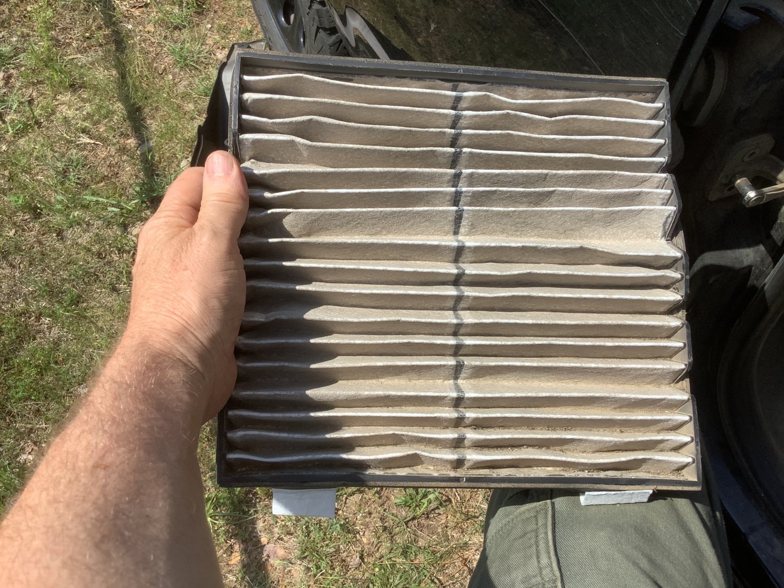

If you put it on heat, do you get the same air flow or is it just on A/C?
It seems to be the same Either way. I’ve not check this before, so no reference, but the rear seems to be going great. engin was warm, so the heat was noticeable. I was feeling heat from the rear coming out more forcefully that from the dash panel vents.

Do you have a cabin air filter? If so, may be blocking flow. If not, could still be a lot of crud blocking that thing in the ductwork down there that is right after where the cabin air filter goes (can't remember the name right now)

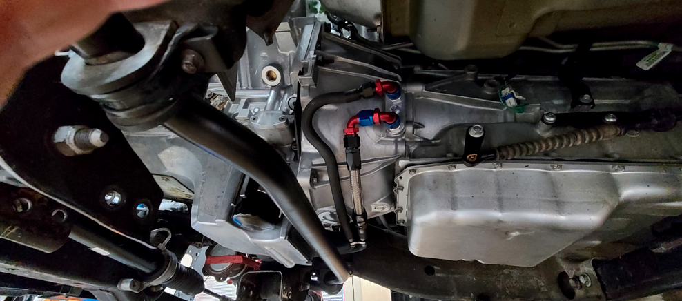

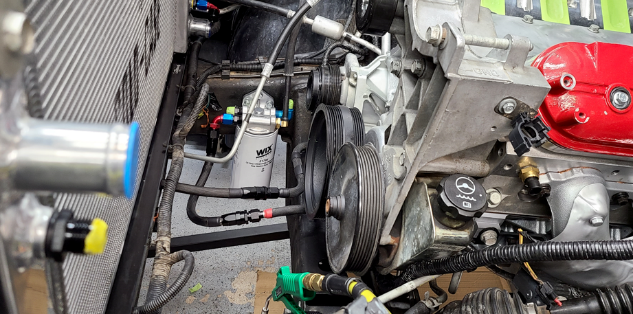

The excitement continues!

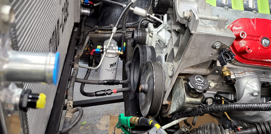

Working to finalize the new -8an transmission cooler lines, mostly just where the front axle needs to be.
Then I can work the front of the hoe to connect the coolers once I have everything else buttoned up.
And I do love the look of the AN lines.
Filter,
Too much line here, the bends ended up a little wider than I had hoped, but it's still good enough for now.

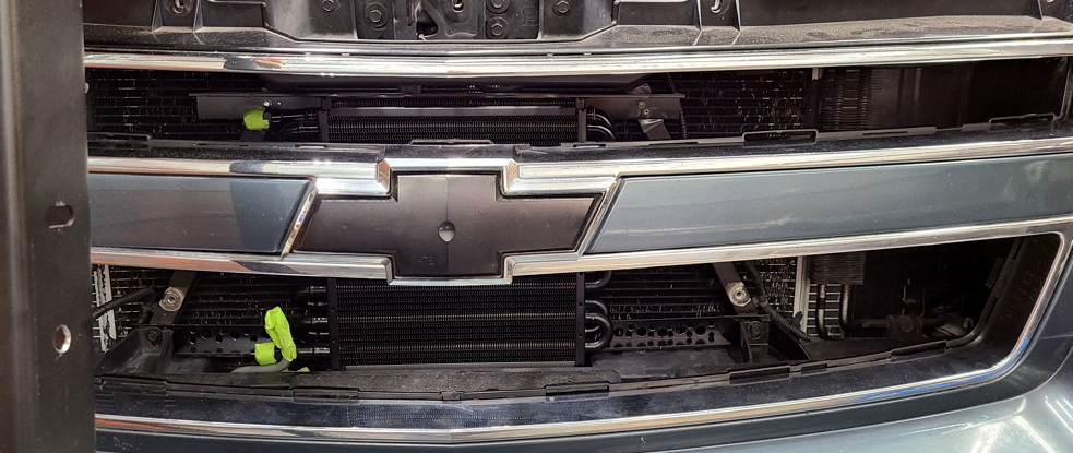

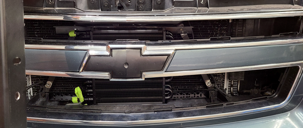

My double pass -8an fluid cooler install.
I used some aluminum angle to make the bracket here.
then I didn't like how much space it blocked, so I went with holes to help it hopefully pass more air.
And then the space that would have blocked airflow on the back has been trimmed down so it won't block airflow.
I didn't bother with the top, small enough I'm not worried about it much.
I'm probably going to re do this now, a flaw in my plan...
the mounting holes at the bottom seem to be for the bumper cover.
I'll see how everything looks once I bolt everything back up, but I think it changed the way the bumper sits... :jester:
Biggest PITA right now,
I want to retain the factory "tow package" cooler.
This will be a parallel cooler install.
I have a control valve for the large cooler, so it's two separate cooling circuits that split off of the filter adapter/base.
The issue, the OEM lines for the factory cooler.
Since I needed to mount the new cooler here, this pushes the factory cooler forward.
So, I either need to drill new holes for the cooler lines or make fresh ones to deal with the position change.
That means I need to order some -6an fittings to deal with it. :nolol:

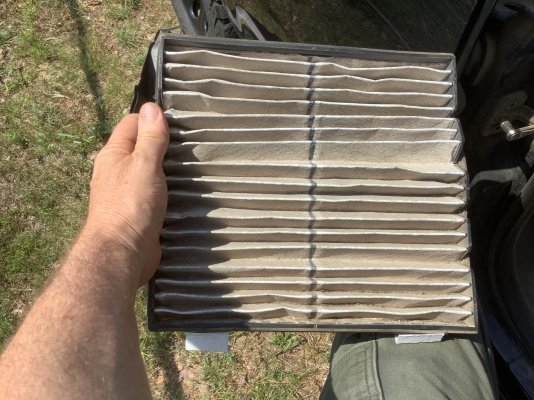

Bingo! It’s been a particularly dusty spring and this is a new feature for me.

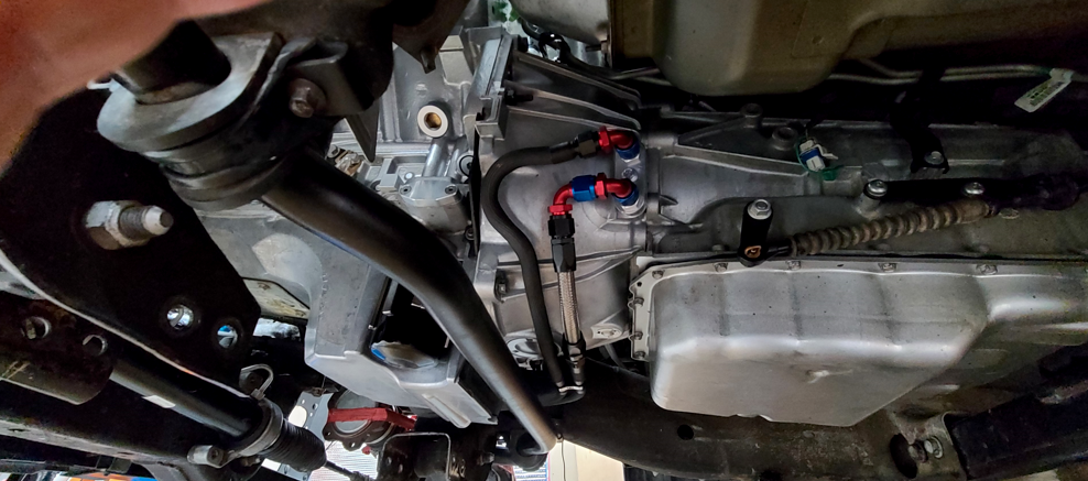

Filter,
It’s pointless to use 2 coolers. One big one is the way to go. :crazy:
Just Fishing
Can't fix stupid
Aug 30, 2020
4,487
10,082
Utah
Not really.
I see the thought process in it, but this is something I researched.
Keep in mind that it hits 110f during the summer, and it's been under -20F during the winter.
Overcooling is a thing.
On my S10, I have a huge transmission cooler.
during the winter I would cover half of that cooler with something, otherwise the transmission fluid never goes over 70f :jester:
Just keep in mind this is just a test, proof of concept really.
Maybe I'll hate it and it won't do what I want.
Maybe it will be the bees knees.
Only one way to find out.
Big thing, I want the lowest possible cooler line pressure possible.
And this is all part of my early "trying to figure out what the fk went wrong" crap.
Now I know what happened.
Two fold.
1: Trash got into the cooler line.
2: machine shop fk'd me and did a shit job with the crank work.
