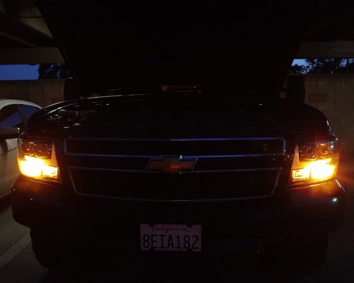

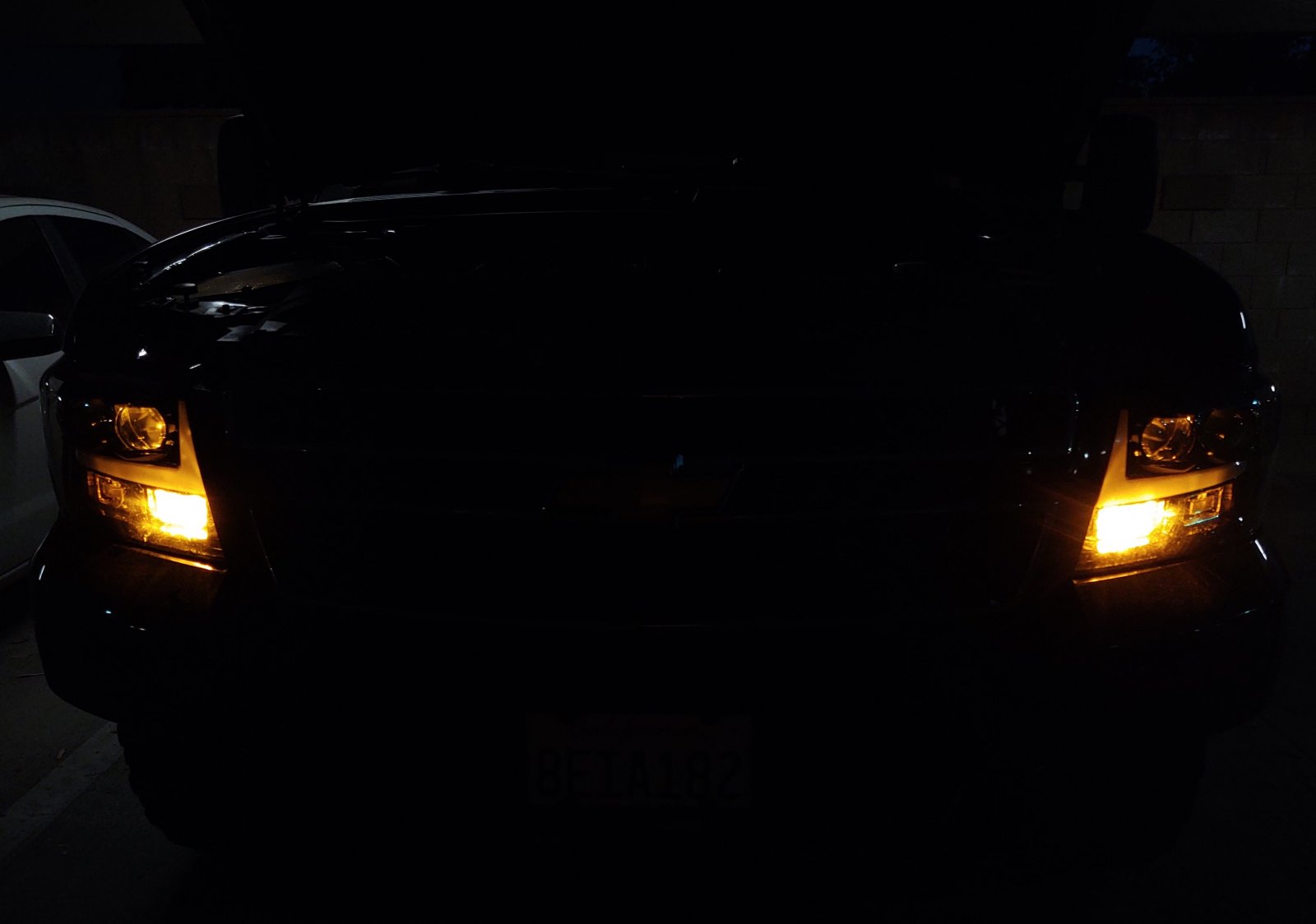

"Present Day"

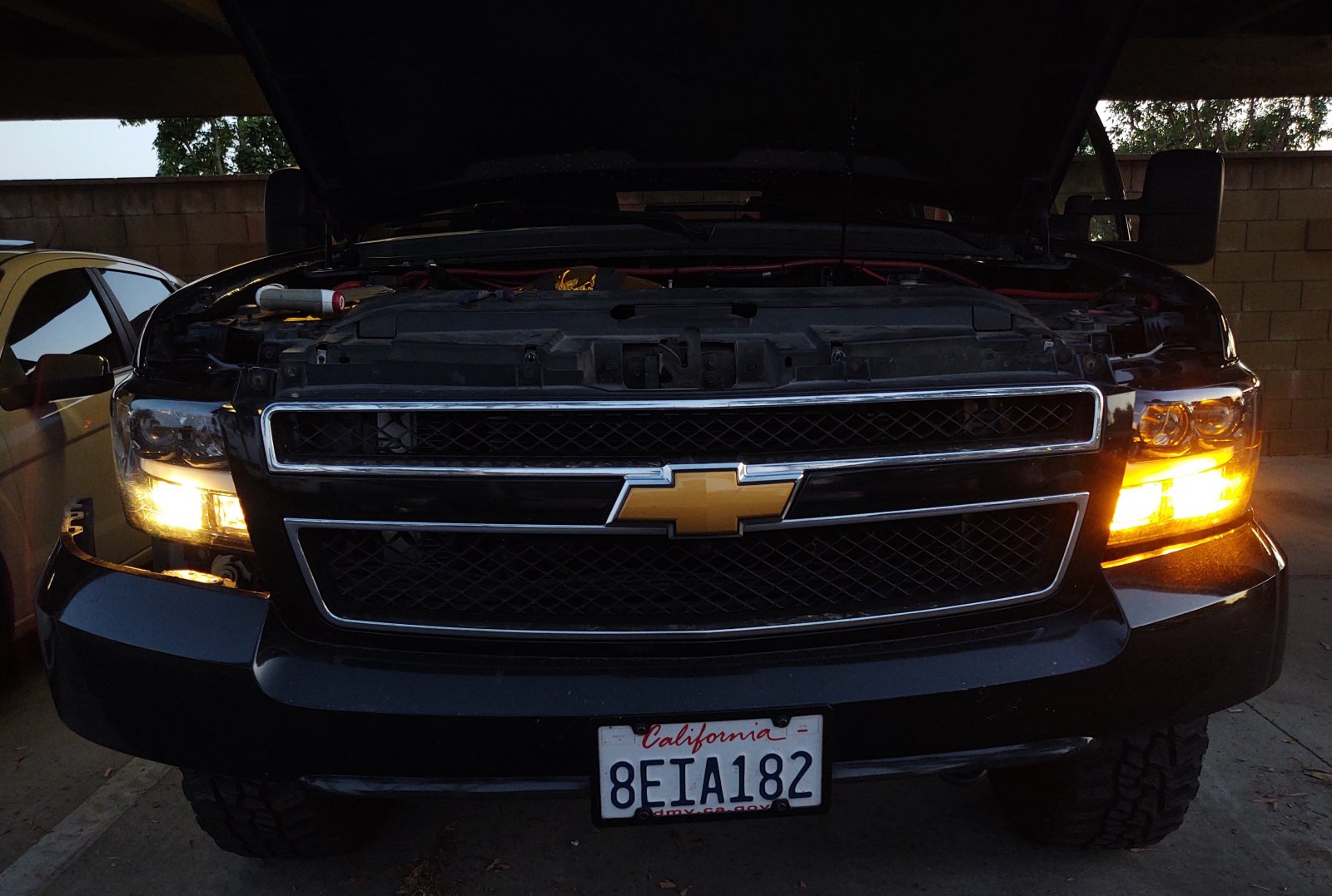

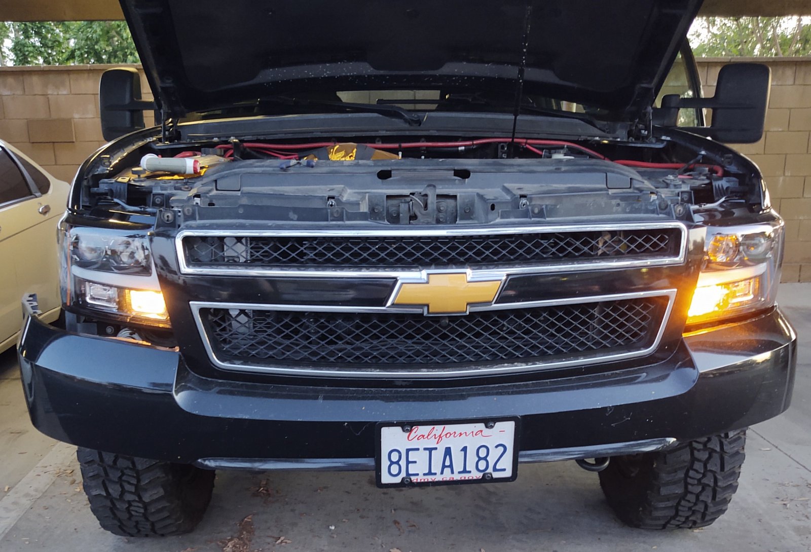

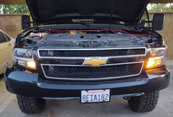

Hold the original white DRL bulbs out of the passenger side, replaced with the new leds. Everything is working and stupidly bright. Which I didn't really need them to be any Rider than the other poles I just wanted LEDs in there for that clean blink and more efficient operation, not to mention typical lifespan.
Just all started months ago when those alpharettes headlights I got had one of the Amber turn signal bulbs burn out within a couple months of installation...
At which point I didn't want to replace with another halogen, and I didn't want to run around with one white and one yellow light by swapping the DRL bulb in the turn signal spot so I swapped both and ran white turn signals in the meantime.
Pics
Side markers and turn signals on, halogen vs LED
" " Side markers
Led side markers
Led all 4 on
Led just hazzards... They're bleeding over in the headlight so much on camera it almost makes it look like the running lights are also on.

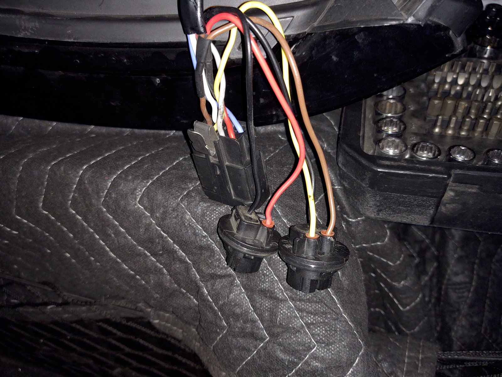

"3 Days Ago"

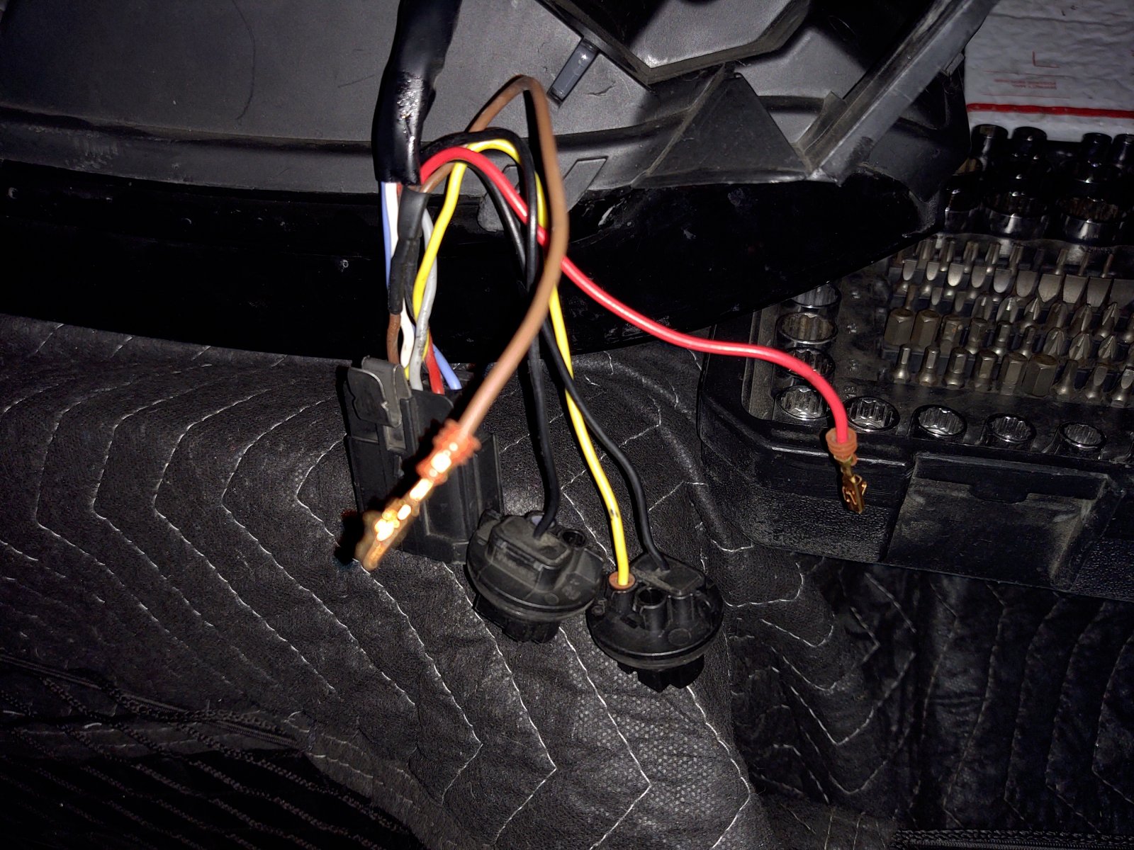

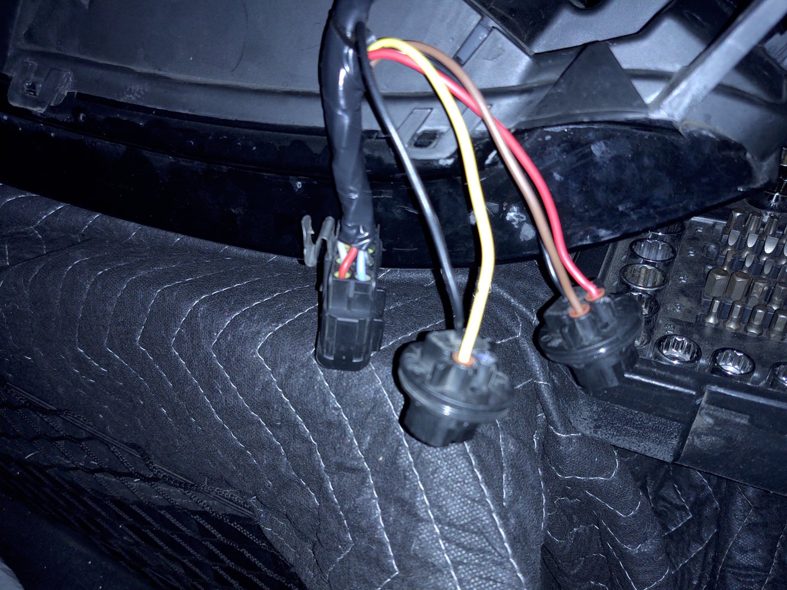

All right, LED saga continues. Tried all different configurations with the resistors and no luck. They must have been screwing with the little module in line with the LEDs I got.
So, took resistors out.
Rewired(re-pinned) so the running light is still in the same spot(inside).
And the turn signal is now the outside bulb. Since I don't have DRLs, might as well make use of the other bulb. Ordered two more of the same LED since the bcm stayed happy as long as only one circuit is powered at a time.
Pics might be slightly confusing because I wasn't paying attention when I did the second light and swapped the wrong wires and that's the one I got picked up. Lol Had to do that one twice.
Originally the black and the brown were together by themselves and that's the DRL which my SSV has turned off in the BCM.
Red wire is the running light so I left that one where it was.
Which makes the yellow one that turn signal so I swapped that with the brown wire that used to be the DRL bulb.

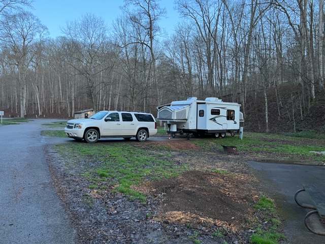

Took the Suburban camping/turkey hunting/fishing. We were failed turkey hunters this year but successful fishermen. Lots of new hunters this year who don't know the old etiquette. They blocked entrances so only one vehicle could get in (setting aside 1000 acres of public land for themselves), tried to stalk turkeys that I was calling in thereby busting the setup, that sort of thing. But it's more about meeting up with old army buddies, work buddies, and hunting buddies, so it was all good.
I had the tow tune and 93 octane for the first time i think while towing the camper. There is a place on the Appalachian Highway where we have to accelerate and merge going up hill. A trucker way behind me moved to the left lane. I am sure he though wtf when I left him way behind. ;)
