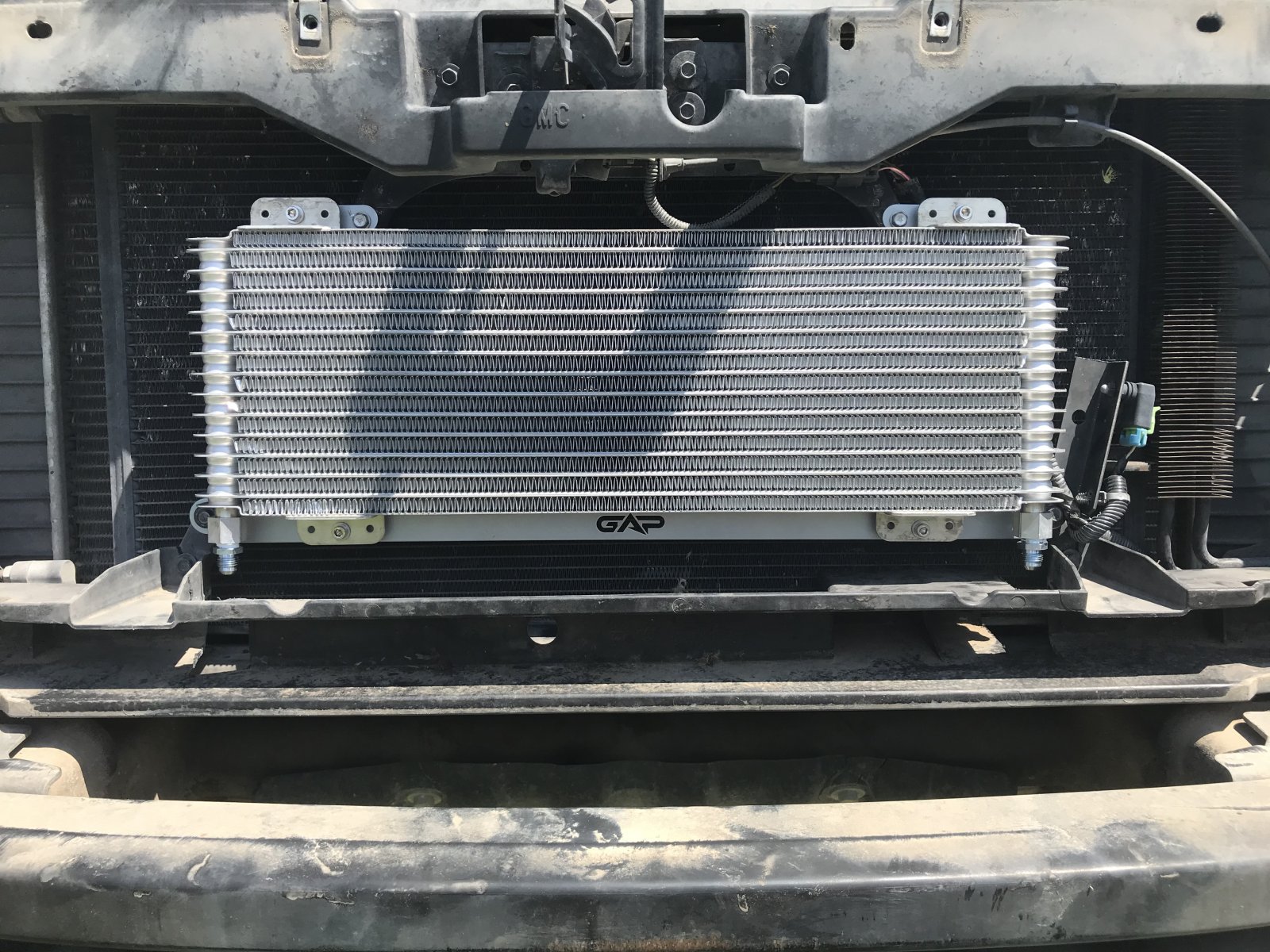

I have the Derale 13960 in my 2012 XL Denali, mounted behind the lower grille which I ventilated carefully to allow airflow to the cooler.
That looks like a nice one.
Those derale coolers could in theory, be mounted anywhere.
Last night i started measuring the current fluid cooler, and started preparing the new tubing.
I noticed i have enough tubing to relocate the cooler to the back of the hoemare if i wanted.
Of course, that would probably get packed with mud and sage brush... lol
26,678
52,942
Yeah, it's big enough to block airflow through the radiator to the point that it causes engine cooling problems if towing heavy in anything above about 70ºF ambient temps. At least when there's a 6.2 behind it anyway.
Especially considering there’s also an AC condenser between that and the radiator. I have an intercooler too which is bigger than that TruCool, and I installed their next size down in a lower location behind the bumper. There’s only so much you can cool down.

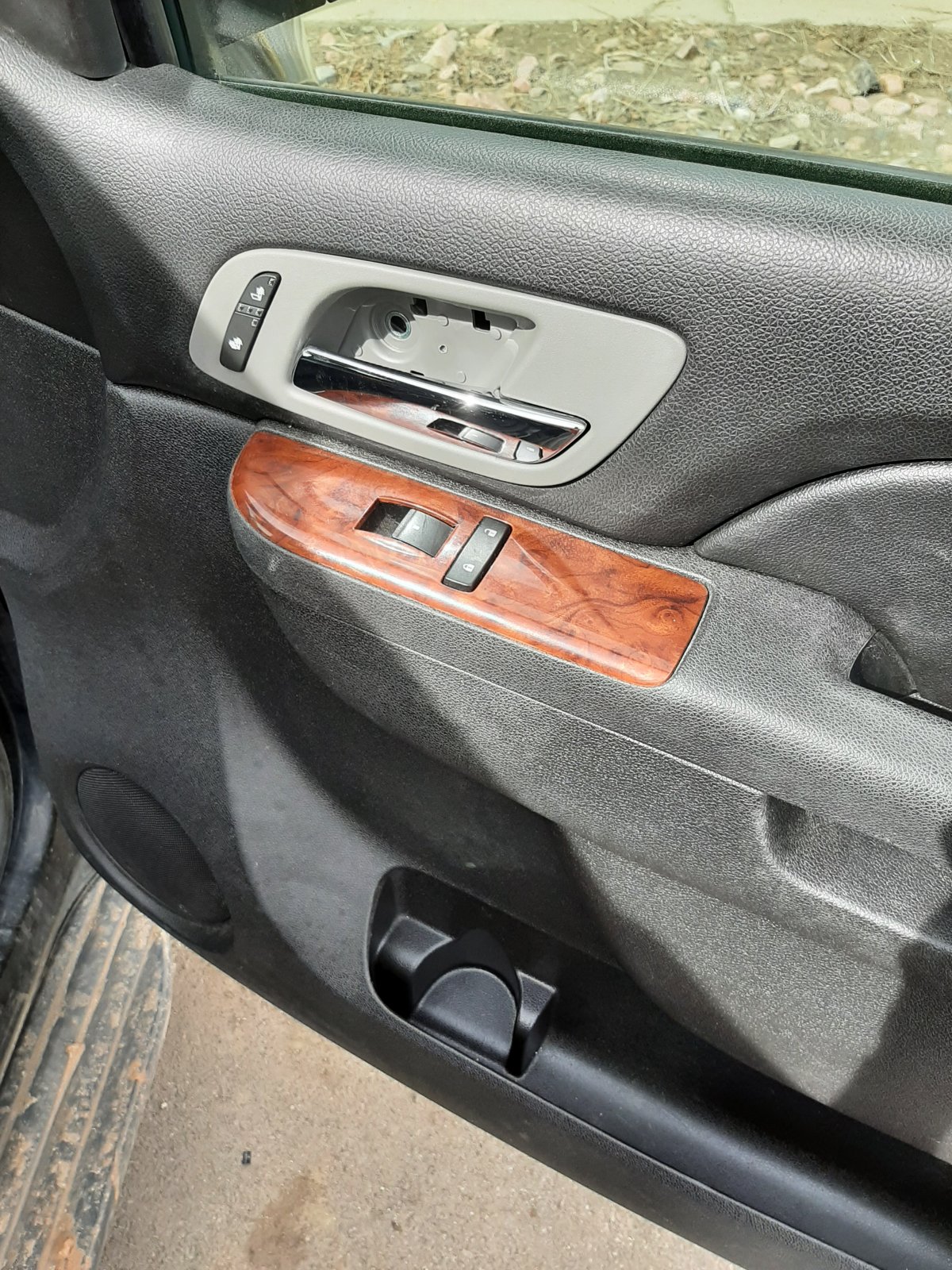

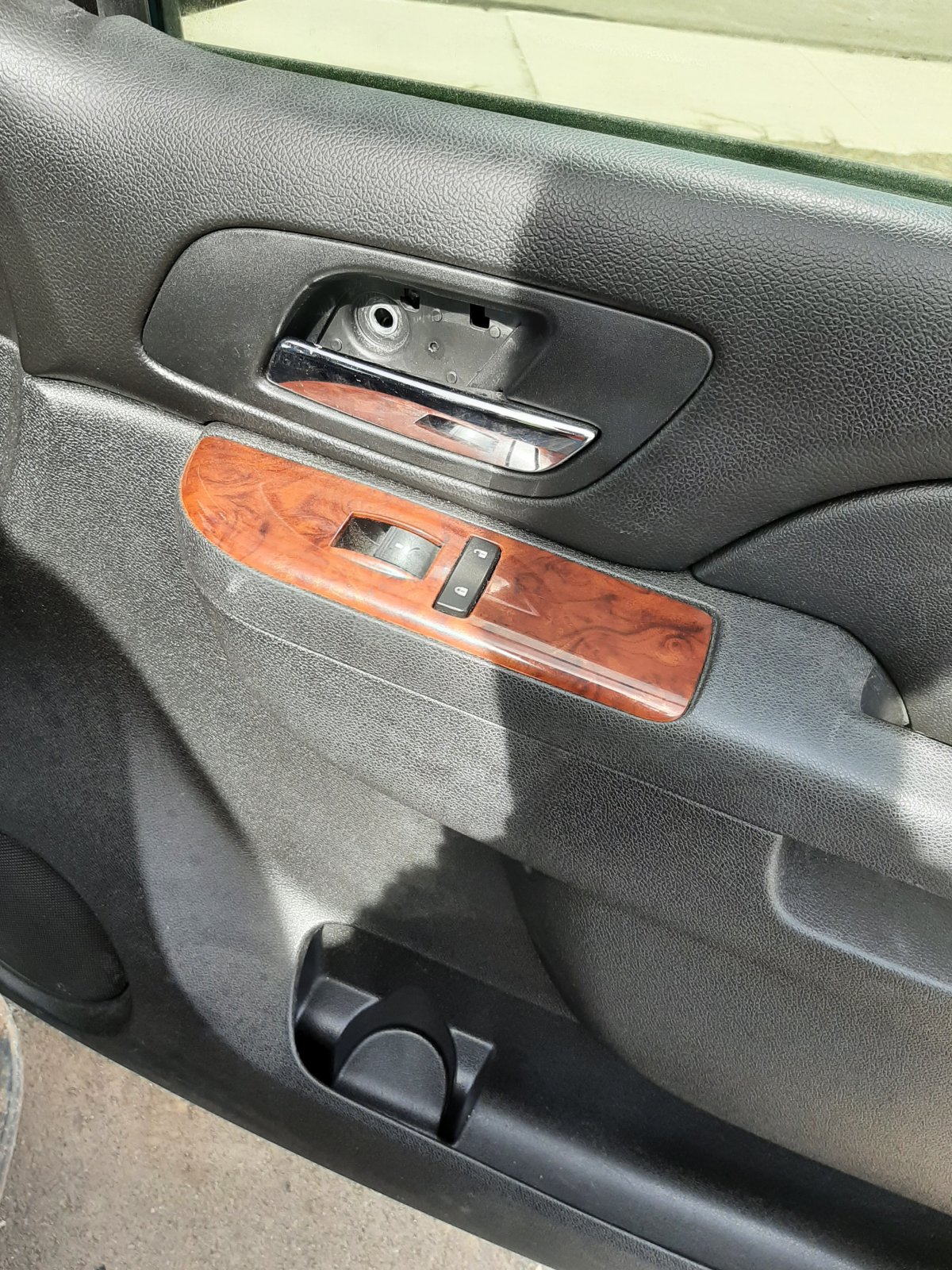

What do guys think of the titanium heated seat door pull in place of the black ones I like them gives the door panels more ancient
Did you paint them or are they OEM? Need the filler piece before making judgment.
