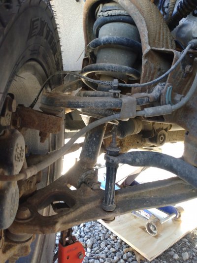

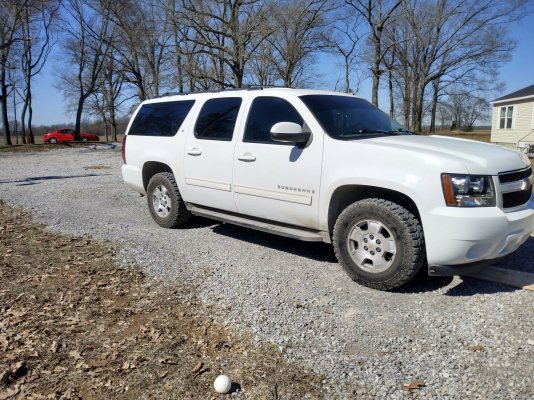

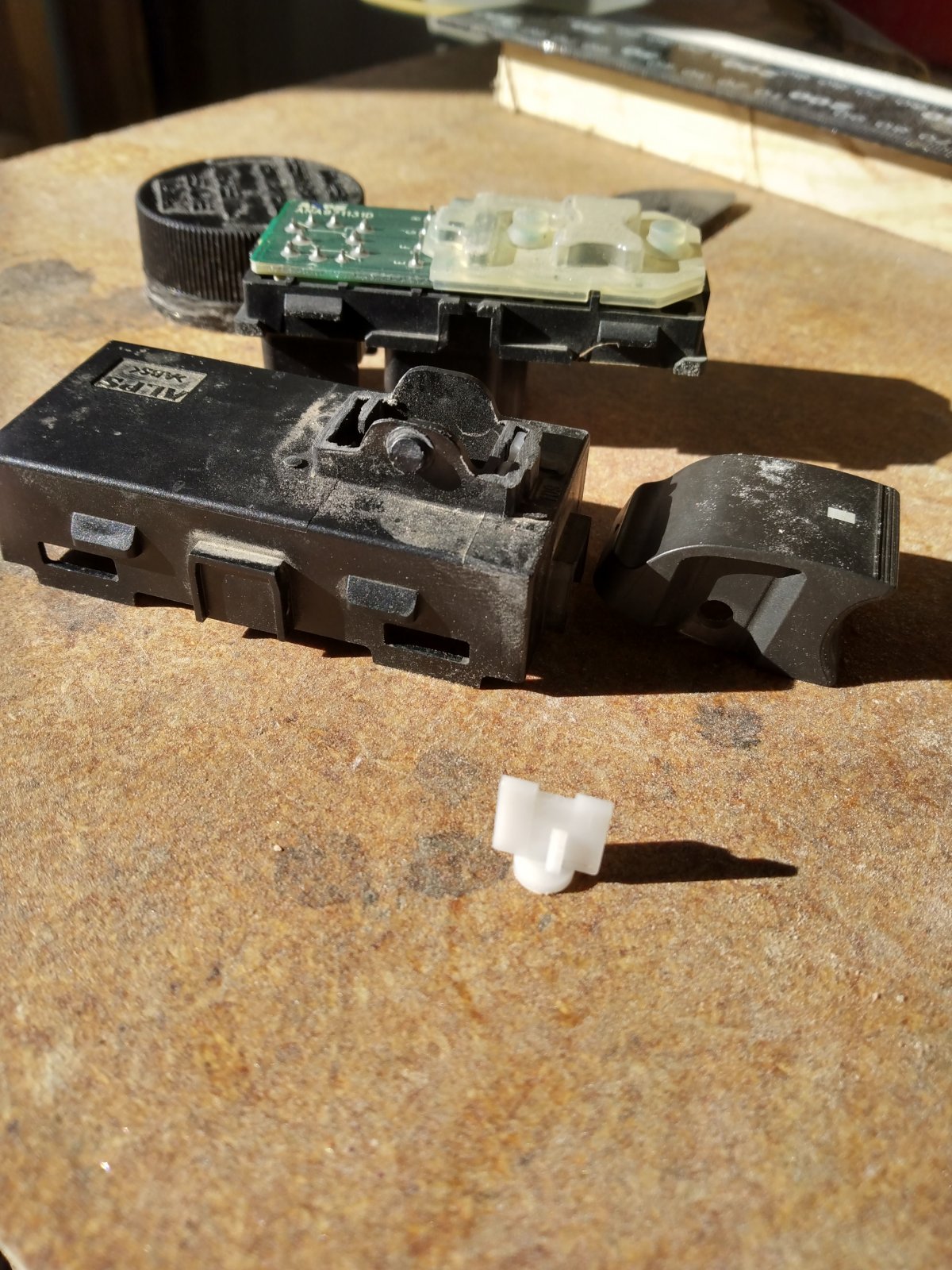

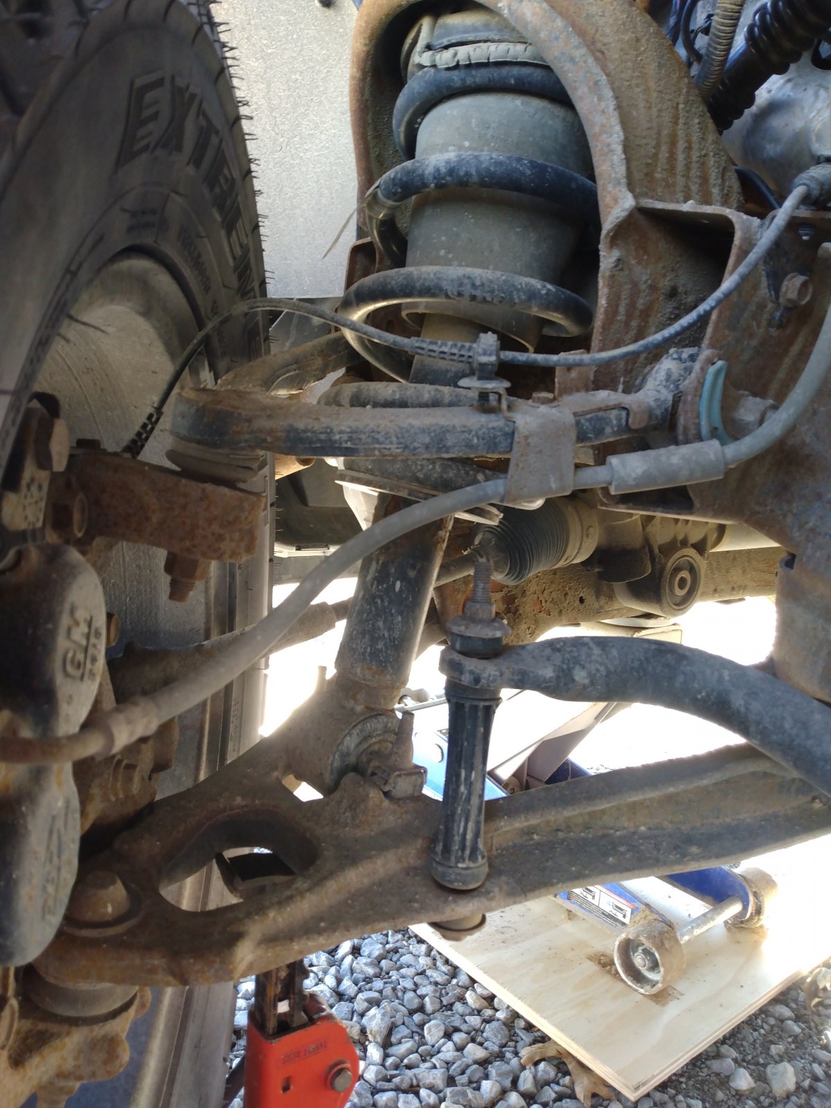

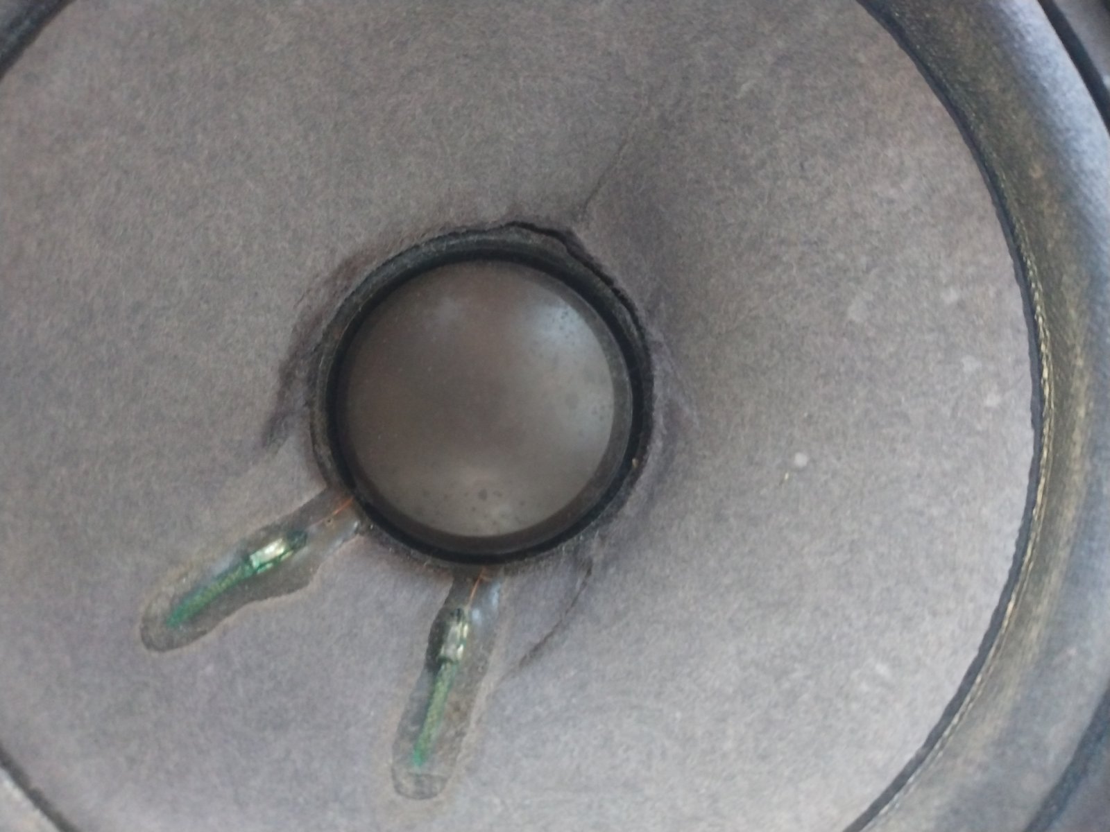

Today i looked over the front end and brakes . Ipulled the drivers side rear door panel off and did some file work on the plastic for my window up/down switch. while the panel was off i realized the speaker is blown so time to order all new. i found where my oil leak is coming from and will order parts here in a bit. put some sticky back foam behind the door lock flag so it quit vibrating. also i let about 15psi out of the tires that the previous owner put in them while trying to reprogram the tire sensor (at least 1 is bad)The quality of the ride is so much better. going to get 4 2010 factory 17s with 20k miles on them and tpms sensors intact as well as 4 new tires for the rims all for the total of $200! Found a random dash rattle which ended up being metal plate behind the kickpanel under the steering wheel.

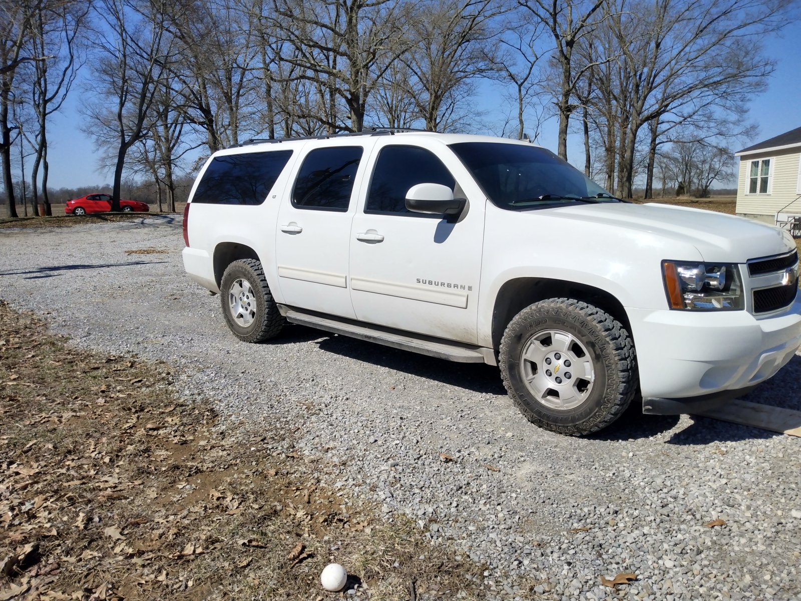

Today i pulled the drivers side rear door panel off and did some file work on the plastic for my window up/down switch. while the panel was off i realized the speaker is blown so time to order all new. i found where my oil leak is coming from and will order parts here in a bit. put some sticky back foam behind the door lock flag so it quit vibrating. also i let about 15psi out of the tires that the previous owner put in them while trying to reprogram the tire sensor (at least 1 is bad)The quality of the ride is so much better. going to get 4 2010 factory 17s with 20k miles on them and tpms sensors intact as well as 4 new tires for the rims all for the total of $200! Found a random dash rattle which ended up being metal plate behind the kickpanel under the steering wheel.
