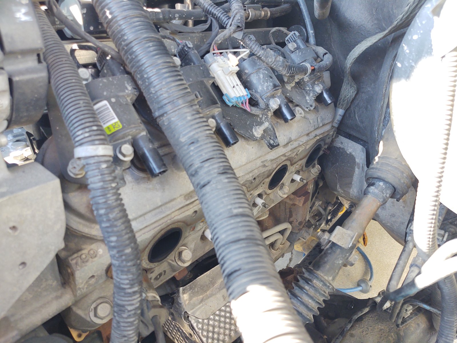

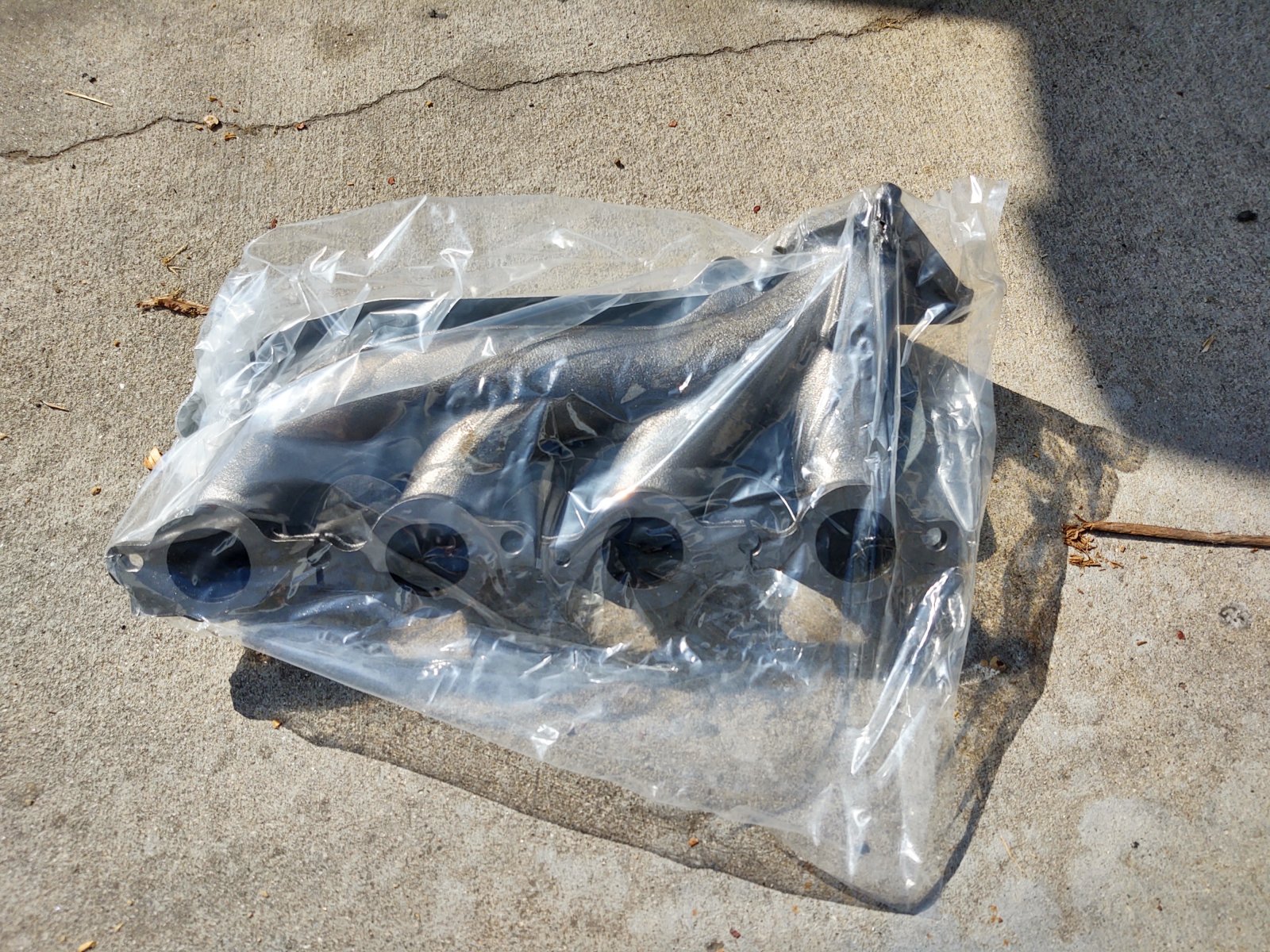

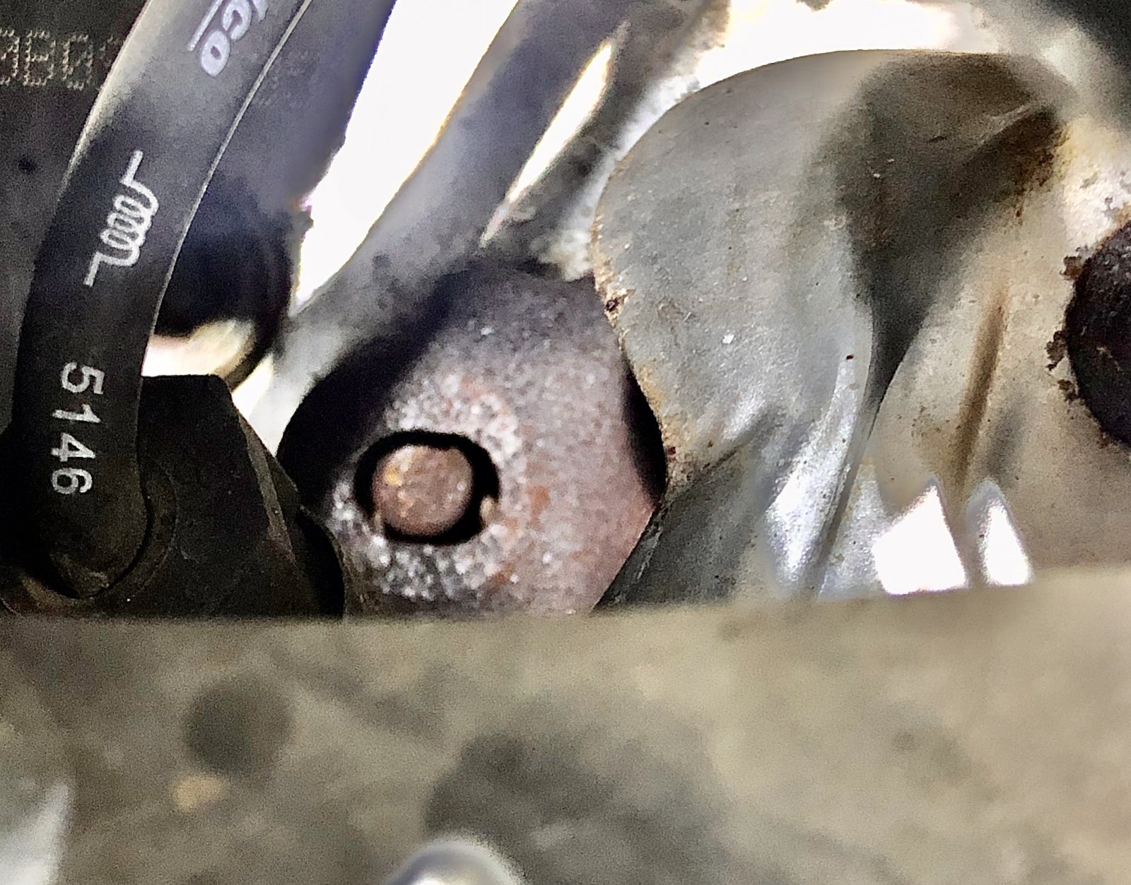

Manifold-cat flange studs had enough, threads magically disappeared. Thankfully O'Reilly's had dorman manifolds in stock.
That lil guy in the back could be why bank 1 is always leaner...
Grabbed it with vice grips and it just sheared off right inside the head... So it'll stay there until I pull the engine.

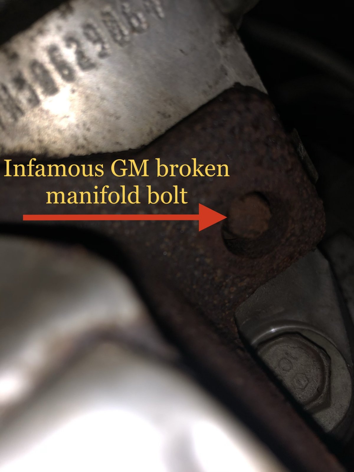

Don’t worry, you’re not the only one with this issue. Bummer you couldn’t get it out of there with a set of vice grips. That’s the only thing that I’ve ever found to work besides welding a nut/bolt in place. 13633BCC-139A-4B4C-8866-1F5B1EC3CD94.jpeg785CD152-FFCE-4BBB-849D-8EEF3C8183AD.jpeg
