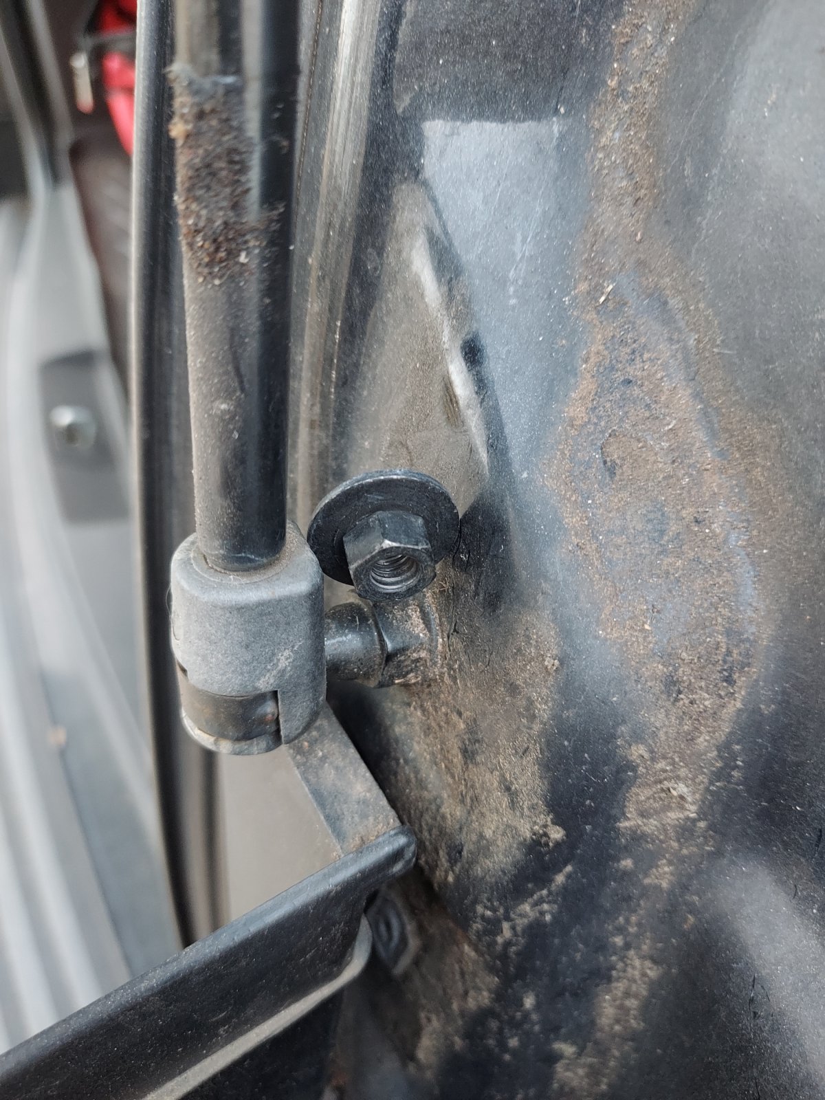

I need to buy a lottery ticket. I removed my appliques to color match them, and noticed this:
I've had the spoiler off a few times to deal with the rubber flap coming loose. I guess I didn't tighten this nut all the way:
What are the odds that it would hang right there perfectly balanced, vs. dropping through the taillight area onto the ground? It looks like I staged it, lol.
put some thread lock on it this time, I had to do that with one of the rear seat arm rest bolts kept coming loose
and yer truk is dirty, :D

Nope. Anaerobic thread locker makes plastic brittle and crack. Learned that one the hard way.
What part is plastic, the bolt or the nut?
If no threadlock, rub wax on the threads. I use a bow wax stick on threads I don't want loosening by vibrations
Sent from my SM-G930V using Tapatalk
the_tool_man
Oct 15, 2018
837
1,994
Upstate South Carolina
that's all metal sir, might be plastic behind it
I don't recall the exact chemistry involved. But when the thread locking compound cures it outgasses something that embrittles plastic. It doesn't have to touch it.
Where I work we build machinery with various transparent plastic guards. If someone puts that on a fastener used to attach it, it almost always cracks a day or two later. We have rules against using it. But every so often we get a new person with good intentions who ruins a panel this way.
Before I knew about this I used a small drop of Loctite to secure the calibration nut on one of my torque wrenches after it had worked loose. I put it in the drawer of my toolbox none the wiser. The next time I went to use it, the entire plastic handle had cracked into dozens of pieces. When I picked it up it fell apart in my hand.
I'll make sure it's properly tightened. But That's it.
