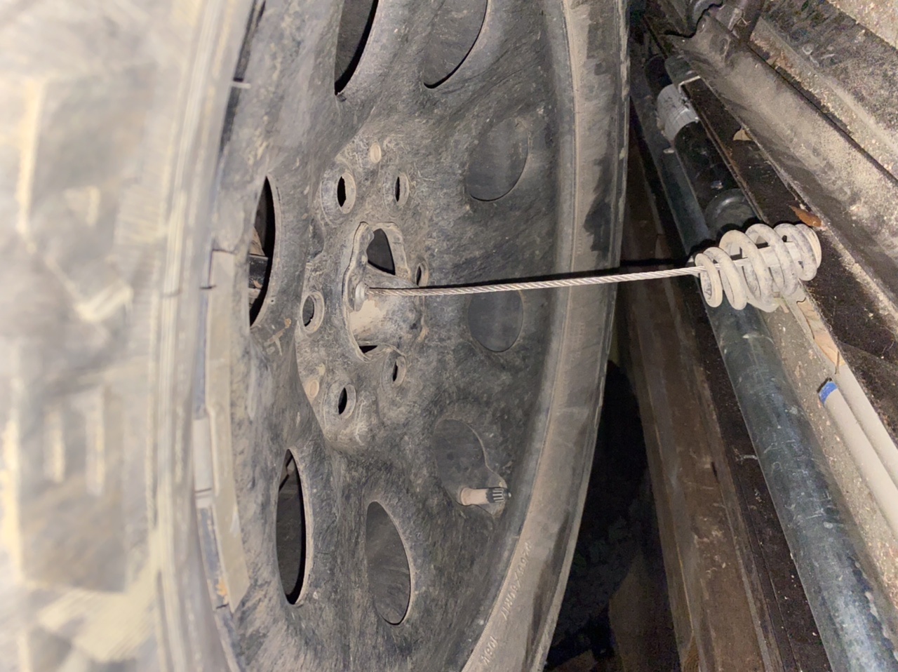

GM’s famous secondary safety latch that likes to rust up.
What are the options? I suppose I could cut the end of the cable, but will it run back up through the other latch?
is there a key spot or two to squirt some penetrant into?
I don’t “need” it down right this minute. Original 10 year old spare. Was going to get it replaced with a new one that matched the other KO2 tires on the ground.
45,011
Soak the mechanism with penetrating oil and make sure you follow the instructions in the manual to release it using the jack and chock blocks.
Some folks have had to get a little more aggressive and remove the winch completely.
I’ll see if I can find some posts about this issue. I make sure that I drop our spare every couple oil changes to keep it functioning.
