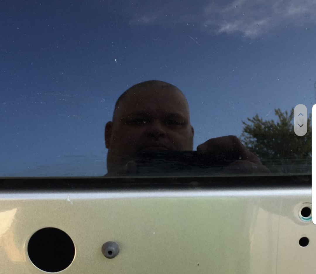

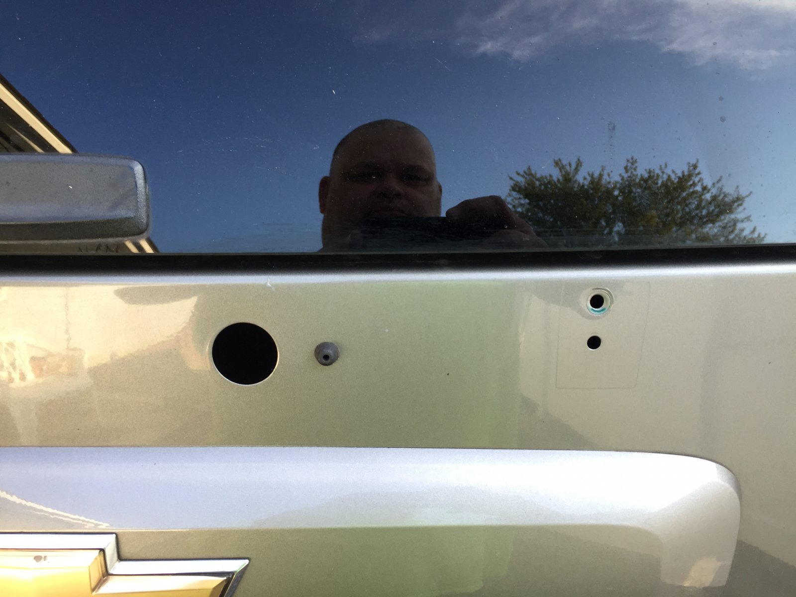

Ok now that the wiper motor is unplugged and removed the rear glass won’t unlatch. I knew the wiring was related between the 2 parts. Does anybody have a wiring schematic for the rear tailgate?
Of course I did not realize this until everything was put back together. ****...
My guess it wont open no matter what you do until the wiper motor is replaced and wiper arm is installed properly in the parked position, it's a safety interlock so you can't open the rear glass and then whack yourself with the wiper arm in the process.
