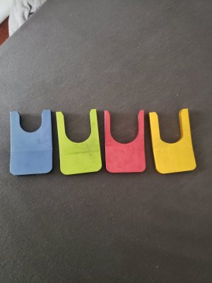

Just replaced my ISS and started on the Dorman Y/coolant lines.
Is there some trick to get the line off from the firewall? I just watched a video and he got it off pretty quickly but, mine will not budge. Is there a tool to help the removal ?
Yes there are tools... they look like this...
