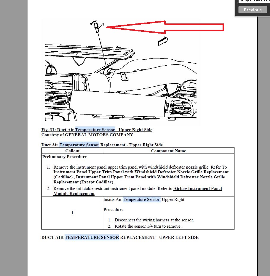

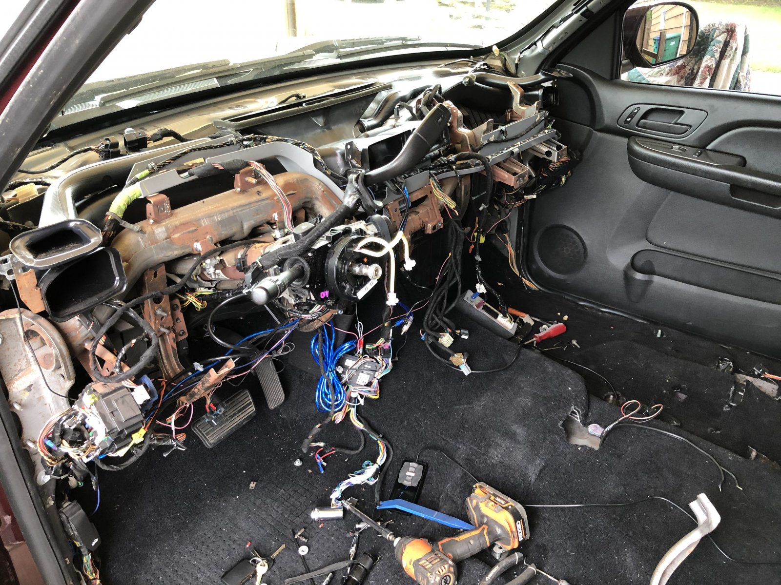

Yeah me too. Turned into one helluva lesson now that I look back on it. It started with me deciding to update the firmware in my HVAC control head for no good reason, I just wanted the latest version. My heater and ac were working fine. During this process, which you actually helped me with since it was the first time I programmed a module, as you might remember I bricked the module. So I ended up buying a used one from LKQ. It seemed to work fine and I didn’t want to chance bricking it so I never programmed it. That was in February so I never checked the AC. Fast forward to a couple weeks ago, after I had swapped in an entire dash from a Tahoe along with an entire new interior into my Silverado, and I try to use the AC for the first time and it’s blowing hot air and the Tech2 throws a code saying the evaporator temp sensor is open, and from what I can find out about this sensor I needed to pull the dash out to access the evaporator and remove the case...so I pull the entire dash and sub assembly but can’t find this damn sensor. And lo and behold somewhere in my internet searches I come across a TSB that says...get this...if you replace an HVAC control head in these rigs, you need to program it to your vehicle or it will throw a code for this sensor which ISNT EVEN USED IN THIS MODEL YEAR! So holy shit I hook everything back up (with the dash still out), program the module, and the AC works and the code is gone. In case you missed it, here’s what it looked like for awhile.
I never found a tsb for mine I just came to the conclusion that since the "rear temperature sensor" on a "open circuit" didn't even exist then it must be the firmware, the closest I got was a wiring diagram for "said" sensor from "just answer" that I paid for and oddly enough the diagram was on some amazon server, no mention of it in the service manual AT ALL this was when I discovered there are like 10 of these little small temp sensors all over the truck and I thought one of them must be bad or disconnected or something, glad I didn't tear the whole truck apart but I sure thought about it, I might have if I hadn't got the wiring diagram showing me where it should have been all the way in the back by the rear hatch on the drivers side so I took down the headliner and looked all over for even a wiring harness nope nada nothing there.
I can’t even find that TSB now, in fact I think it’s listed under “preliminary information” and never made it to TSB status. I have looked through alldatadiy and all my internet history on my iPad and desktop and I can’t find it. But if I hadn’t found it, and the fact that it listed the exact symptoms and the DTC number ( which isn’t even listed on my alldatadiy list of DTC’s, it’s not listed because the truck doesn’t have that sensor) I might still have no AC. I just got lucky because I probably wouldn’t have programmed the module because of what happened the first time I tried. I really got lucky.
