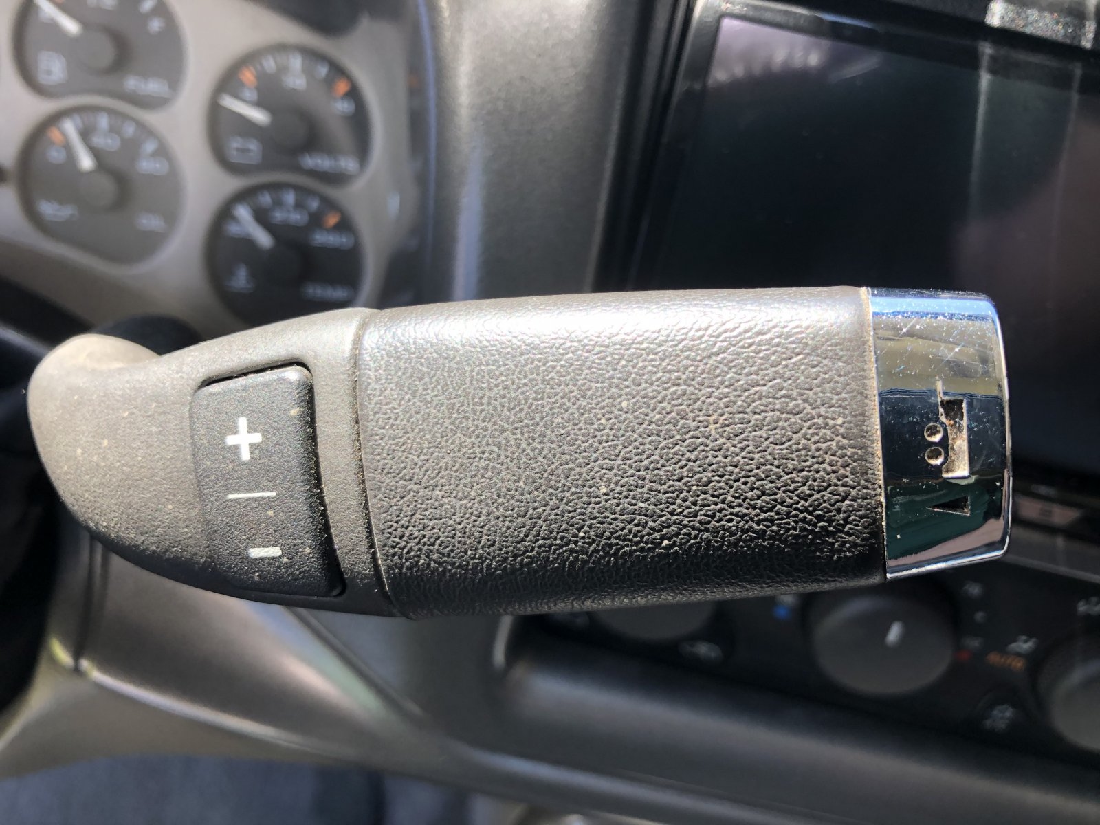

Got annoyed by the peeling chrome on the end of my shift handle. A while back someone had some of these shift handles for sale but I can't find the thread. Can anyone else find it?

BTW brand new 2015-up Escalade ones are about $70 and they changed the ends to black so no more peeling chrome. I put one in my 02.
https://www.ebay.com/itm/264644536544
Nice. Didn’t know the 2015+ ones also fit our NBS.. sweet! Is the angle of the shifter about the same? That’s the only thing I don’t really like about my NNBS shifter. It’s a bit lower when in drive, etc.. angles further downward compared with the factory NBS one.

I think it’s about the same as the NNBS although I never installed one so I can only compare to the NBS. It seemed a tiny bit lower then my original one but I like it. The connector for the tow/haul needs to be cut off your old one and soldered to the 2015 one, just match wire colors for the 2 wires you need and don’t use the extra 2 wires for the + /- button. You can’t use that button, it’s for the 6 speed trans.
Yessir. I already swapped the wiring over to the NNBS shifter, works like a champ. I really don’t want the extra (useless) +\- on the stalk, but if it’s a better angle, I’d do it. Thanks for the info. [emoji106]

I thought the leather wrapped ones only came with the chrome ends. Thats also not the same part number as the leather/chrome one i have
Those are for the 2015-2020
Don't know if they have leather without the chrome or not

Are those leather wrapped still or not?
Mine is but it has the chrome end. I’m pretty sure that one I linked is too, you can see it in the photo.
Edit: maybe I’ll buy that all black one and sell mine. I HATE chrome lol.
