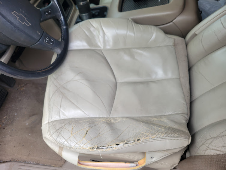

finally got that new seat cover installed, bought this cover like ohhh 8 months ago lol
never had to do a power seat, manual seats way easier to work on, them harness clips loved being installed
where they were.
new cover.

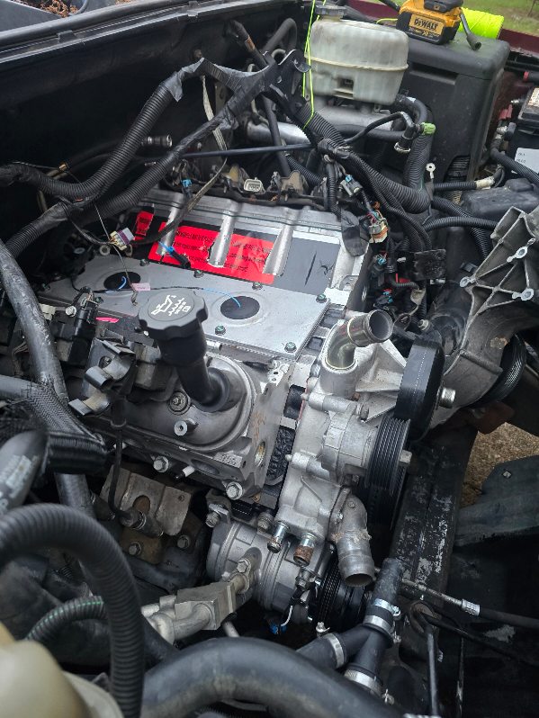

also started a water pump job on a 05 chevy work truck, fan wont cooperate with hammer blows to the wrench trick, so ill have to get the rental tool to hold the pulley in place. but thats a problem for tomorrow.;)

Remember the clutch fan threads are right-hand thread, so counter-clockwise from the front to remove. You probably knew that already, but....

sadly ive dealt with them fans before, some times the belt grips tighter and it breaks free, some times you need the pulley holding tool. whats wrong with them 4 bolts they used use? lol truck needs a new belt too. its all cracked up bad.

got that water pump finished up today, 3 parts stores not one had the right tool to hold the damn pulley, but in a pinch a 3 ft pipe wrench will hold it tight as a clams ass in a rain storm lol

not the best way to do it but its easy to use a c clamp to hold it tight

i tried that method too. also didnt work. that 3 ft pipe wrench worked as good as the tool. or a air hammer that i did not have.

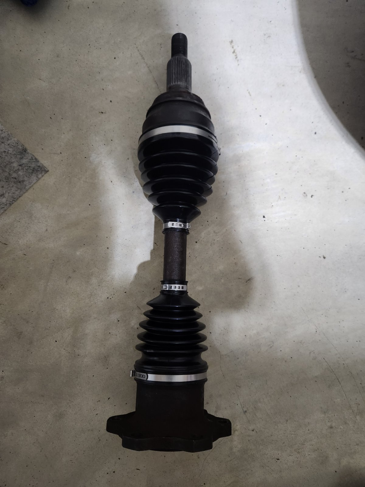

Had torn boots on upper balljoints that only have like 30k miles on them. This basically turned into a front end rebuild. I had to put upper control arms on it about 30k ago and did the idler arm at that time as it was a bit sloppy. Other than that the suspension has 190k on it. Figured I would refresh what I could while I was in there.
Also found the pass cv axle just started slinging grease so replaced boots on that.
Also pass side inner pad/rotor had some wonky wear pattern.
Parts list.
Lower balljoints
Upper balljoints
Inner/outer tiered
Pads and rotors all 4 corners
Sway bar end links
Repalce boots on pass side cv axle.

You just replaced a boot instead of the whole axle? Did you get a boot kit?

Yeah I put new boots on it. I try and reuse oem axles as much as possible. Rockauto has inner and outer boot kits. You get the boot, clamps and grease.
