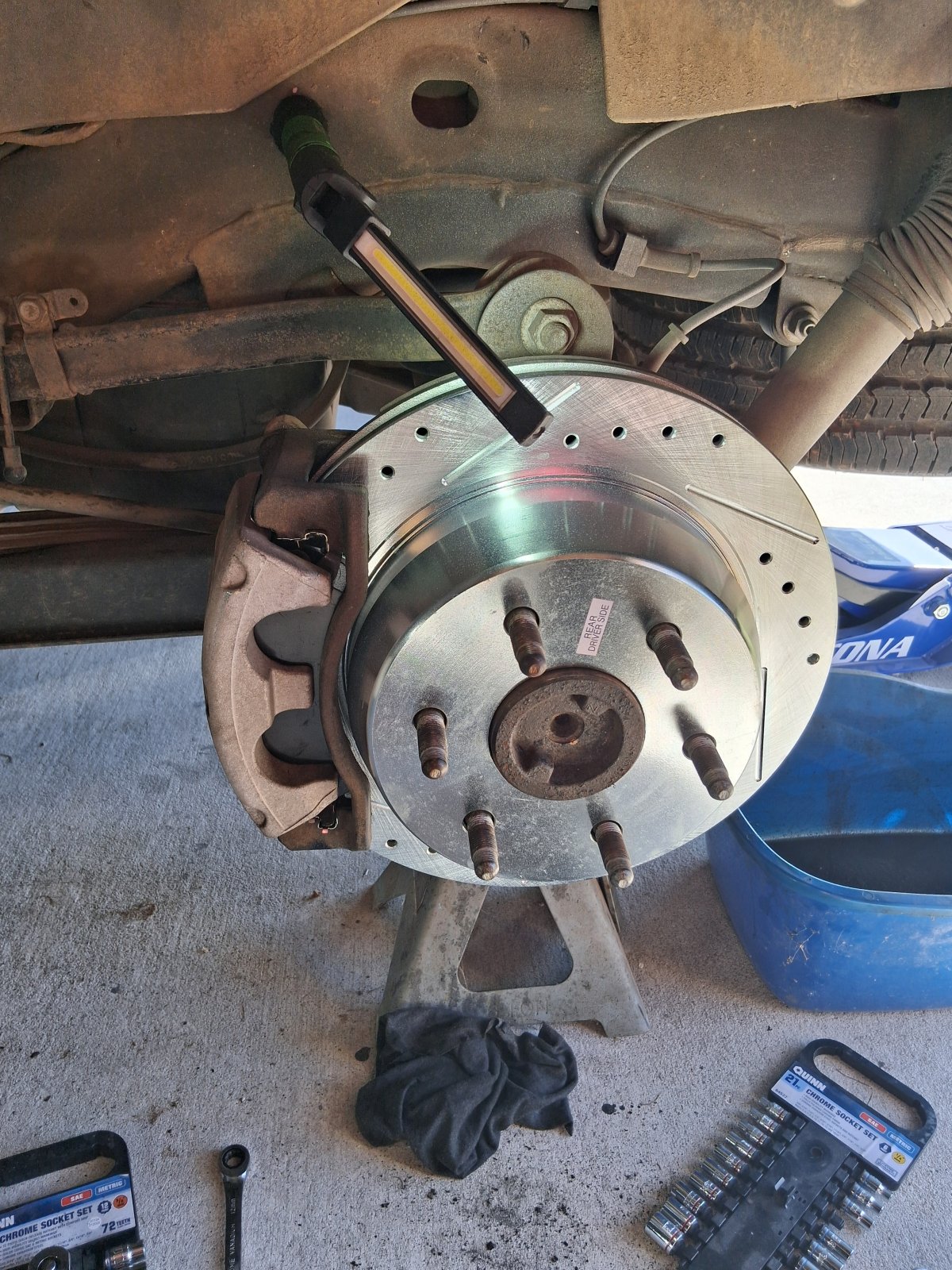

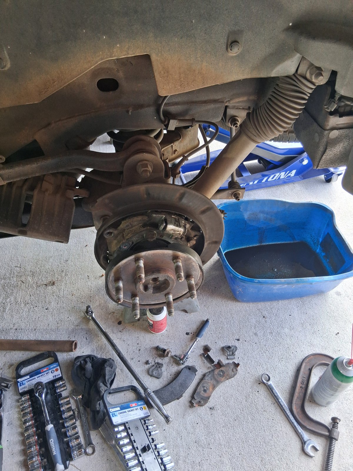

Finished up the 4wheel brake job, I know I am slow, but I am the cheapest mechanic.
Also replaced the parking brake shoes, prolly didn't need to but what the heck.

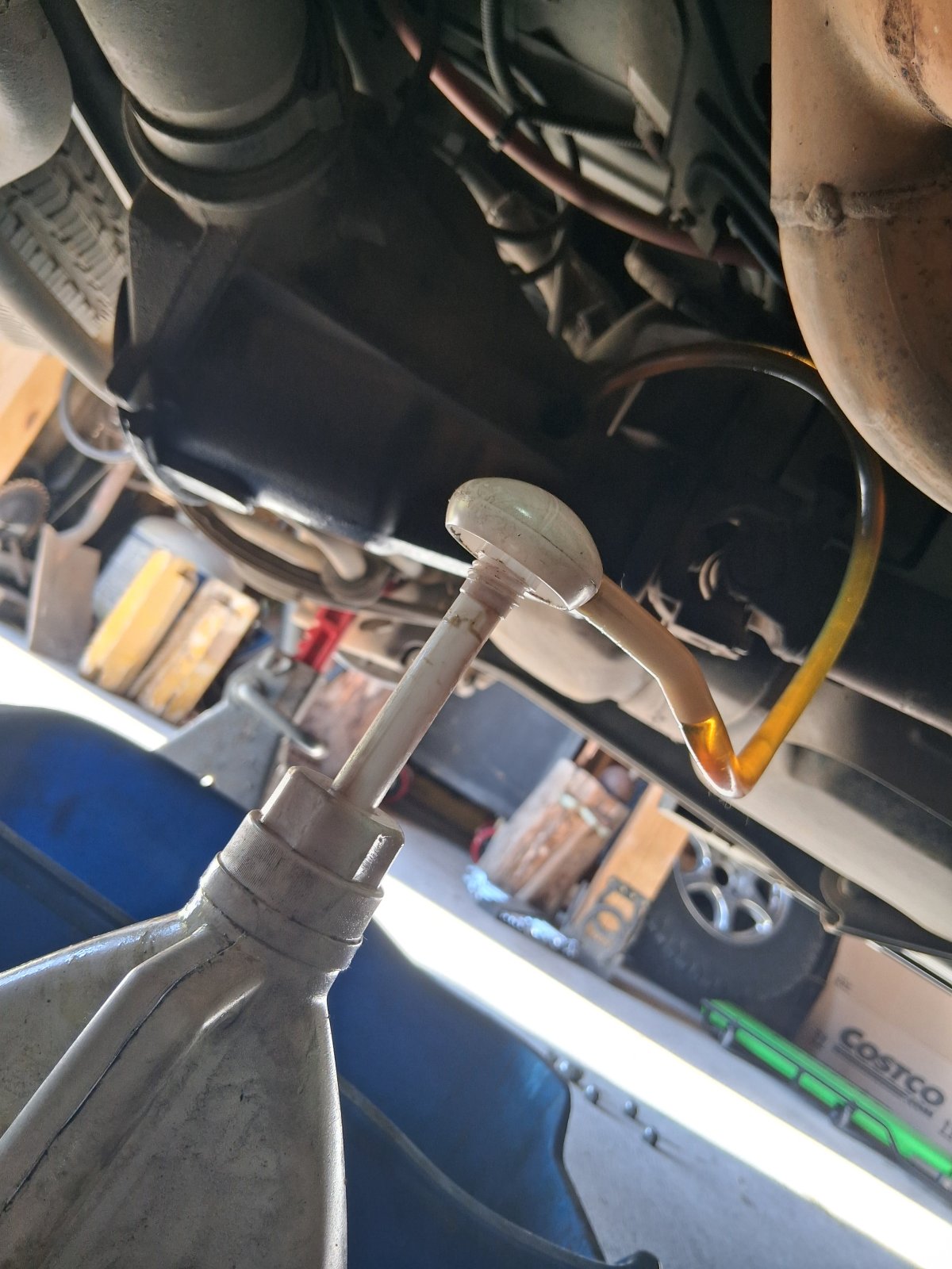

While I was under there I noticed my rear diff is leaking from the pinion. Going to take to the shop for that one.

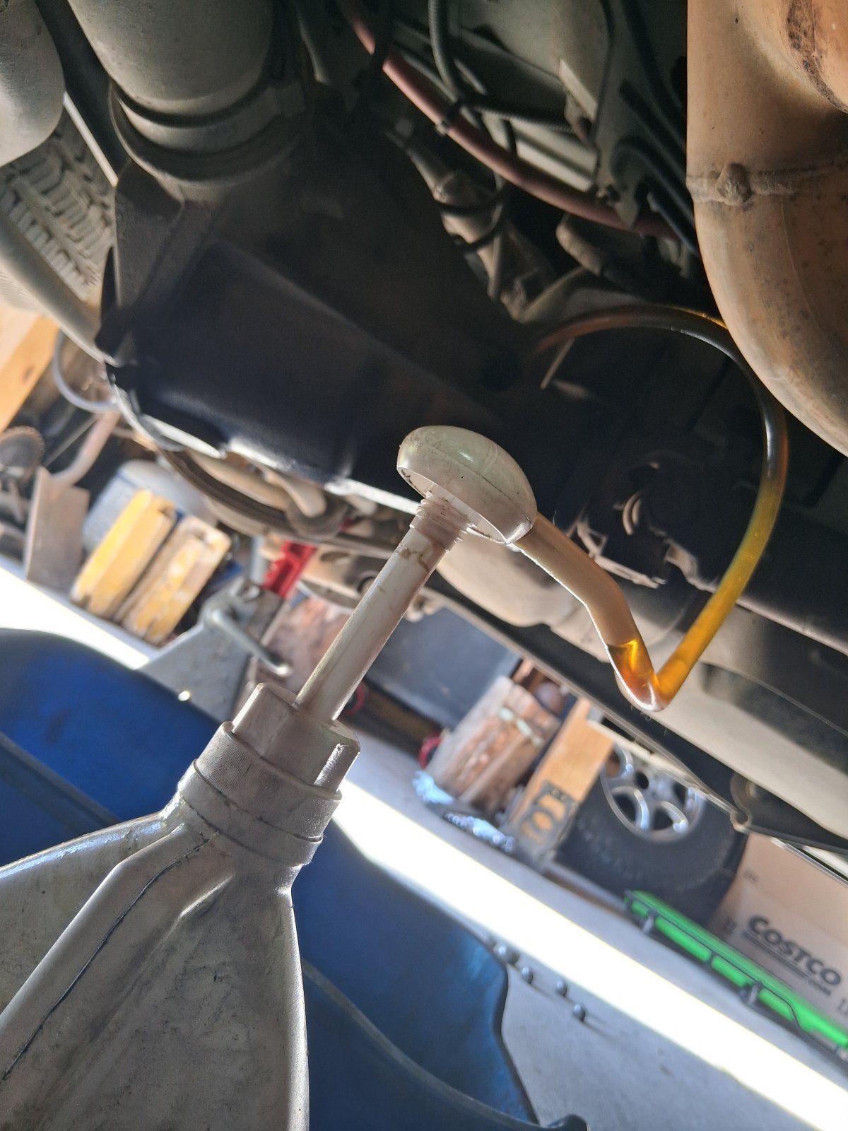

Also anybody have a better way of getting oil into the diff. I use this pump, it's okay but only takes an hour or so to fill...
they sell gear oil in a bag now, but it costs more, the pro tip of the day is, buy one bag, and re fill it with oil from the plastic jug. keep the bag for future use.
Yeah I'm not crazy about squeezing a bag for fourty forevers though, seems like your hands would get tired.
i use a 500ml syringe for doing all that stuff, works great on diffs, transfer cases.

I got one of these, got all kinds of good reviews. Makes a big mess, wouldn't buy again.
I ordered this, maybe it will work. If not I'll try the bags (and resuse them:))

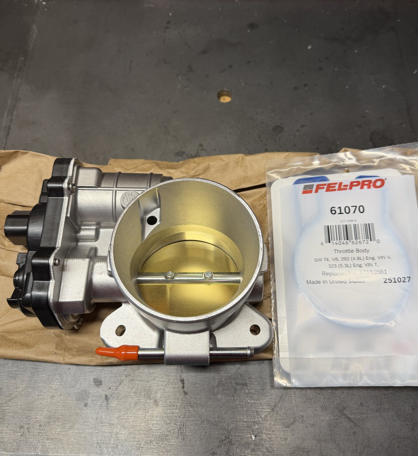

Did not do anything today with the 03 Z7 Tahoe; Yet..
Got to open an early Christmas present….
Tahoe went into reduced power mode recently with the following codes:
P2135
P0120
Read about various relearn procedures.
What is the preferred method?
Manual (run 3 minutes; turn off for 1 minute & repeat) or an electronic reset via scan tool.
I can get access to a Tech 2 clone.
Don’t have it in hand though. Can anyone tell me what menu the procedure is buried in?
03 Tahoe Z71 w/ 5.3
Thanks in advance.

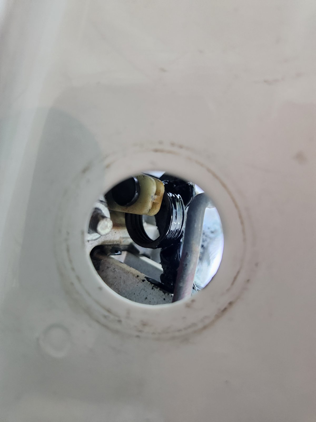

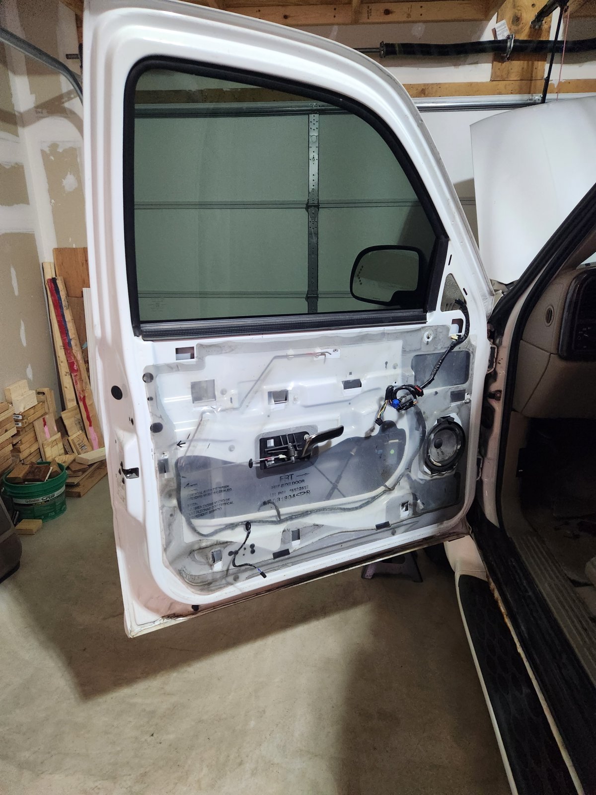

Couple more maintenance items on my denali today.

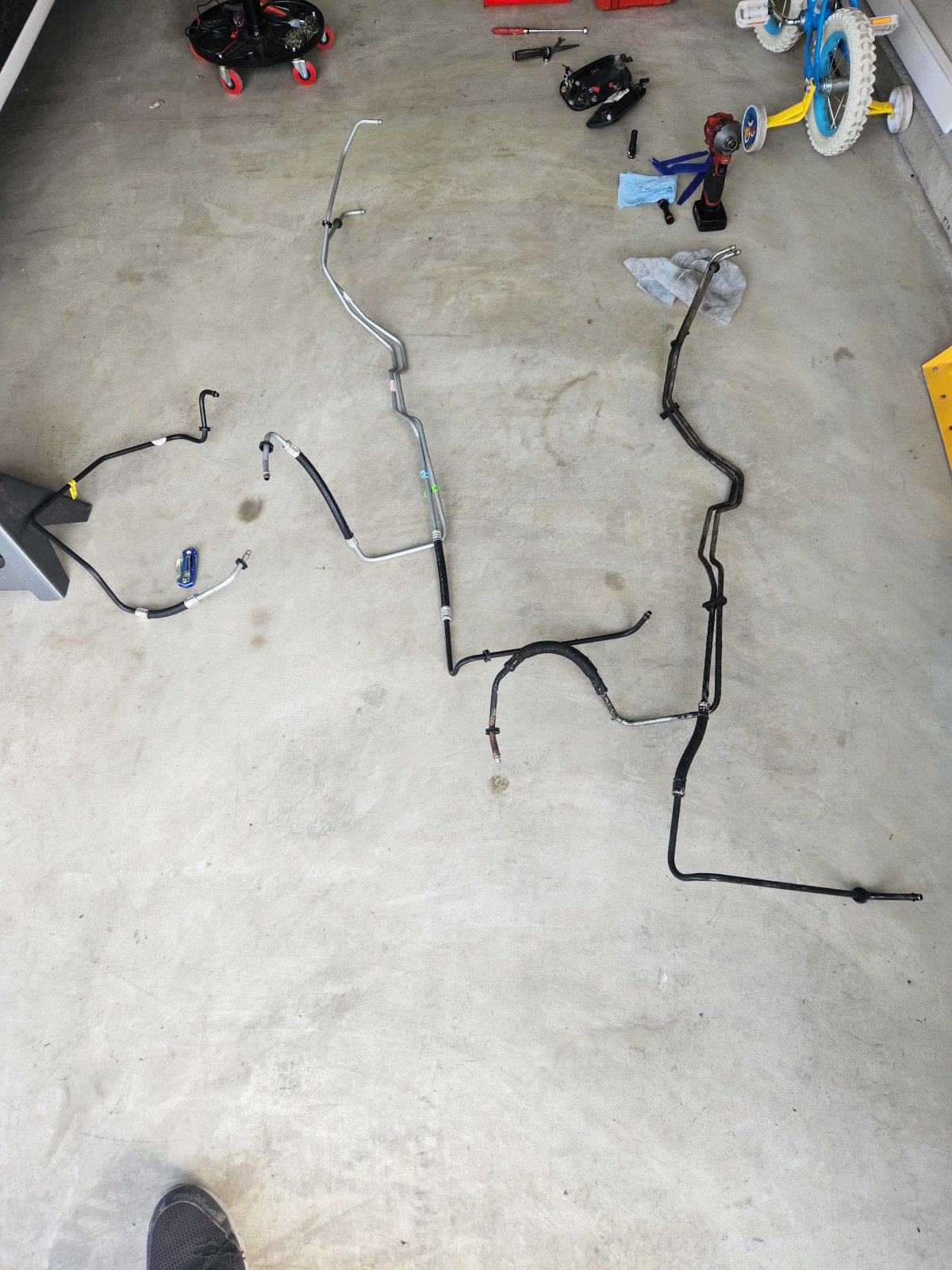

Few years ago my door handle lever broke so i bought a dorman handle for parts. Use the lever and spring. Well the lever was sloppy and the spring broke within a year. So got a couple junkyard handles to use for parts to rebuild mine. Note if you pop the plug off the door you can lube the spring to keep it from rusting.
Also changed all 3 trans cooler lines. I cut out the crimped sections years ago to solve leaks. We'll one line that's not rusty at all got a super small rust spot and pin hole up by the starter and it was just starting to weep. It would leave a 12" circle of fluid after a drive. Instead of trying to splice the line I just replaced all with acdelco lines. Not a bad job at all. Couple hours all in.
View attachment 474377View attachment 474380View attachment 474381
so far i've had luck with the dorman exterior door handles for a few years
the trans lines are on my to do list soon
looks like your power steering cooler may be next
6speedblazer
Mar 17, 2017
204
352
I meant to hose it down with some nhou oil while I had the grill off, but totally forgot. Ill try and get to it tomorrow.
But yes the ps coolers rot pretty bad I've replaced quite a few of them.
33,162
51,352
I deleted my ps cooler years ago. I just looped the hoses iirc. No issues.
