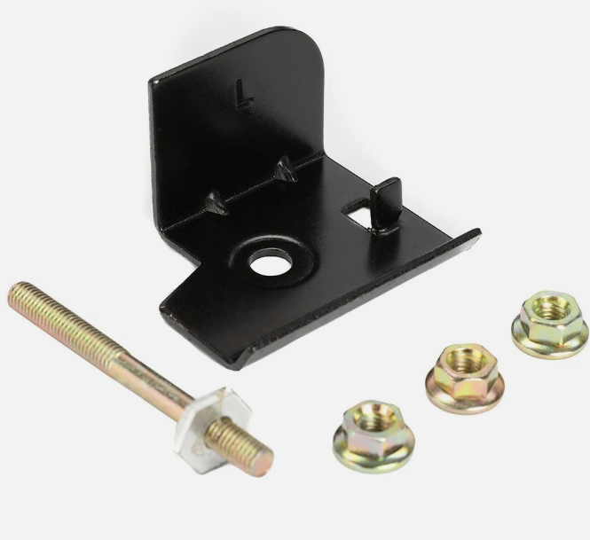

I notice this ebay listing mentions an additional bracket to prevent vibration..
Also mentions no instructions.. Or maybe amazon is a safer bet?

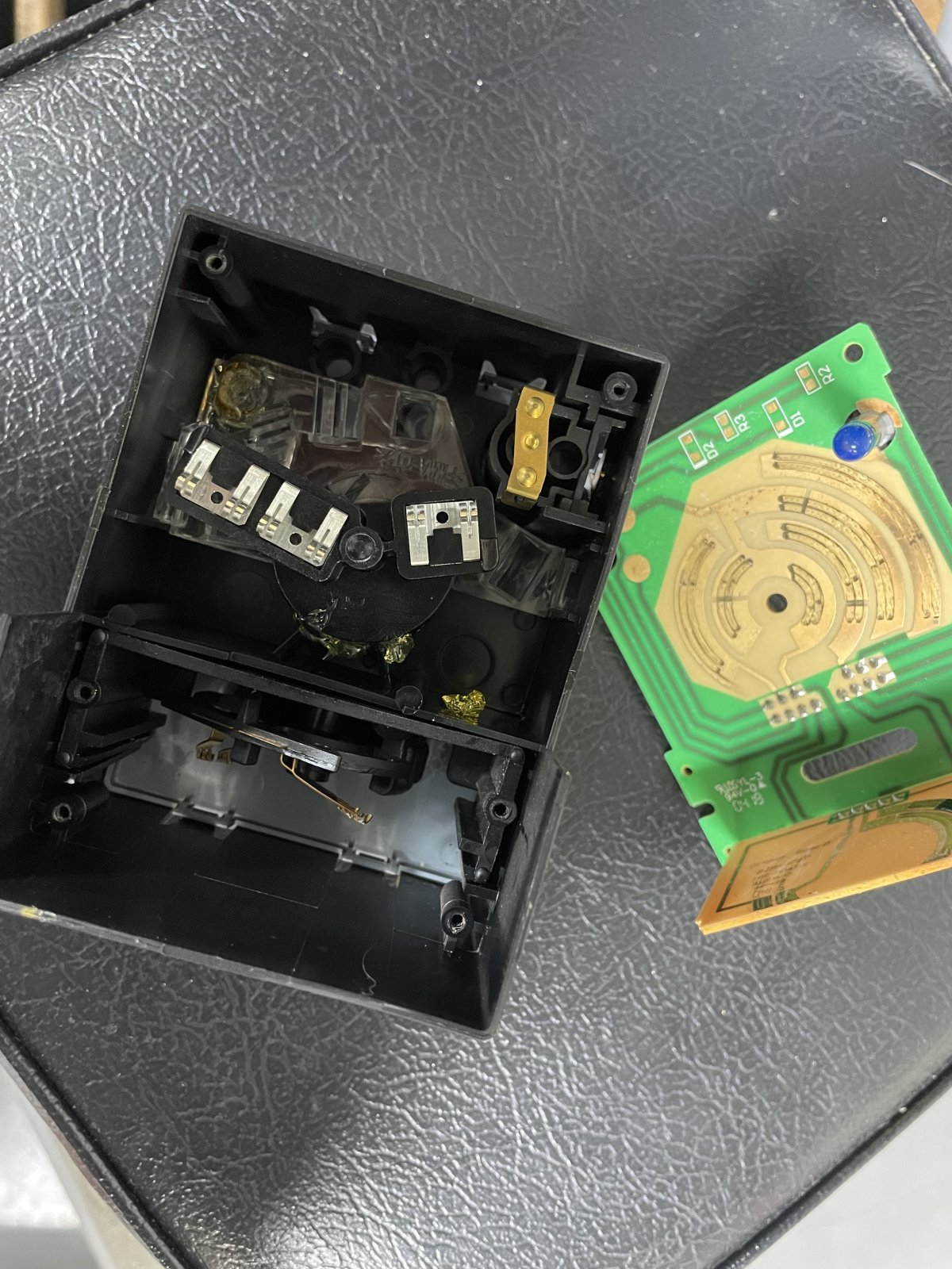

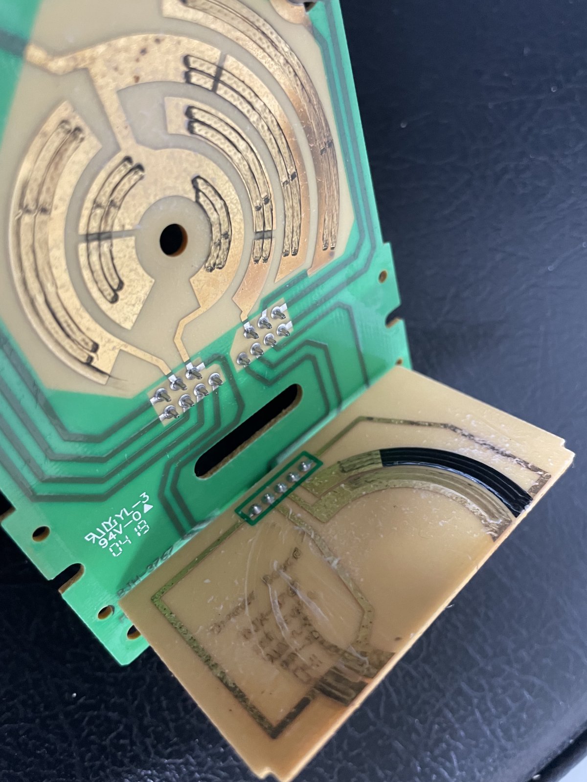

I took the old one apart (nothing works) and it looks simple, so hopefully cleaning the contacts can fix it..
There was some white crusty residue on a couple contacts. Do I need special cleaner or can I just use rubbing alchohol? And would dielectric grease help or no?
Bulb started melting the clear plastic. (upper left corner)
Crusty white stuff on bottom right finger contacts.
More crusty white stuff on dimmer sliders plus black carbon tracks.

Cleaned my dimmer switch contacts with rubbing alchohol and eraser.
Slathered a little dielectric grease on them. (Hopefully it doesn't leak in the heat..)
Fingers crossed it will work tonight. I think the white residue was dielectric grease as well.
When I took apart my used ebay switch, it had white stuff all over the headlamp circuits, which worked.
But not on the dimmer circuit, which didn't work. The opposite of my original switch.
Both had melted plastic by the bulb.
Don't use dielectric grease - it kills continuity : die electric.
Yea, but where the contact is should be wiped clear? I know we don't want conductive grease spread over the contacts?
I was going to order that deoxit everyone recommends, but didn't feel like waiting for it and spending $20 for this..
(Though I would like to have it on hand someday..)
Just tested the dimmer, works great! We'll see for how long..
