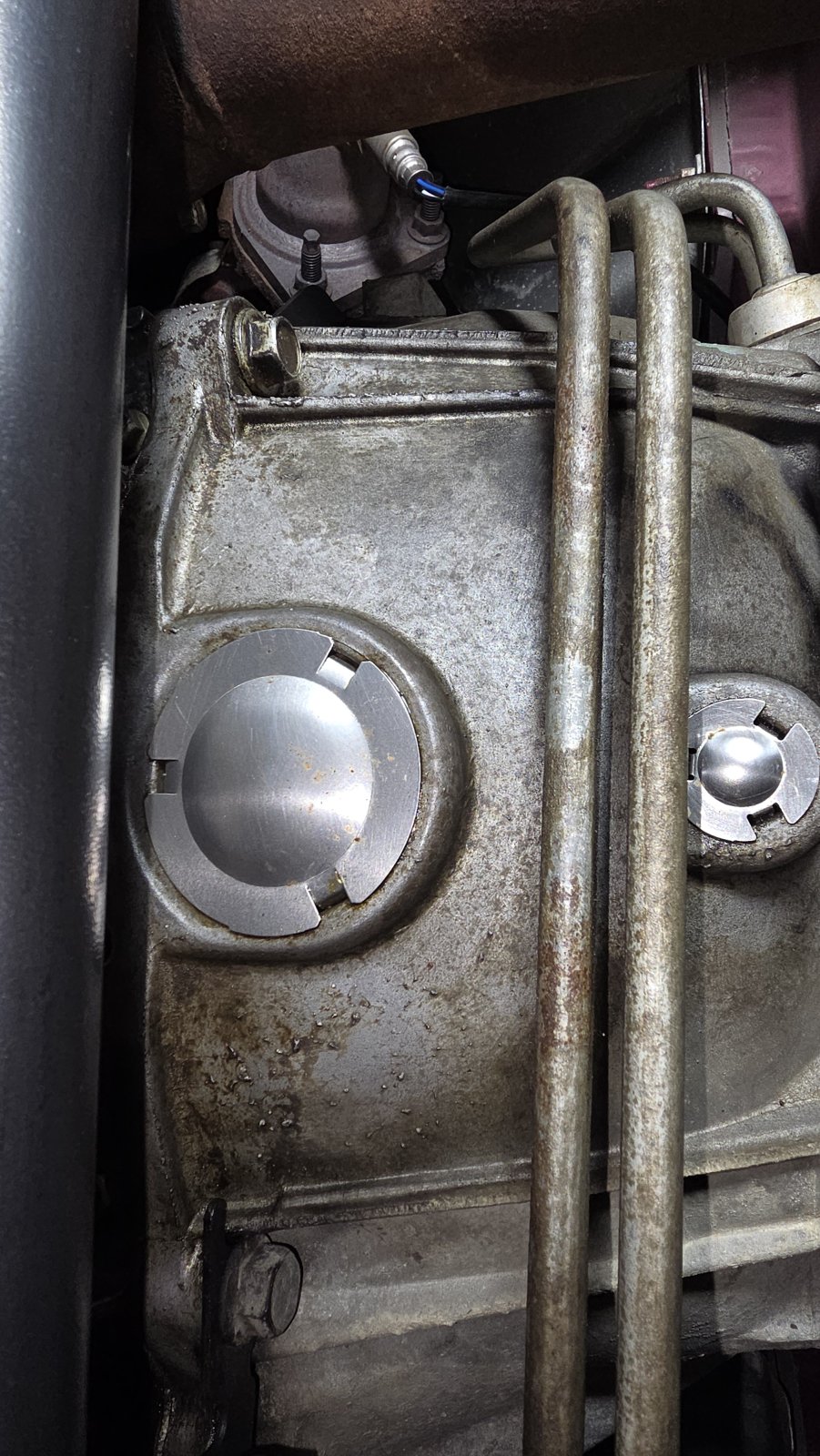

Ok, I'm going to trickle in a couple of posts now on leaks that I'm finding. Here's the first one. Before/after cleaning the area/after it's sat a couple of days.
Any thoughts on how to deal with it? I don't even know what I'm looking at there.

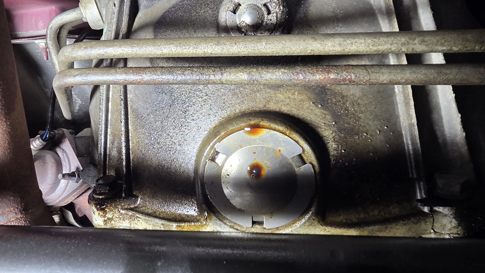

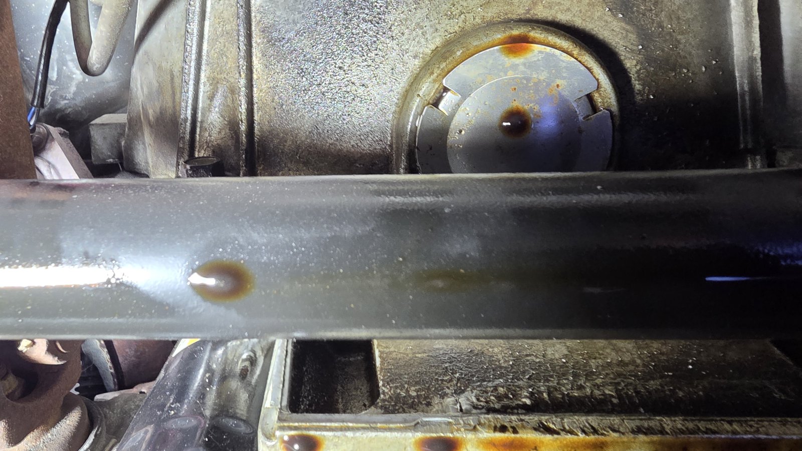

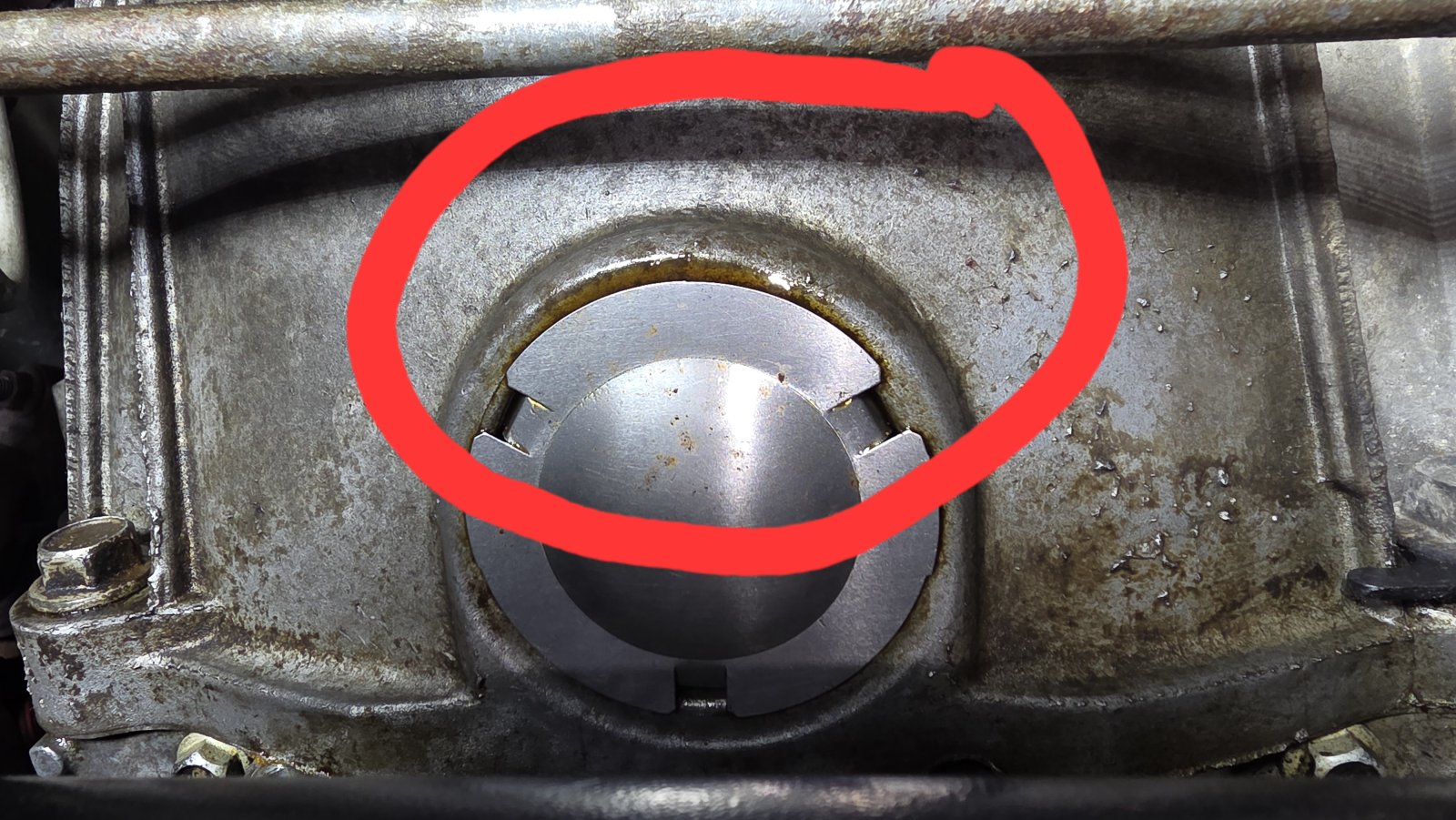

I haven't driven it since I cleaned it up. It's just sitting on ramps in my garage. The oil is literally coming from that circled area. Is that some kind of seal that can be tightened?
No, it is just an inspection plug.
You can pop it out with your pocket knife or a small screwdriver and look up into the bellhousing with a flash light or inspection camera if you have one.
You won't be able to see a ton as it isn't like the older transmissions where you could remove the bottom half of the bellhousing to access the torque converter bolts, but it is better than nothing I suppose.
I just recently had to do the rear main seal on my '08 Burb at 332k miles.
Ok! Thanks so much for responding. Let me take a closer look to see if I can find the source.
View attachment 474070View attachment 474069View attachment 474072View attachment 474073
That is oil coming from the rear engine cover gasket that also holds the rest main seal. I had identical looking oil on my 2008 and finally decided to order a new GM cover. You have to remove the transmission to do it. The cover seal gets flat and hard, then starts to weep. The rear main seal is usually not the culprit. The cover seals off the main oil galleys, so is subject to lots of pressue and flow.
If you aren't equipped to remove the transfer case and transmission, then I'd get a quote from a reputable shop. Or just park on cardboard and top off oil as needed. I think mine leaked about 1/2 - 1 quart over 5k towards the end before I bit the bullet and did it at my dad's shop.

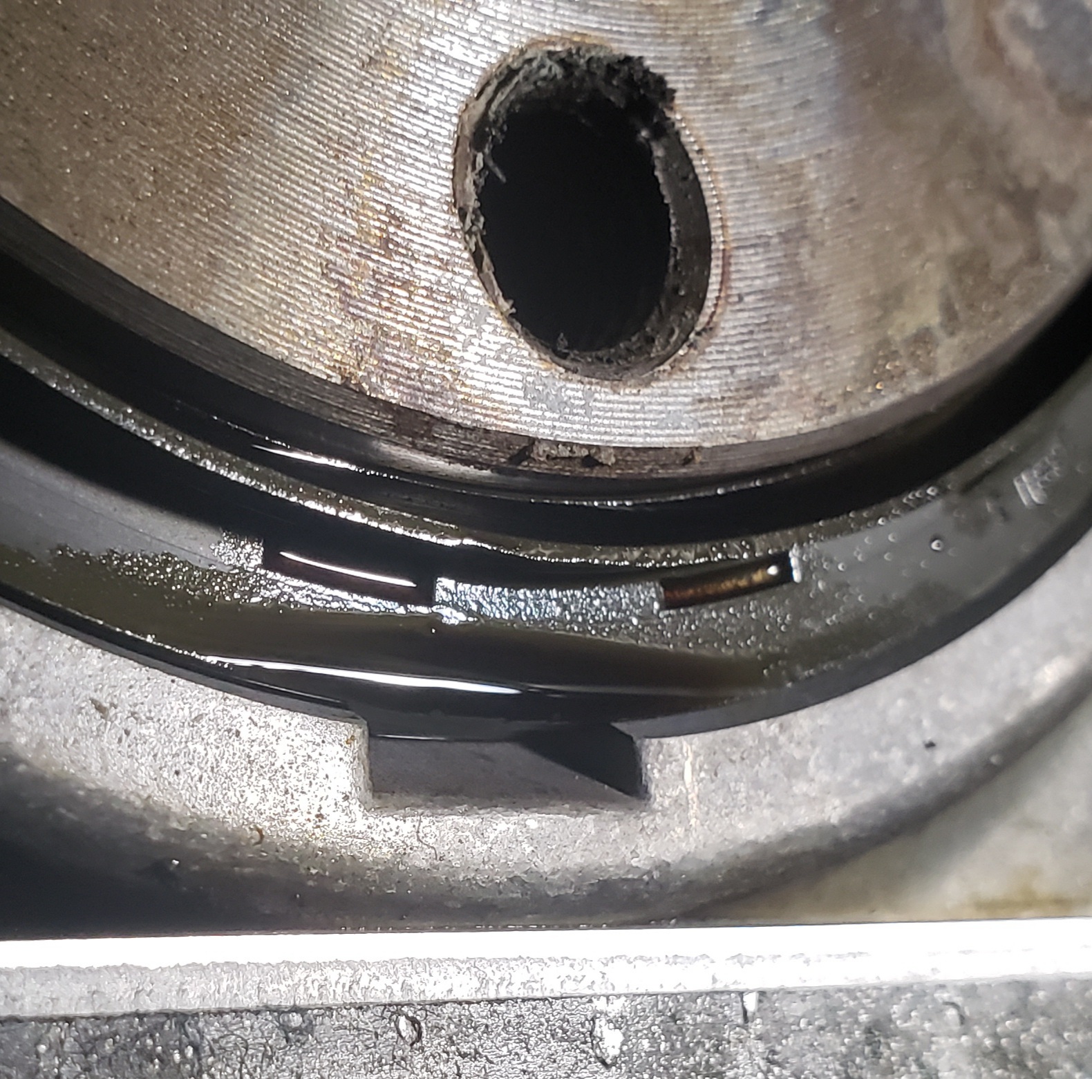

It's either the rear main, oil pan, oil pan block off plate or the vlom leaking down the back of the engine. All very common leaks and all seem too collect oil where the engine and trans meet so it's tricky trying to determine whats leaking. Best to be prepared to deal with them all. Here's how I dealt with my rear main. I feel like as these trucks age you'll always be chasing an oil leak somewhere.
30,576
48,070
That little metal cover comes off then you can use a "telescoping tilt mirror" sold at almost any autoparts store for like $5
use the little mirror and a flashlight, then you can see up in the blind spot at the rear center of the engine, if there is oil coming out there then you know the source
if it is all dry inside everywhere then that is not it.

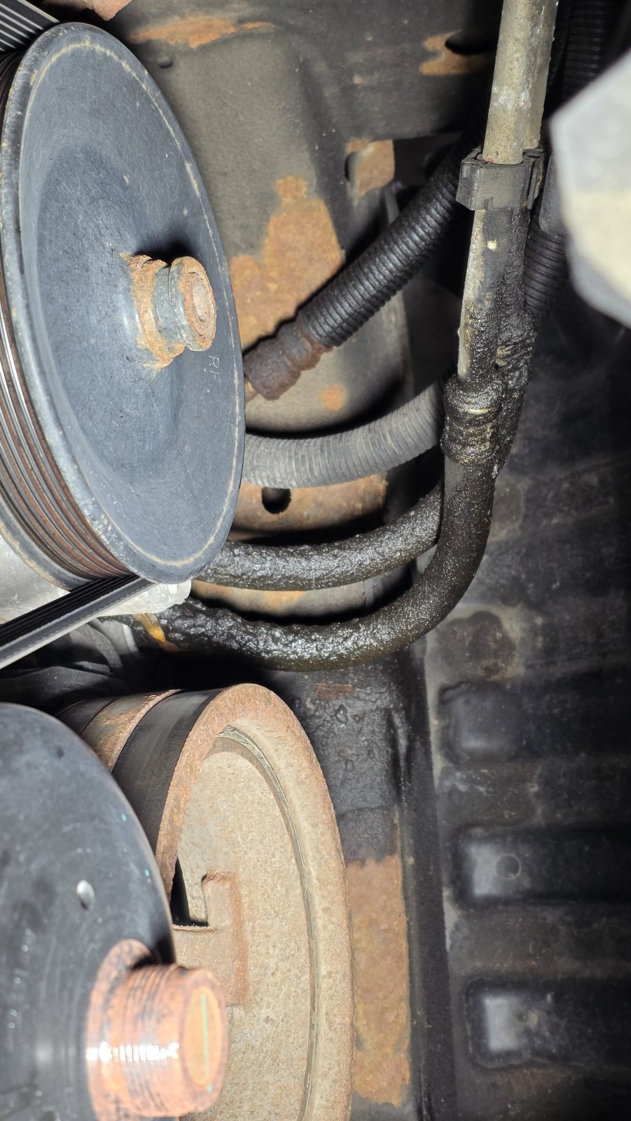

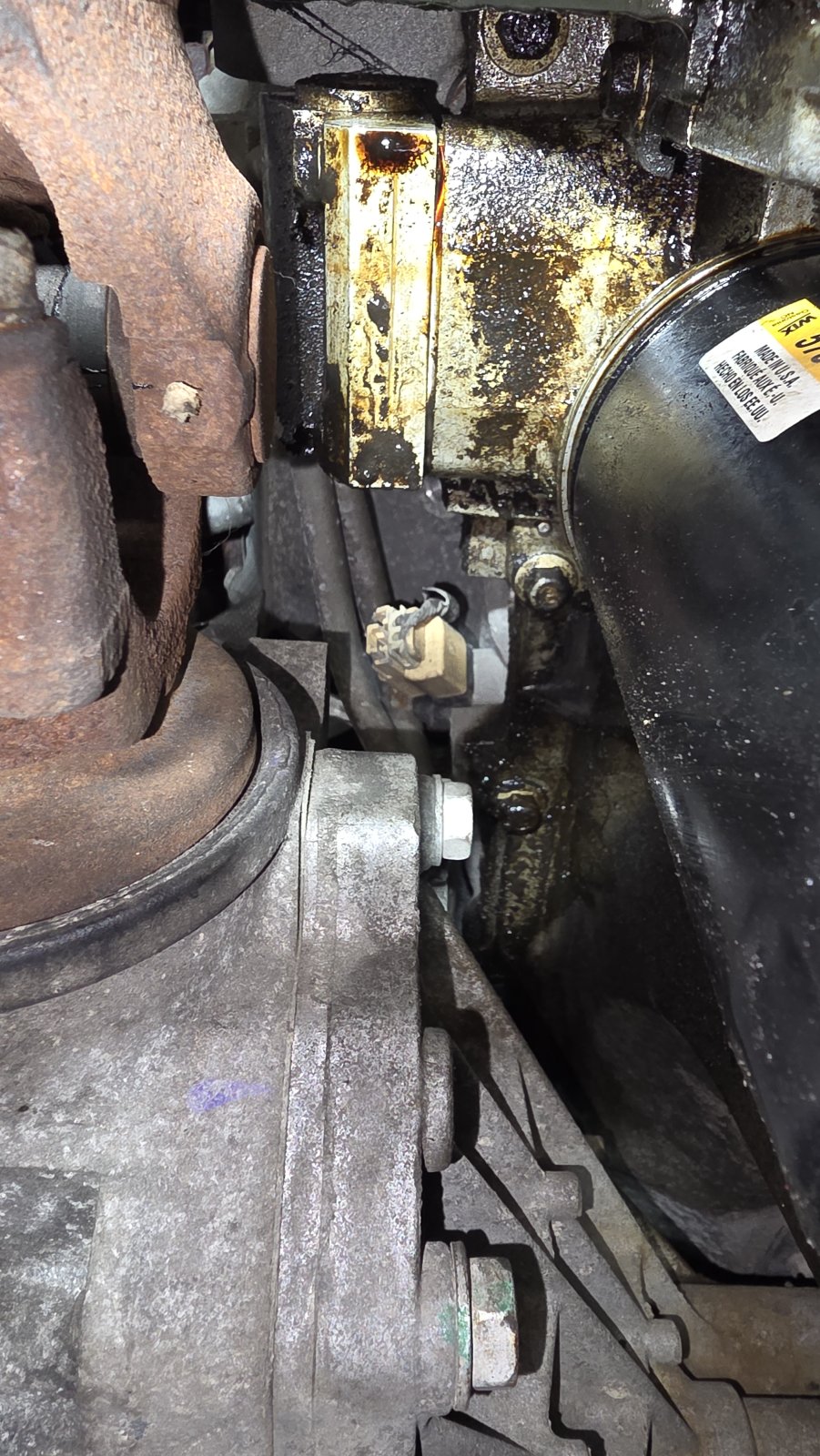

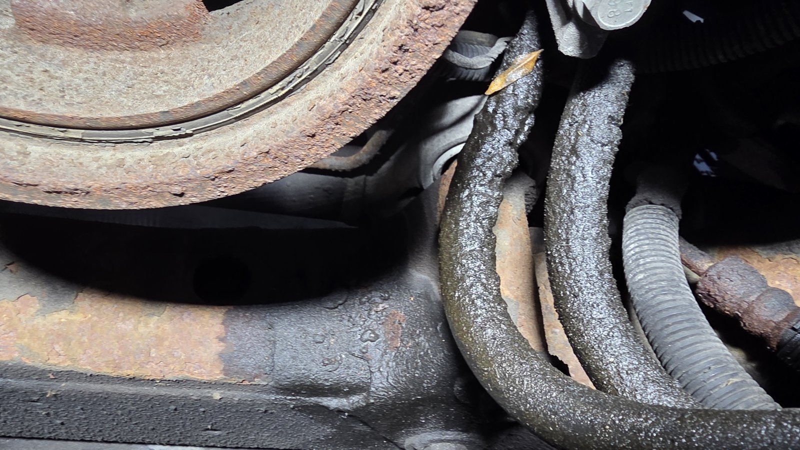

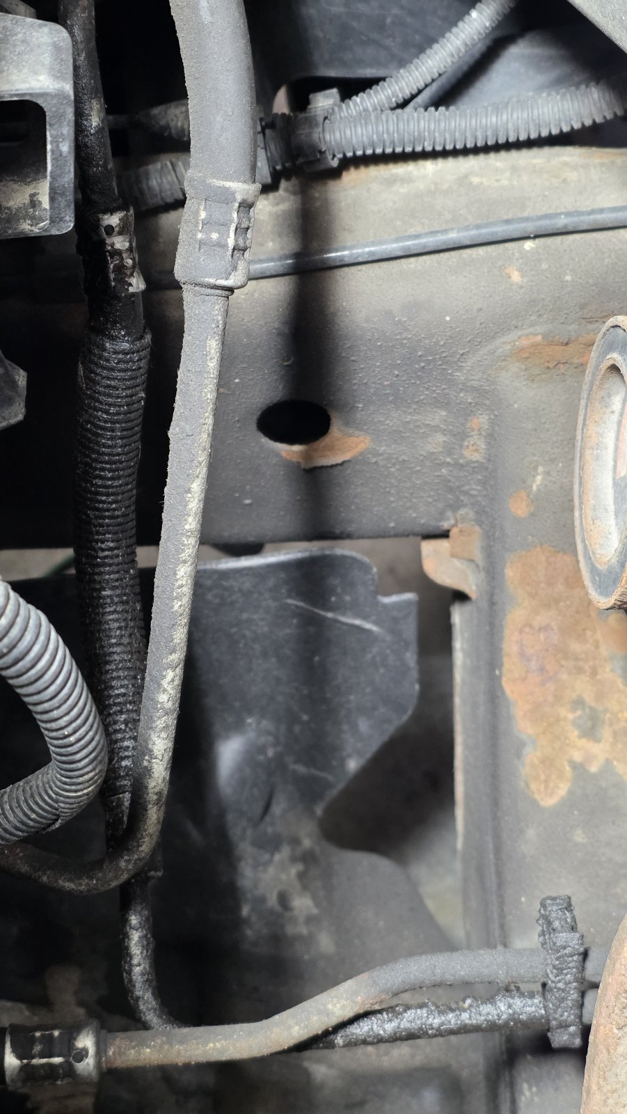

Some of the leaking is definitely coming from here. Do these look like major issues or I can limp by for now?
One other thing I've noticed is that I keep having to top off the coolant. I don't notice anything on the ground or see any active leak anywhere. Changed my oil recently but didn't notice anything there. the truck has not been driven much this year. Maybe 1000 miles tops so I'm noticing all of this as it's just parked in my garage.
You'll remember that a couple of years ago, I changed out all of the heater hoses, radiator, water pump, Ts at the firewall, etc and all of that seemed to go pretty well.
One mistake I've noticed is that I used worm clamps on all of the hoses and that was just dumb because they are not staying tight and some leaking was definitely because of this. I tightened them up but still have a little drop in level. What clamps would you recommend?
On mine it turned out to be the rear main seal.
