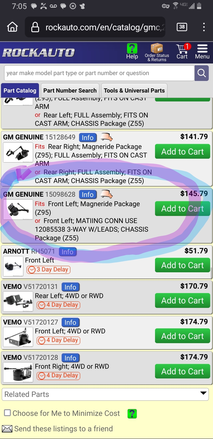

I found this part on rockauto which I believe to be the right part, but wanted to have you all double check. Does front left mean driver side?
Also, I have the Z55 option (not magneride Z95).

yeah left front is the drivers side. seems they have 2 different ones, one for a cast arm. don't know what you have

The cast arm one is for the read.
I'm a little confused by the comment 3-way with leads and the other referenced part number. Does that mean I'll need to splice some wires to make this work with the additional part they reference? Doesn't seem like it's a ailable on rockauto.

might go to gm parts direct so see what part number comes up with your vin, and the buy that part number from rock auto?

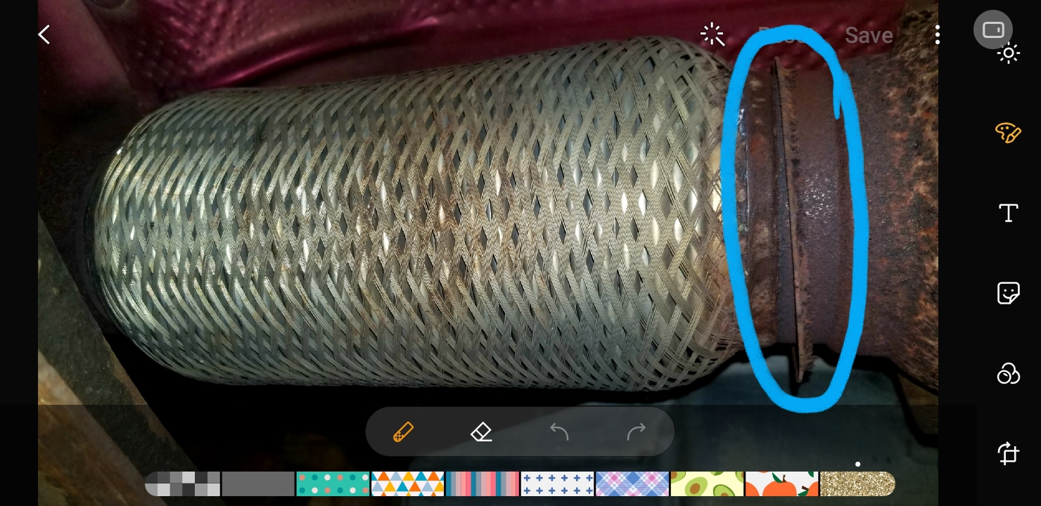

I noticed a metal tinging/rattling today and saw this. What am I looking at here? What I've circled is what is moving around and causing the rattling and looks like it must have been connected to something before.

That is the factory welded flex pipe. Only way to fix it is to weld it again or replace.

If you don't mind the exhaust leak, it won't affect anything. Its post catalyst, so it probably won't stink too bad

You’re going to want to weld this. Don't leave it as is.

Ok, I'll take it into a shop to get a look at it. Is this something for any muffler shop to handle, ie, like midas, meineke, etc or should I look more carefully? What is this section supposed to look like?

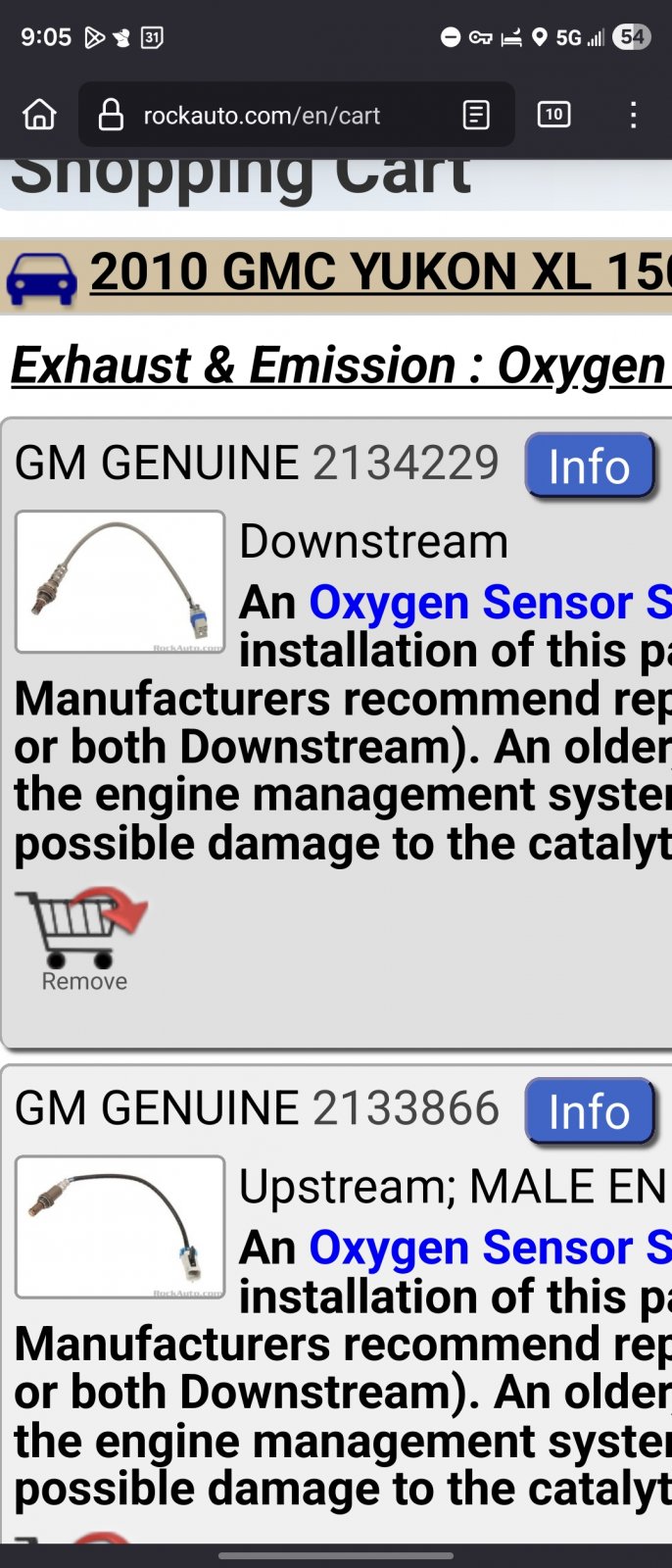

New issue. Had a P0155 code come up. Looks like O2 sensor. Should I do any further diagnostics on this or just replace all of them? I don't recall ever changing these sensors.
Did some research on here to gather some ideas and tips. Saw @Doubeleive mention O2 sensor socket and/or crows foot. Also saw putting some penetrating oil on them. Any other advice on these as I give them a shot?
Are these right - 2 each?

Penetrating oil and a good ratchet. Having an O2 sensor socket or wrench (I have both - one socket and a flex head O2 wrench are both made by snap-on. The other O2 socket is an Ares, similar to what you can rent at any auto parts store.
Do make your purchase from Rock Auto versus Amazon. Several knock-offs have come from the latter. Not everybody, but there are enough to make you question buying them on Amazon.

Yeah any muffler shop will do. Doesn’t have to be one of the big name muffler shops. If you have a local reputable Auto repair or exhaust shop, I’m sure they can knock it out for you.

02 socket should work, the trick I found is using a flexible head ratchet makes the job a lot easier. Also if those sensors are any cheaper from denso just get those, OEM are made by denso, sometimes the OEM is cheaper anyway, when they arrive look at them for the manufacturer stamp, bet money there denso
